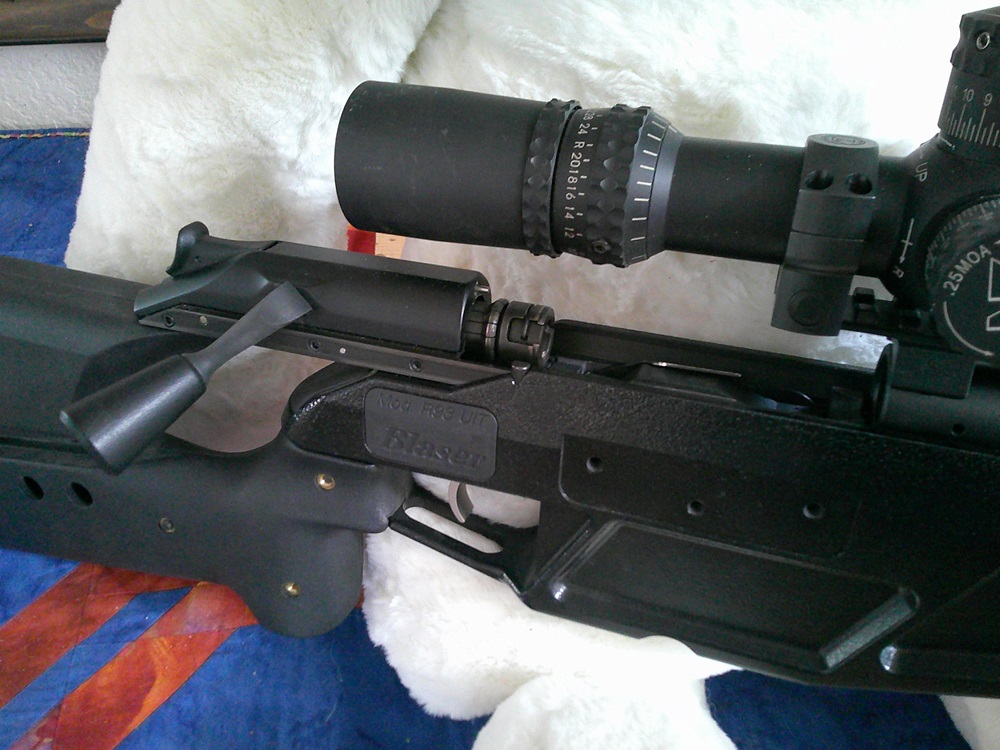

The Blaser R93 is a straight-pull action precision rifle offered in a multitude of calibers and barrel lengths manufactured by the German firearms manufacturer Blaser. Designed by Blasers' designer Mr. Meinhard Zeh in 1993, it had a number of features rare on modern hunting rifles, including a manual cocking system and a proprietary Blaser saddle scope mount[ for mounting the optic directly to the quick-change barrel.
The Blaser R93 is a truly modular system built around an aluminum alloy frame, offering differing stocks and barrels varying length and thickness available in chamberings from .22 LR to .375 H&H Magnum/.416 Remington Magnum/.458 Winchester Magnum size.
The barrel has a quick-change design which lets the user switch barrels using two screws and a hex key. Different bolt heads for different groups of calibers and magazine inserts are also user changeable, making the Blaser R93 a modular firearm capable of using a multitude of calibers in its chassis.
The rifle has a shorter overall length compared to more traditional designs due to the trigger being placed under the magazine. The rifle also has a reputation for being easy to disassemble and reassemble which can be an advantage when doing maintenance or during travelling, and has a reputation for having a repeatable zero upon reassembly. The Blaser R93 Tactical is a German bolt action sniper rifle, based on the Blaser R93 design. It has as variants the Blaser LRS 2 and Tactical 2. It is used by German and Dutch police forces as well as the Australian military and special police units. The rifles were manufactured by the German firearms manufacturer Blaser.

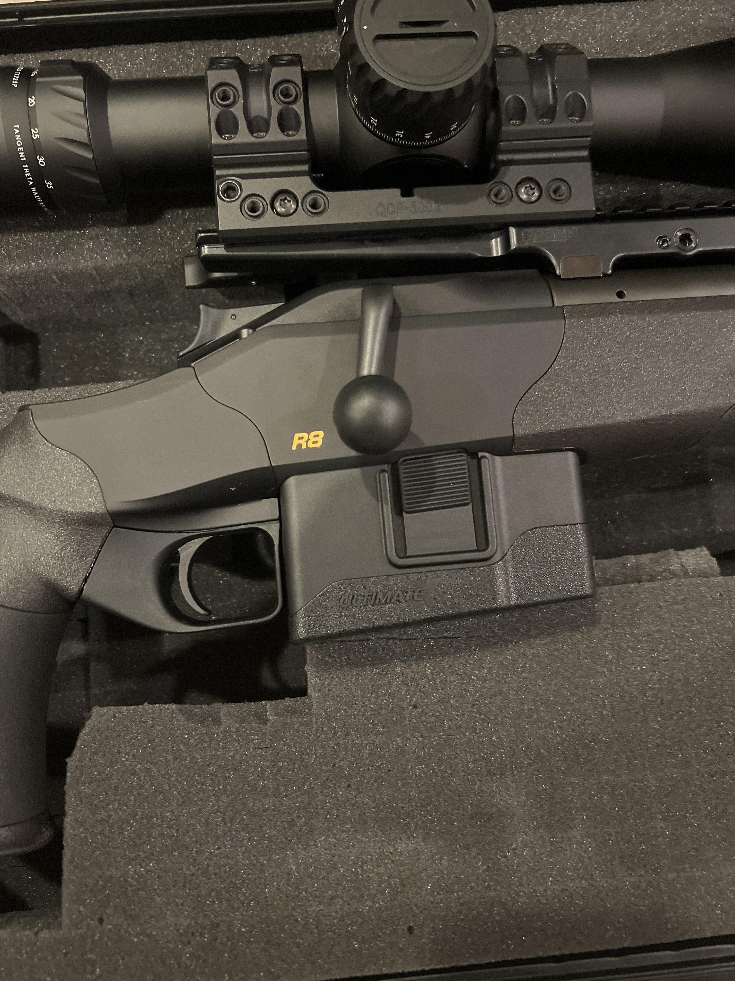

Blaser R8 Ultimate X

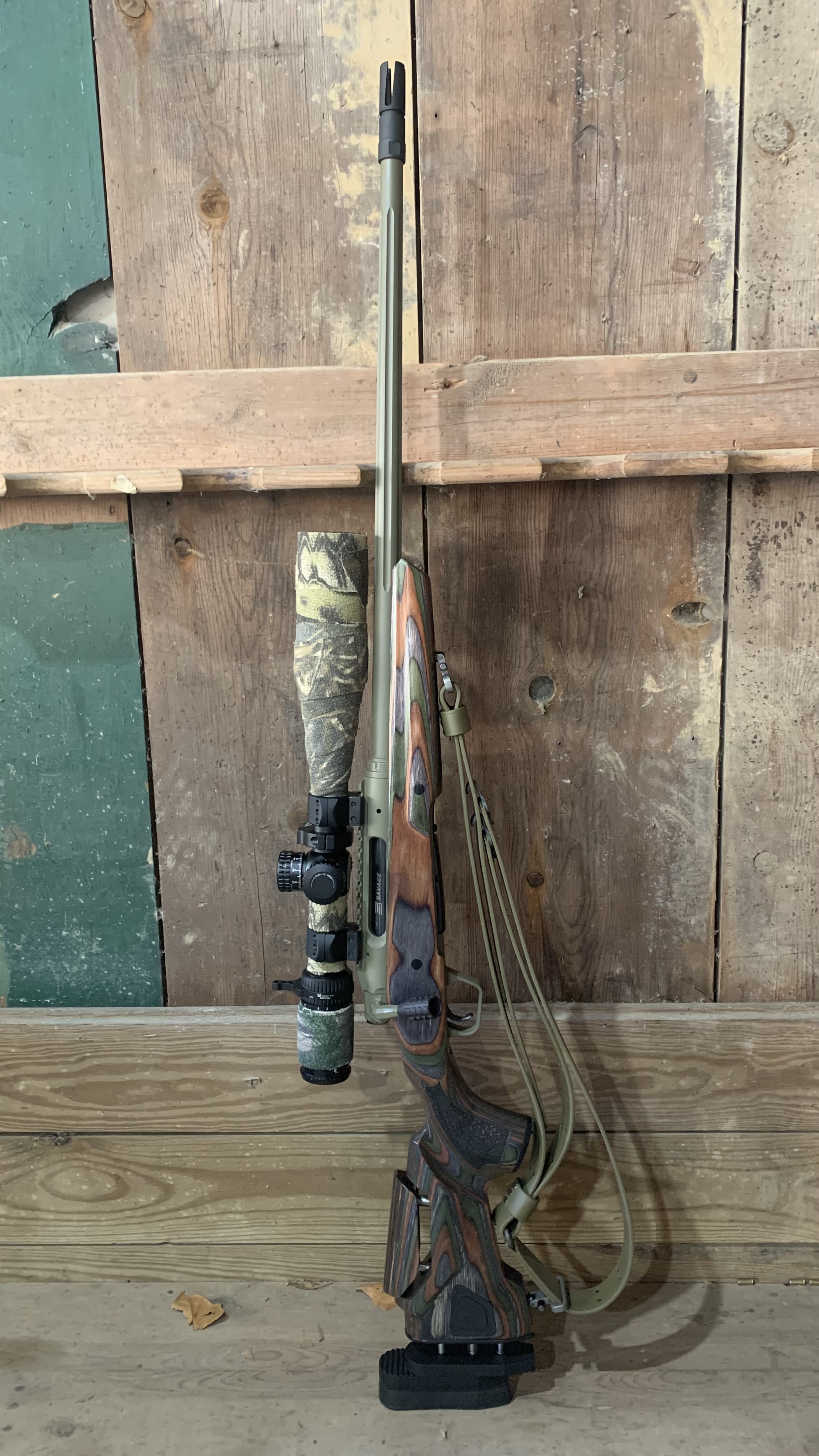

I have Blaser's and two custom Savage Impulse Predator rifles that are my primary and backup predator rig's.
Never heard of any bolt issues with the Impulse rifles.
Both of my Impulse rifles have never skipped a beat and while not as smooth cycling as my Blaser's, both are plenty smooth and I've had no issues with them after thousands of rounds fired in several calibers in harsh field conditions.
The only drawback with the Impulse is that only one stock maker has stocks for them.
That might change in the future.
SJC
Here's that Predator in action.

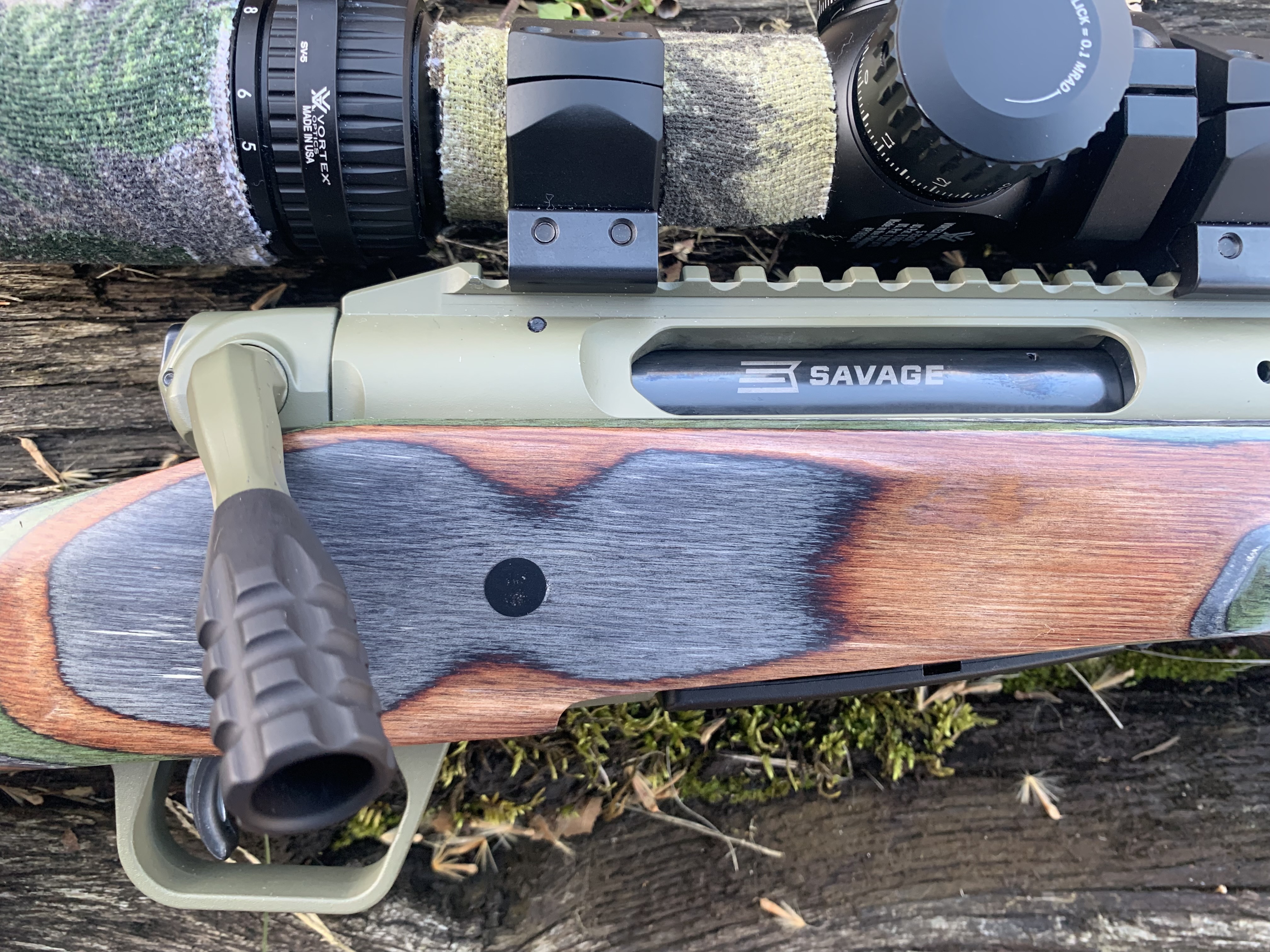

My only criticism for my Savage Impulse, in 6.5CM, was the OEM stock. So I replaced it with a Boyd's stock. An aluminum chassis would have been preferred but not available. So I settled for the Boyd's with a few upgrades.
It doesn't like bipods but that is more of a stock issue rather than for the barreled action itself. It's very accurate when shooting off bags.
I hate the accu-trigger. It would be nice if Timney or Triggertech made one. Regardless of that, I have got use to it.
The one thing that aids in the speed of manipulating the bolt is the extended bolt handle as shown in the photo below.

To be more clear, the gun came in a single box of many other boxes containing the parts, so I had to put it together.
Getting this vibe from that trigger guard…
Just giving you a little crap. Grip-to-trigger distance looks great, however.
Besides that R8, my AI, a KMW, McMillian U7/U10, and maybe a couple of Foundation stocks are the only other ones that I know of that have a shorter than typical grip-to-trigger distance.
