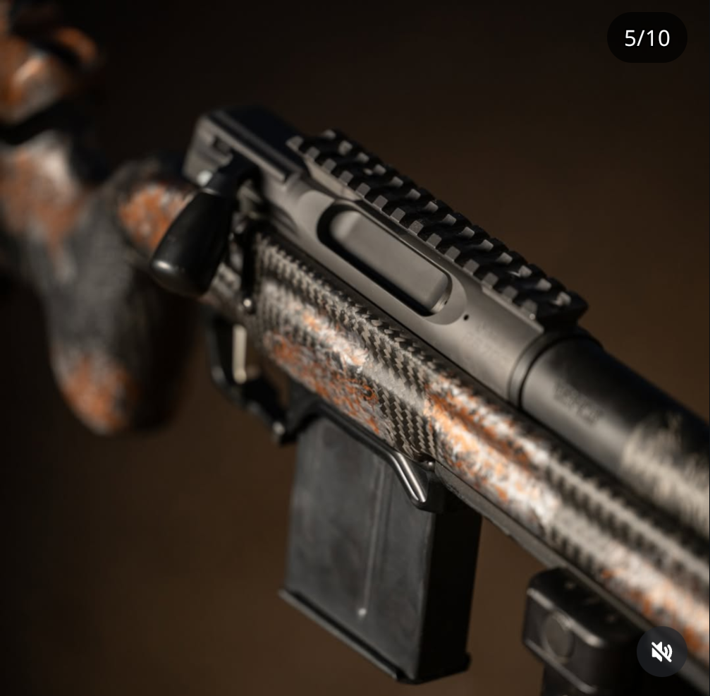

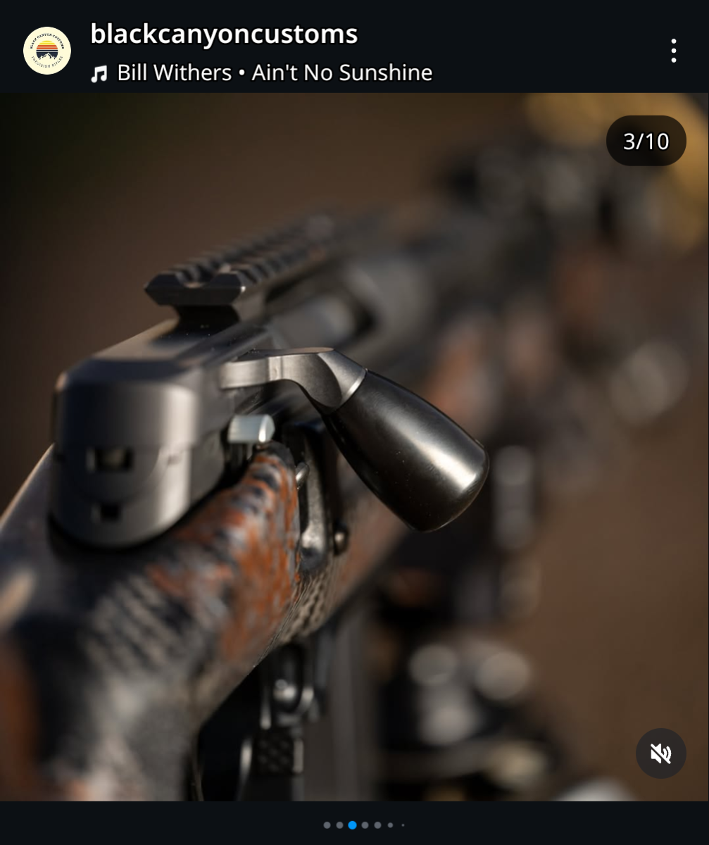

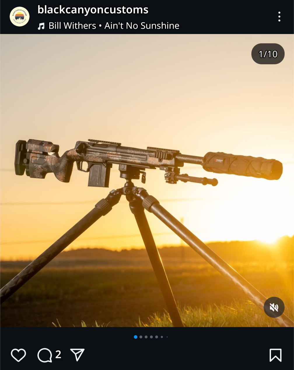

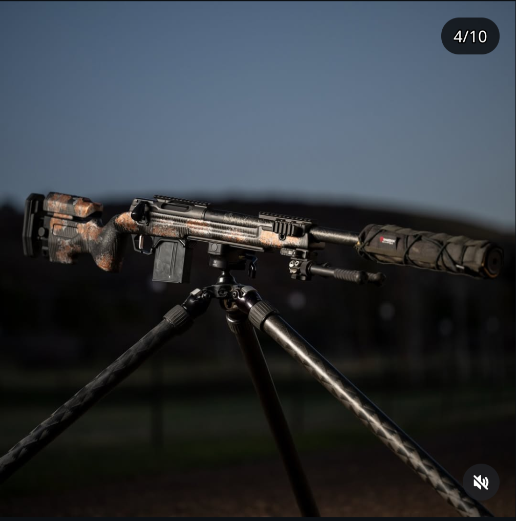

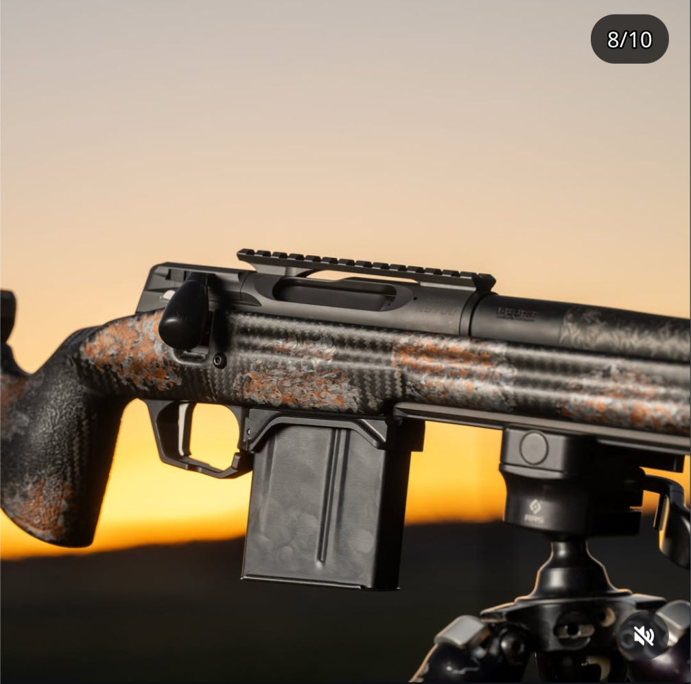

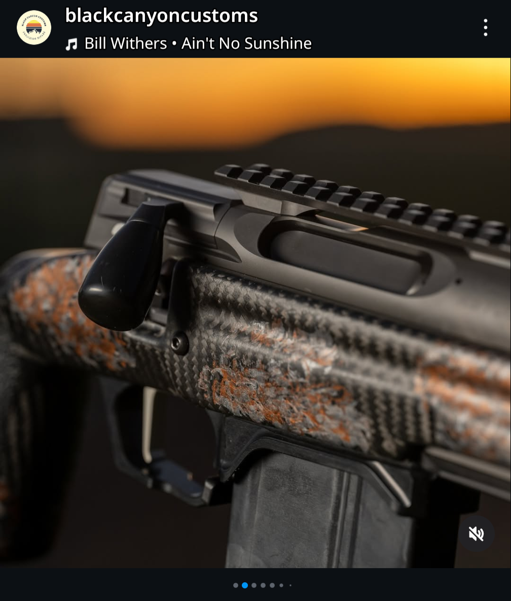

I'm building my son a custom .308 for his college graduation this year and went with the Strasser 700 footprint left hand action. Manners stock, 20" barrel. It should be done in a few months when he graduates. We cannot wait. I may have to get one built for myself.

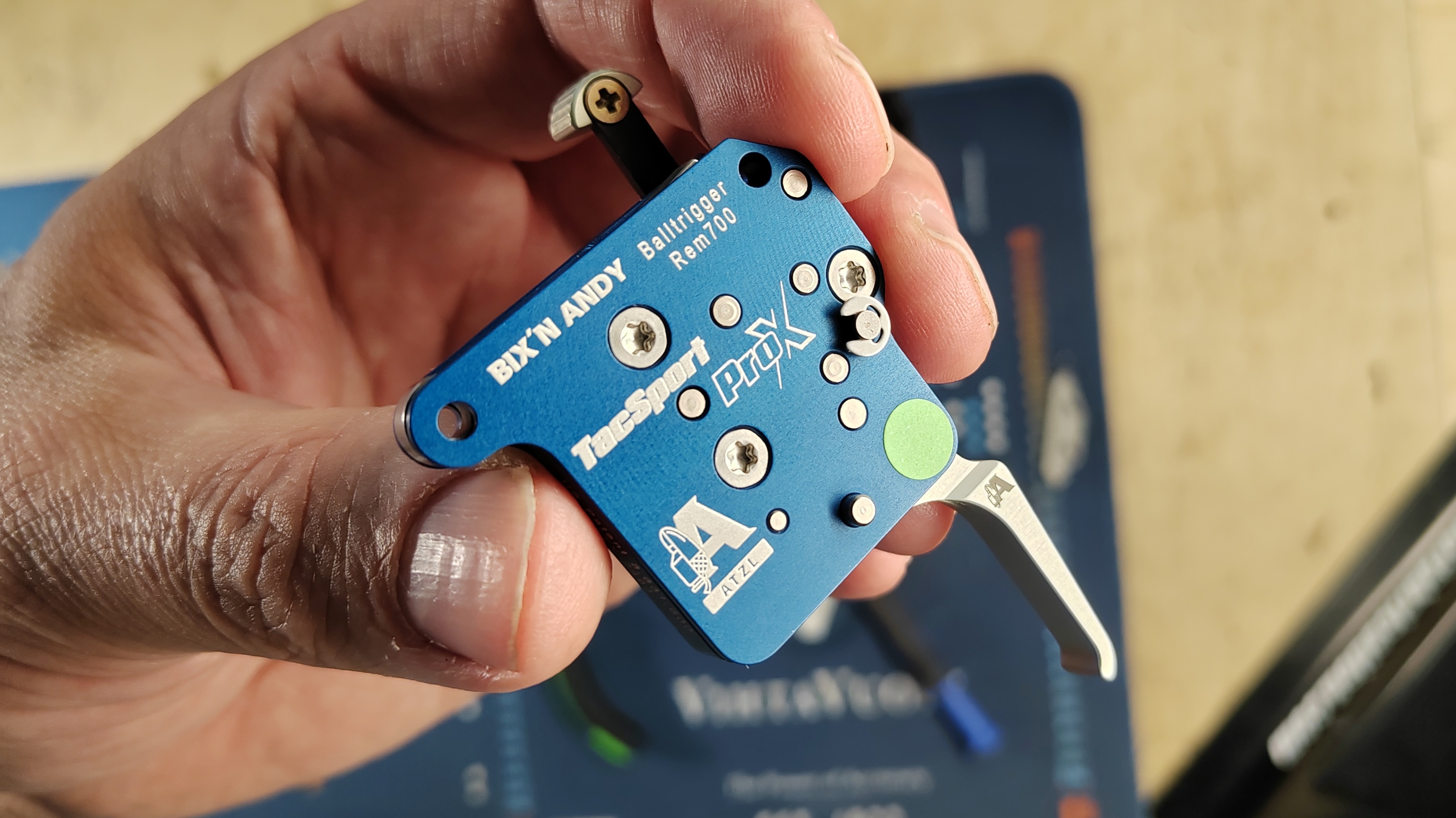

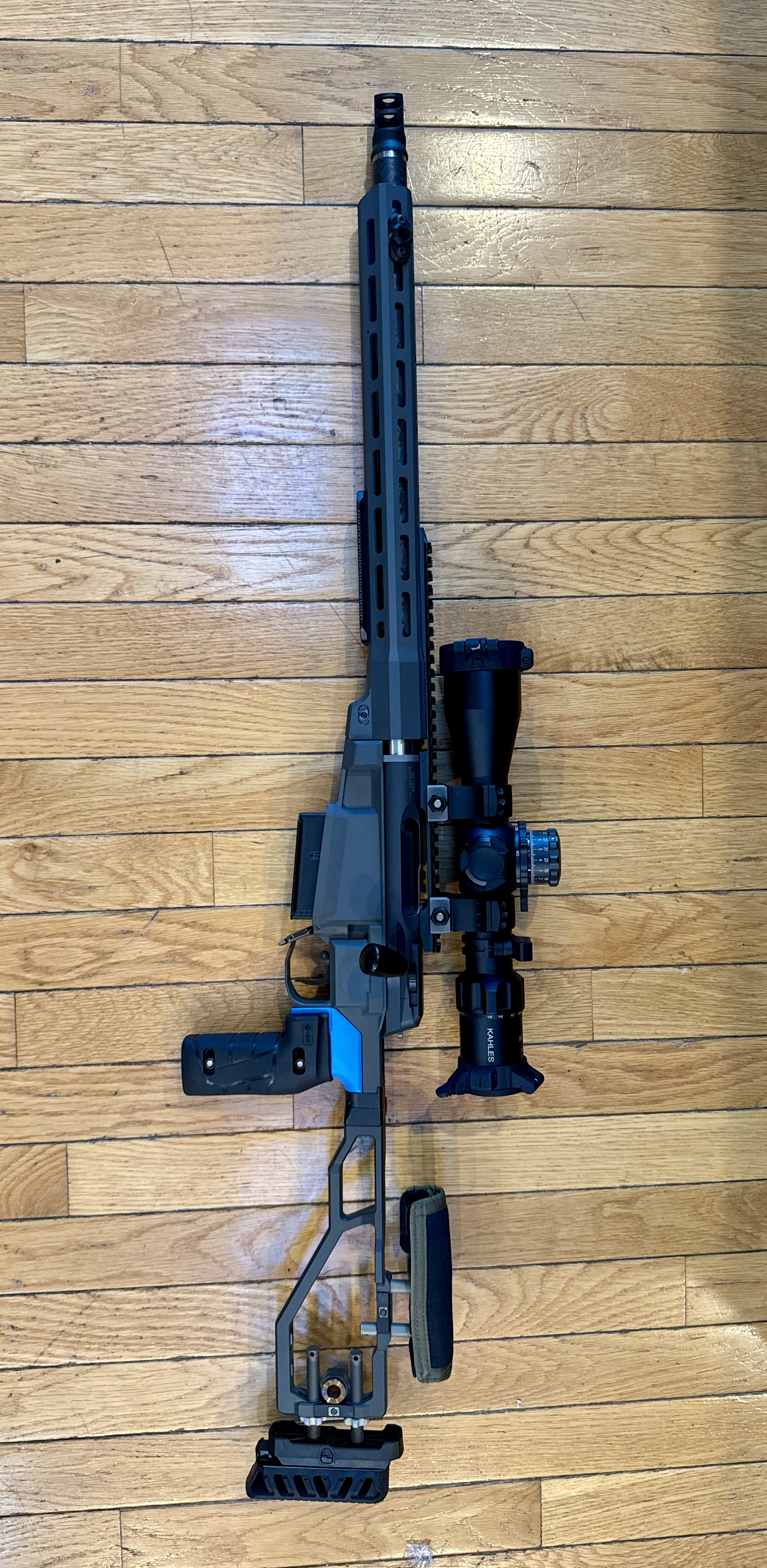

I have a lefty RS700 as well. Starting with 18" Proof CF 308, 20-22" 6BRA, and 6.5 SST barrels. /going in a Q Sidechick milled for the lefty with a Huber 2 stage bottom safety trigger for mid range hunting, and either a Xylo or a Manners Nightstalker for other things.

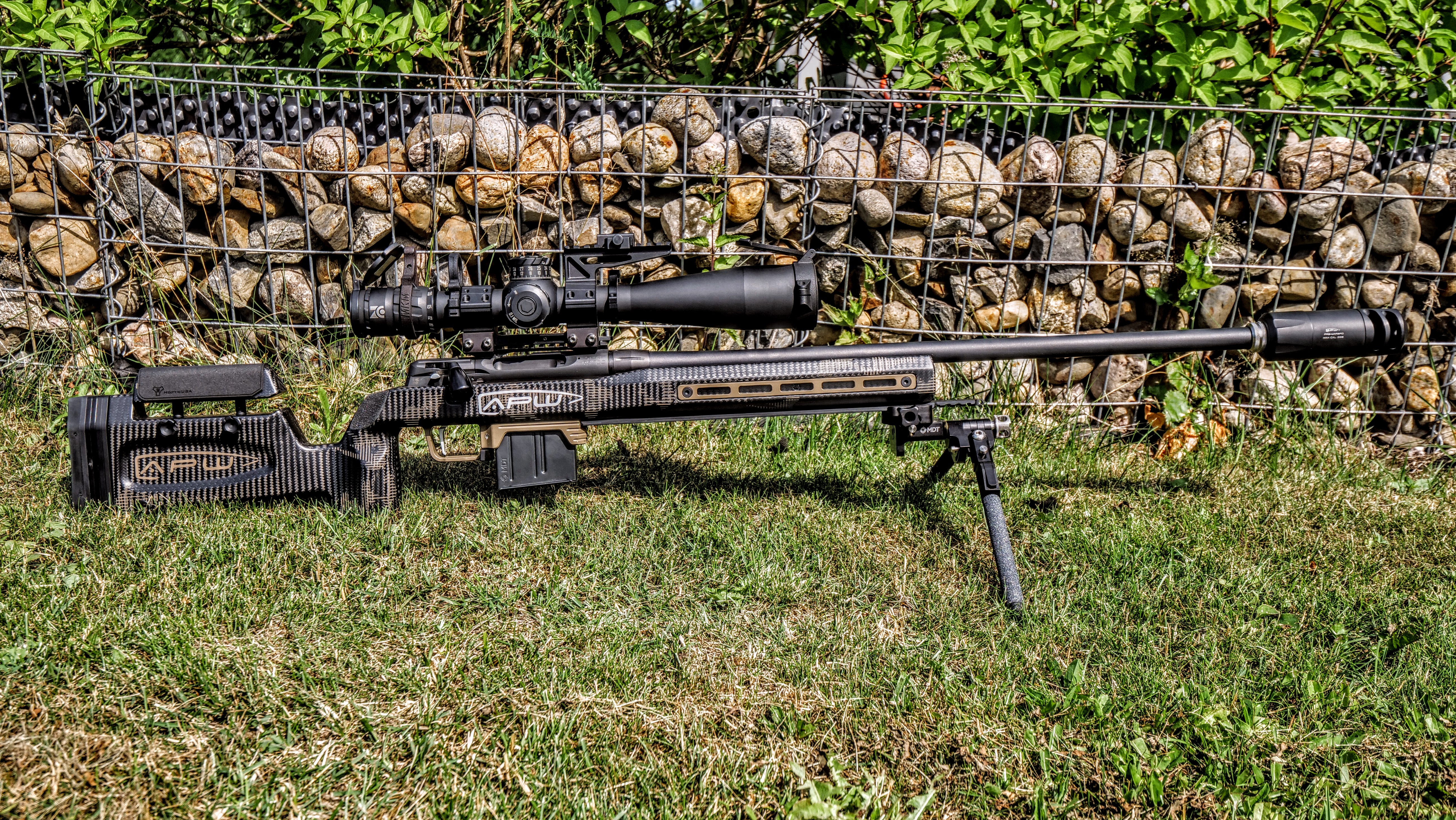

I am having a Strasser RS 700 in this month, and it has a factory (Lothar Walther barrel) and i can say that these do shoot very well.
I did tested the new Lapua MaxRange Target 144gr pills last week, and it does shoot 0.22 MOA and 0.2 MOA with 4 shot´s, but the fifth
it did not hold on the same group, might be a shooter that did the pull, dont know, but what i look the the rifle, i would say that
it might do better with a shouldered barrel.
Will see when i get my rifle and Carbon X stock in to it.
