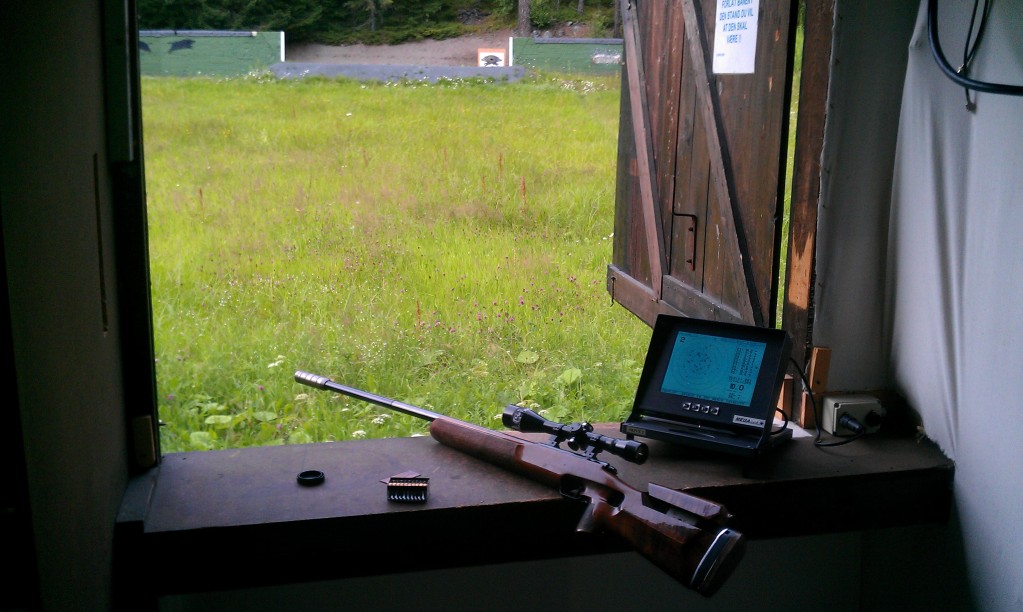

    My rifle and range:
    And here's my buddy shooting the first Olympic moving target event: 100m Running Deer Doubles:
    Rifle is Husqvarna 1900 Sporter, 222rem. Lead is app 20moa.

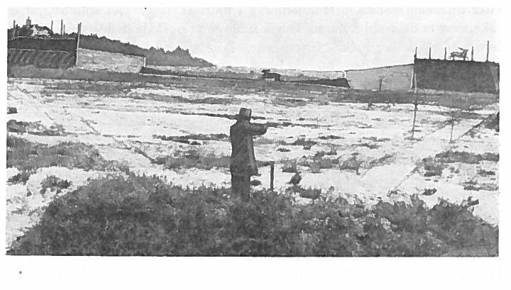

    Running Deer at the 1920 Olympics Antwerpen:
