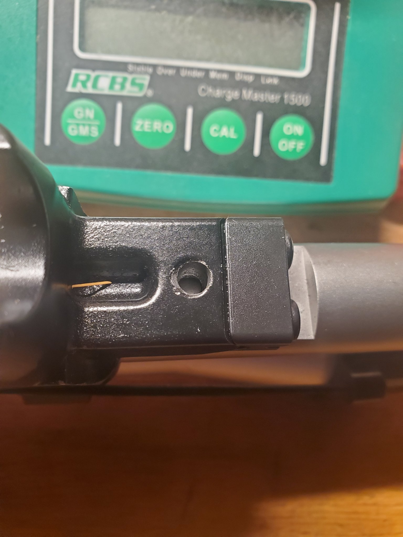

A close family member of mine has a Ruger 10/22 that they put a Kidd barrel on and a KRG Bravo on (at my suggestion). I don't know why, but they clean it after every range trip (maybe 50 rounds when they go). I don't know what happened but they stripped out the action screw in the receiver... before they buy another receiver, is this one salvageable?
It seems to me the best option is to ream this out and tap it for the next size up, but I realize that would change the torque value needed when installing it in the Bravo. Does anyone know how to compute the new torque value needed? Also, what is the recommended torque value that KRG suggests? I don't own a 10/22 and this family member has lost the documentation.
They asked me about using a Helicoil, but I didn't think that was a great idea as this 10/22 is used for "precision" and didn't think a Helicoil was the best option for that.
Anyone have any thoughts on it before he buys another receiver?
I honestly think the best option is to buy another receiver and use that with the Kidd barrel and Bravo chassis, then tap this receiver out for the next size up, slap the factory barrel and stock on it and have a 2nd rifle (10/22 in stock form).
Here is a picture of the stripped out hole...

If it was me, I’d just get a new receiver. I’d probably use it as an excuse to get a Kidd receiver for $240, but he could also get the Brownells receiver for $130.
He's too cheap for a Kidd receiver (my suggestion). I found a factory receiver he can but for $80, he said he'll probably buy it next weekend, I'm just wondering if salvaging this for his rifle is worth while.
Check at your local hardware store, Lowes, Grainger and see if they have a thing called a " helicoil kit " for that particular size screw and thread. What it amounts to is a drill bit, tap and a few coils that look like twisted wire and a tool to insert them after you retap the hole.
Probably cost about half the price of his reciever to do this.

I mentioned in my first post that I wasn't sure a Helicoil was a great option for this. I've used them before in other applications, but not on a rifle. Would a helicoil, just basically being a spring holding the action screw, introduce any issues between the action and the chassis that might degrade accuracy of the rifle?
The main issue I see is that the stripped action screw hole is between the two barrel clamp screws and that will decide what course of action going forward for any modification.
If there is enough material therei would just go up a size to 5/16-18 or 24.
Yep, my thoughts exactly. Could tap this receiver out to use a 1/4-20 screw, put it in a wood stock, and put the factory barrel in and have a cheap plinker...

Sort of puzzled as to how he stripped an action screw from cleaning the rifle? Hammering a rod thru that was stuck with too large of a patch or....???
He wants a new receiver then that's what he should do but I think the suggestions of drilling/tapping for a larger screw is a good one.

If I had to place a bet on what happened, my money is on cross threaded.

That’s certainly a reasonable speculation as to cause, but the OP said something about it happening when cleaning and I’d be surprised if the pulled the BA out for just routine cleaning. But I may well be wrong about all of this.
That's a valid point, since we are speculating he may have pulled it to remove the barrel to clean from the breach but I'm just guessing at this point.

The receiver can be saved. If your bud doesn’t want to go that route there are those who will turn it into a working model. This sale will offset the cost of a Kidd. PM whoever you want regarding this. There will be buyers. It’s just a 10-22 receiver, but there is enough knowledge here to make it more than work.
When I was at his house he thought he had stripped out the hole in his chassis somehow (but I knew better)... when I looked at I looked at the action screw and all the aluminum from the receiver was in the screw threads. I looked at the receiver and it was smooth inside, threads had been pulled out...

Nope, he doesn't know how to pull the barrel (I previously helped him install the Kidd barrel). He had removed it to "clean the bolt". I suggested he use a snake on the barrel and only pull the bolt if he was starting to have reliability issues.

I offered a couple times the drill and tap the hole for a larger screw, he doesn't want that and wants will be buying a new receiver... it's his money, not mine.
The ol’ “tighten it down until you hear a pop, then back off a quarter turn” method of torquing a screw…
I think the issue may have been him using a torque wrench. He claims to have tightened it to 18 inch pounds, but I think the torque wrench was either misadjusted (user error), or he tried 18 foot pounds (also user error).
Once you torque the bolt in the helicoil, it will be rock solid. I doubt it would affect accuracy at all.
