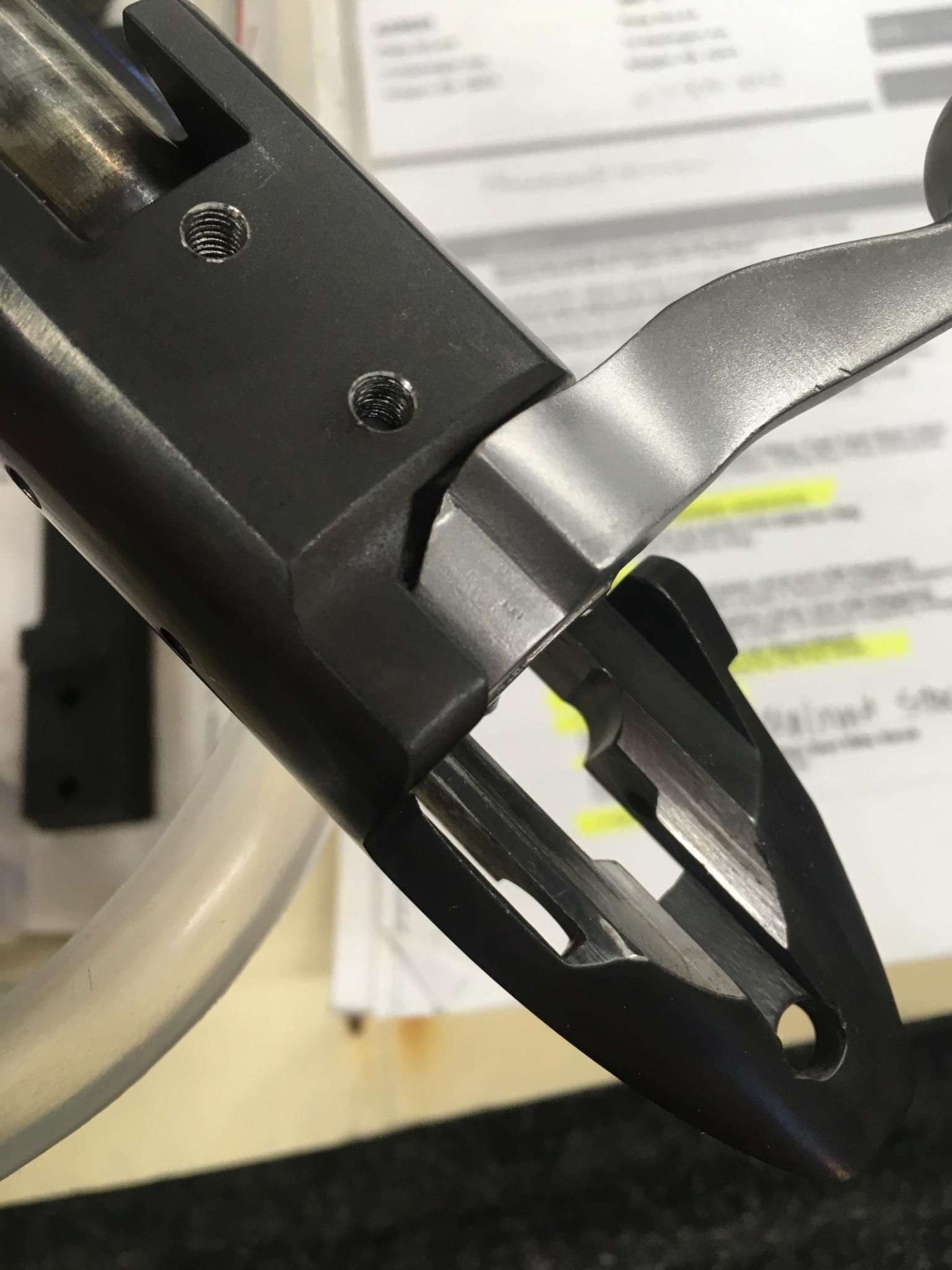

This is my 5 digit receiver at LRI right now. This receiver has the simplified Remington square cut stripper clip.....
This is the receiver after LRI relieved the rear deck and cut the nose relief for the front lug.....
If you get your receiver cut for stripper clips you will need to make the front round cut to allow the tips of the bullets to push in.

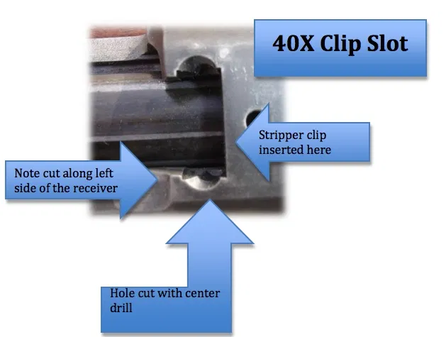

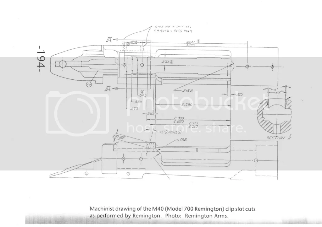

This is a picture of the more complex/detailed M40 style stripper clip cut......
