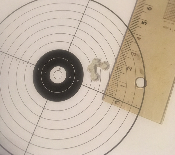

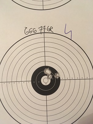

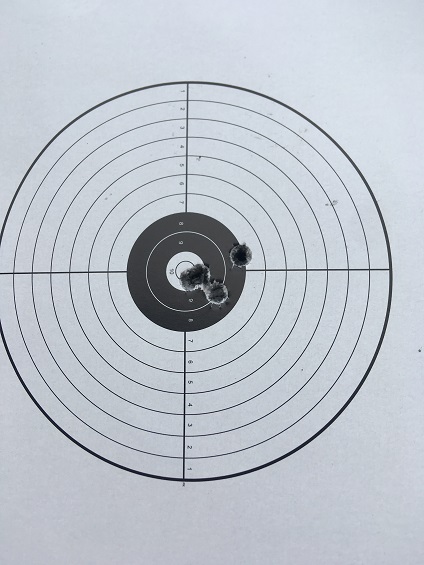

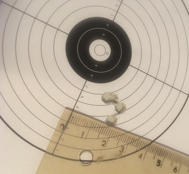

1. Today a buddy of mine shot the rifle- see the targets below. We tried Hornady Match ELD 73gr, Hornady Black 75 gr and GGG SMK 77GR.
2. It seems that the gas block does touch the bottom of the handguard (in fact the piccatiny rail attached to it).

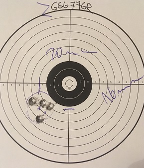

The rifle was disassembled and reassembled by the gunsmith. I was shooting at 100 yrds using 77gr SMKs. A group of 5 shots was within 1 MOA. Hallelujah.
The pitfalls of these slim rails. With some, you can grind down the MLOK screw so it won't hit, even with barrel whip. Others you will need to move which dependent on weapon set up is a pain. While not desirable, you can use a longer rail to have whatever accessory attached where you need it and not have an issue with GB contact.
NICE! so what did he do or move, that made the diff?
1. unscrew the barrel
2. cut off the part of the handguard which was touching the gasblock
3. Polished the receiver (the thread) with the lapping tool.
4. Put Loctite on the barrel before reinstalling it
5. Torqued the barrel nut according to the specs.
6. Polished the trigger.
7. checked the scope mount.
