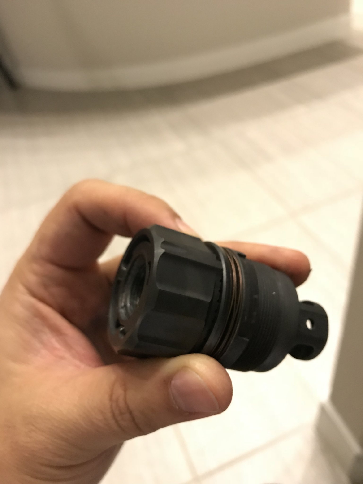

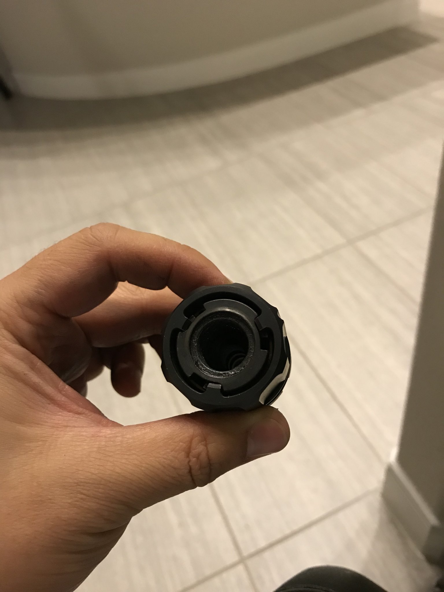

So I guess my torque on the muzzle brake wasn’t sufficient enough so after my most recent range day my sico omega and the dead air adapter were stuck on the dead air brake. Fortunately I was able to get the omega off but am now not able to get the brake off the adapter mount. Anyone encounter this and have some advice for me? Thanks in advance guys!

Did you not use a torque wrench and rockset?
Clamp the muzzle device in a bench vise and then use a padded pair of pliers to turn the collar. Reinstall with rockset and the proper torque.
