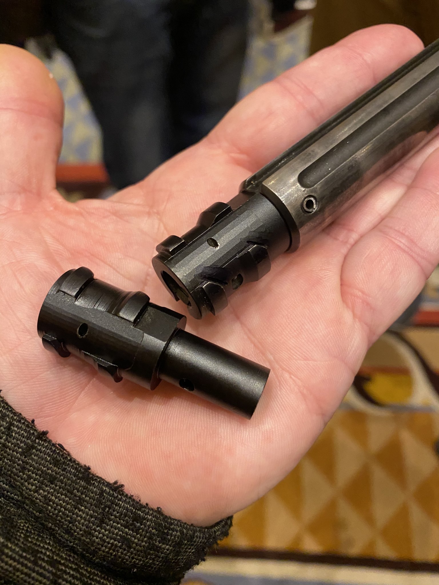

    So read about a known member having factory hornady ammo stick bad enough in a AI on a hot day at a match that he broke the bolt head trying to open it / free it up.
    Unscrewing the barrel would be the way to go if you run into that problem correct ?
    Broke the bolt head? I'm having a tough time picturing that. Extractor maybe?
    6 CM?
    I watched 2 guys from **** *****stick their bolts in a team match shooting that shit. It was 100° but one sheared the bolt head off trying to get it open hith his foot.

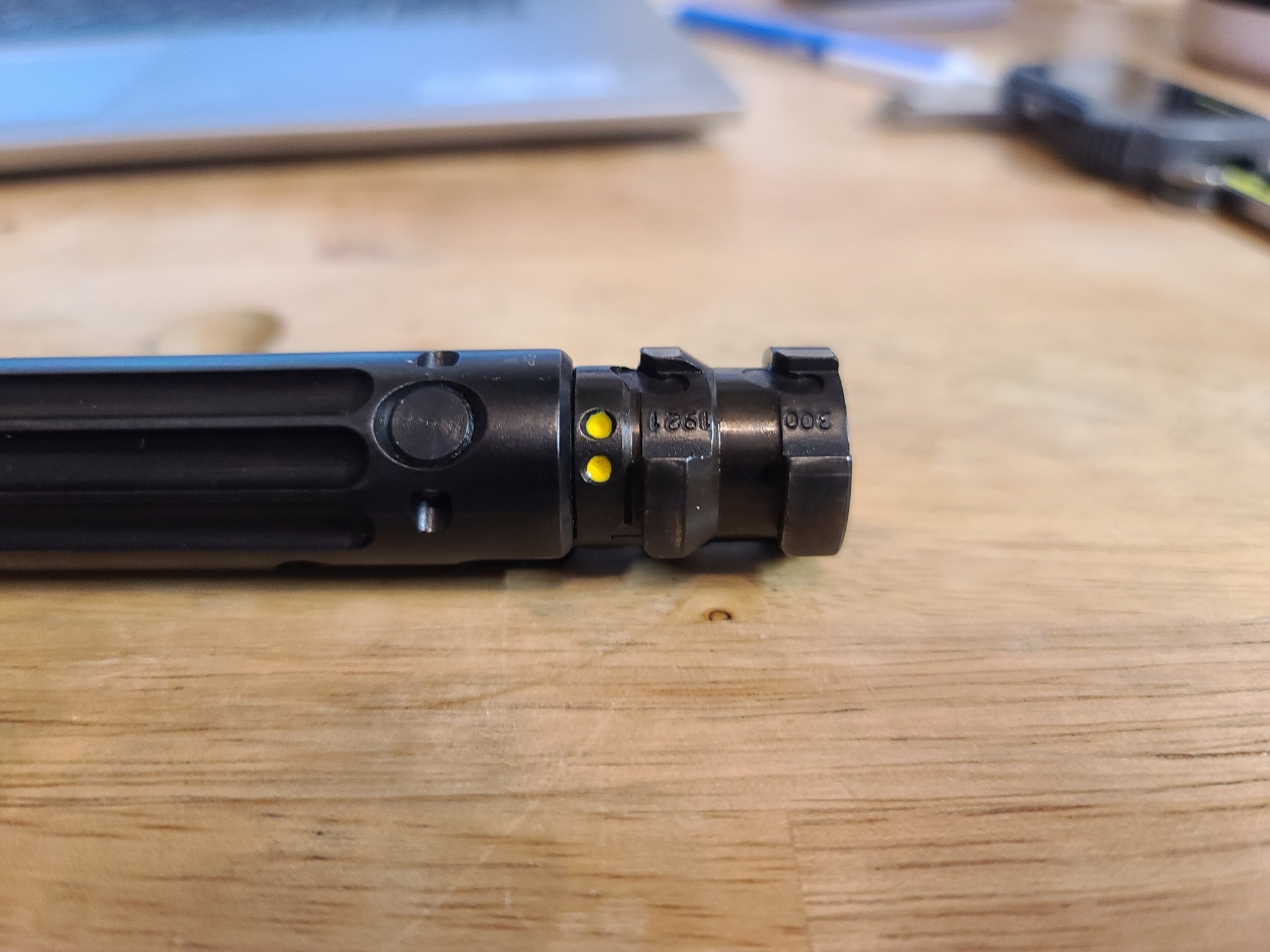

    It's roll pinned for sure
    Reactions: BurtG
    @trophyhunter are the bolt heads epoxyied on as well?
    Can do both, with or without
    The pins are what hold the head in, and tight fit. Once the pins are weak, they can shear or walk out, letting the head come off.
    I’ve had bolts that by simply removing the pins, the epoxy is worn enough that the head comes right off. I’ve had others that I need to get a jig and press the head off.
    Reactions: BurtG
