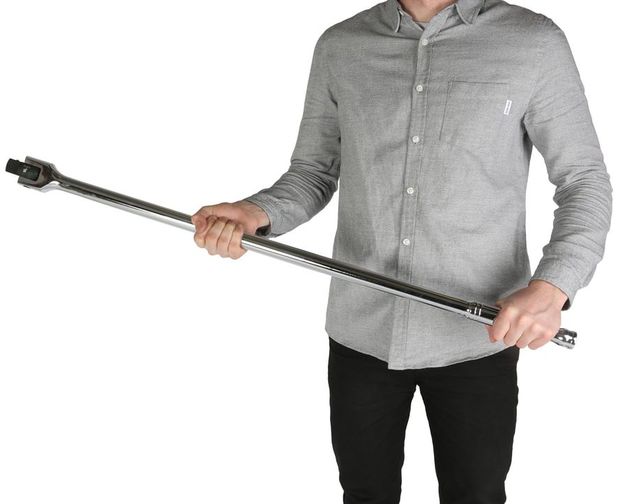

Hell, 15 years ago, a buddy of mine wanted me to help him drag an old outboard motor through the woods, load it up, and take it back to his house. That motor was frozen solid. Been there outside on that boat that was sitting on the ground for like 30 years untouched. We got it mounted on a make-shift 2x4 motor stand, and we pulled the cowl off the top, pulled the plugs, and I sprayed Kroil in each cylinder all the way to the top, then put the plugs back in to keep debris out. Let it sit for 24 hours, Kroil had drained down into the crankcase. Filled them up again, and repeated this for 3 days. Then went back over there with a big ass breaker-bar and an impact socket and 1 good pull with some serious effort broke everything loose. Not only did the Kroil dissolve most of the rust, but it also unlocked all the rings, saved the crosshatching in the cylinder walls, and tested with proper compression. We rebuilt the carbs and put fresh oil and gas in it, and it ran perfect! That made me a believer in the power of Kroil, and I've believed in it every since. 👍🏼
