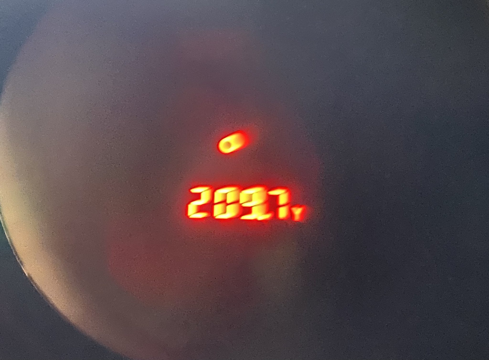

Couldn't see the forest for the trees. Or more accurately so focused on tiny numbers and minutia like 2.00" sight height vs 1.93", 2800fps vs 2775fps, I was looking down when I should have been looking up.
It hit me at work yesterday, I suddenly remembered a couple years ago lasing the range and finding the target boards a yard or two too far away. Well apparently over time, every time they replaced the posts or take them down to get machines in to do berm repair, they migrate farther and farther. Noticeably so at this point.
Everything is exactly as it should be… except for the target boards that is.
