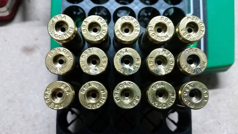

    You wont get swipe with gas off. Do you see a round indentation from the ejector hole? That would be a swipe had the bolt rotated with the slightest amount of pressure.
    The gas system can have an effect on the swipe as a mechanic of exctraction but not seeing how it can cause over pressure issues. Thats likely a chamber load thing. Fyi, swipe can be normal even on mild loads and with factory ammo. You can soften the edges of your ejector hole if its a problem.

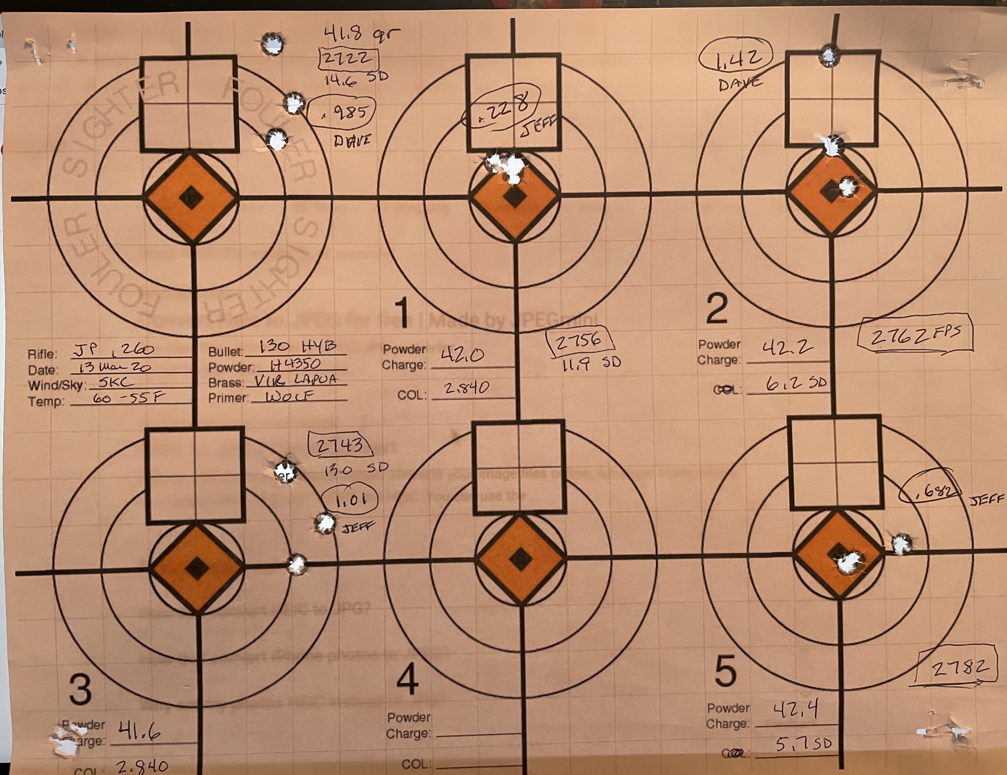

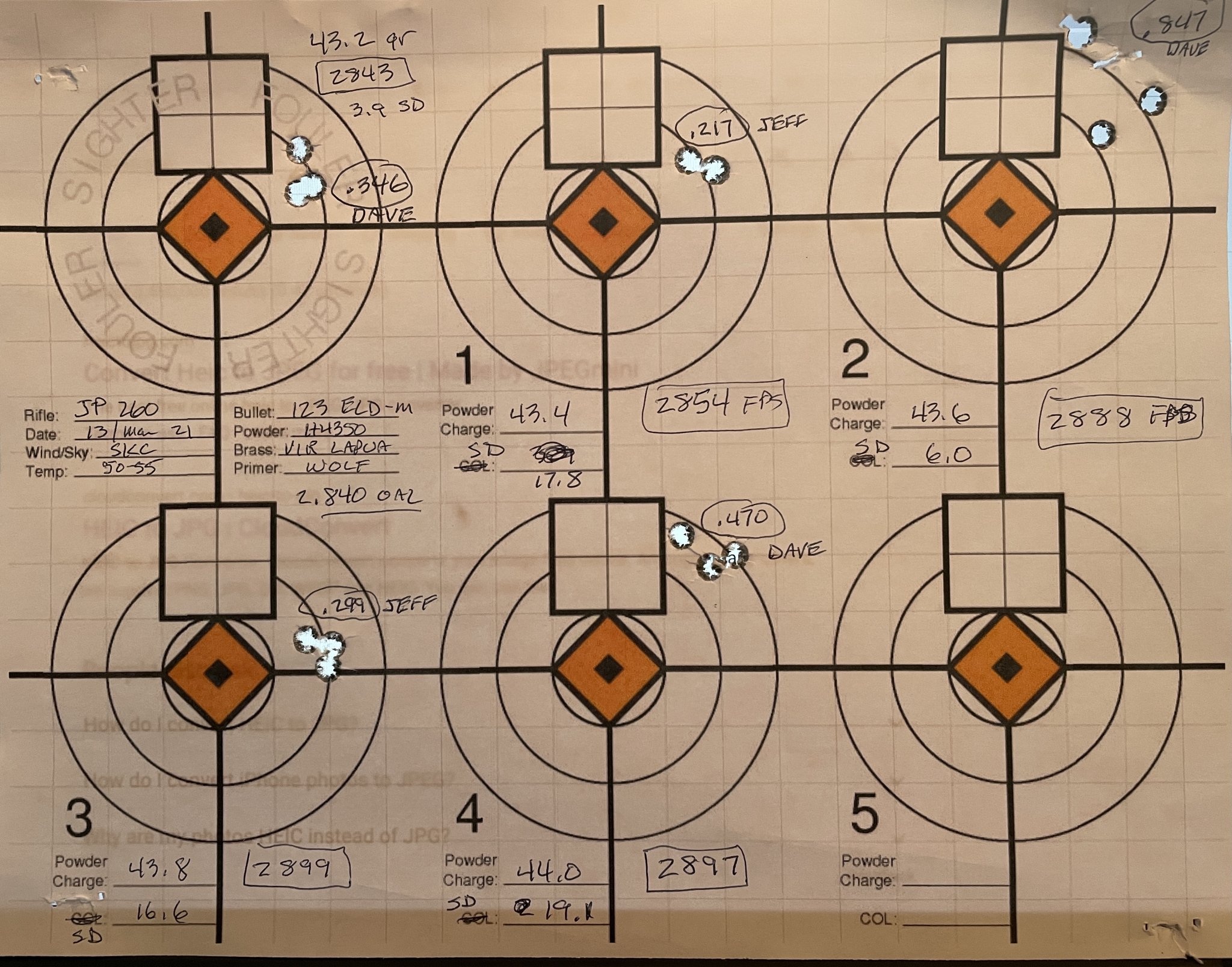

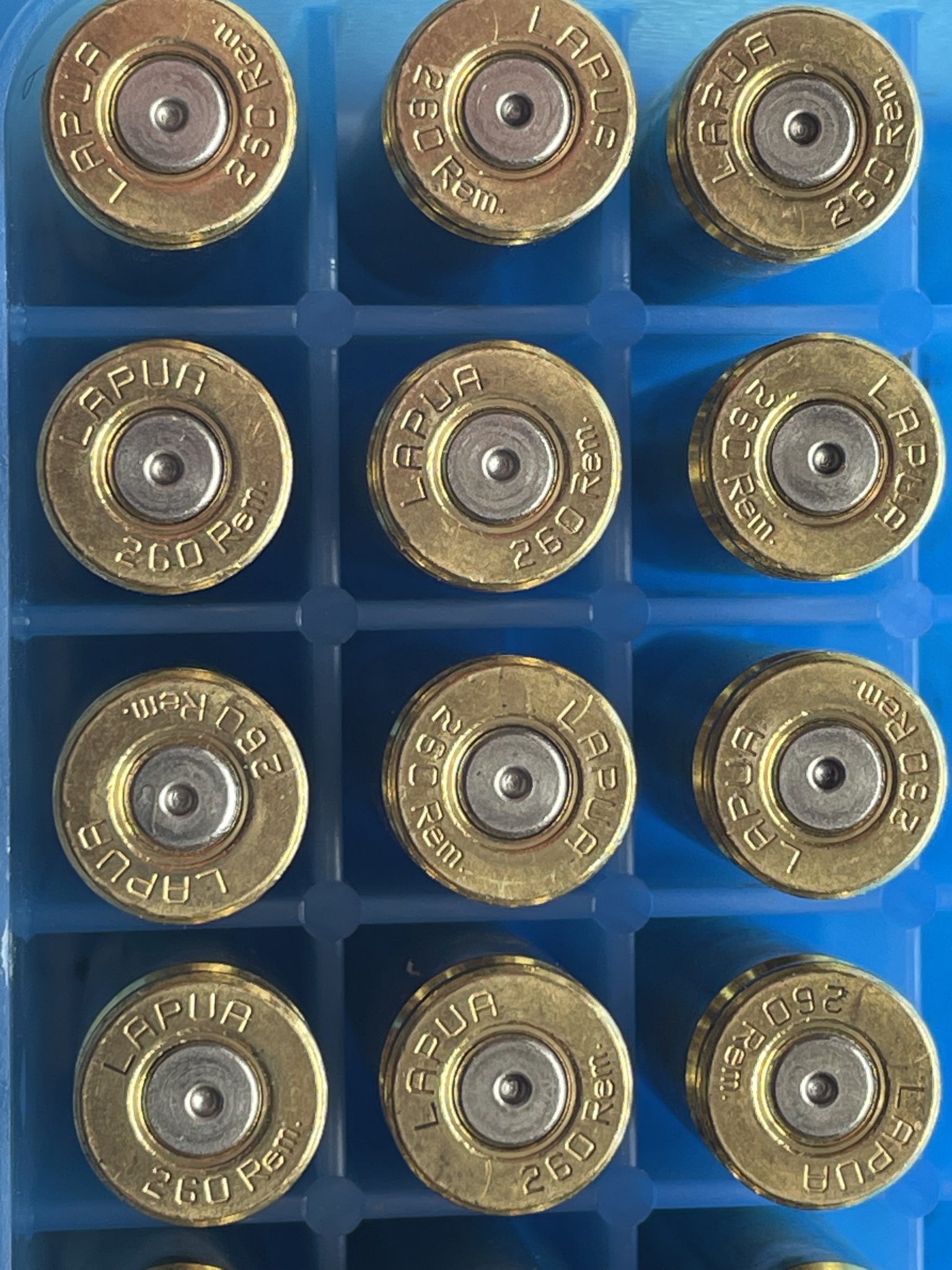

    OK, here are the pics as promised. Gun is a newly assembled JP 22" Supermatch .260 barrel with matching JP HP bolt, JP AGB, +2 XXL length gas system, VMOS carrier and SCS H2 weight.
    This first set was with the gas system ON, unsuppressed. These are Lapua .243 cases necked up to .260, fired about 5x. Loads were a ladder of H4350 / 123 ELD-M / steps of 43.4 to 44.6. MV range 2965-3040 fps. No primer because I had already tumbled them in SS media the couple days before. But primers were also fairly flat. Not gross, but flat. When I shot some of these loads with the TBAC can on, it was even worse on swipe and flat primers. On the brass below, you can definitely see some of the ejector plunger (I assume) marks. There was some swipe as well, but the SS media seemed to have polished that off nicely.
    The next pics below are with the gas turned off after the first two strings. The first one is Virgin Lapua / H4350 / 130 Berger AR Hybrid / 41-6-42.4gr / MV 2743 to 2785.
    The one below is Virgin Lapua / H4350 / 123 ELD-M / steps of 43.2 to 44.0 / MV 2843-2900. Again not super flat primers.
    These ^^ are Wolf LRP primers, BTW if that makes any difference.
    It didn't shoot poorly either.
    View attachment 7581368View attachment 7581369
    For comparison, I'm shooting 43.2 of H4350 behind a 140 Berger Hybrid @ 2910 fps in a Bolt gun and don't get anywhere near these sorts of pressure signs or flattened primers.
    Bottom line is I don't think the gas gun indications are OVERLY excessive (yet) and I'm planning on trying to find one more node above these, as the speeds seem a lot slower than I would have imagined I'd get. But the pressure signs appearing at such low charge weights seems concerning and wondered if that the way ALL gas guns are or if something is improperly set up on mine.
    Your firing at near max load with the 123s and 130s and over max in your bolt gun with 140s...
    If you have a tight bore in your gas gun, you will see pressure before hitting max loads.
    When you necked up the 243 brass, was this time it's fireforming or did you do that in a previous fireforming?

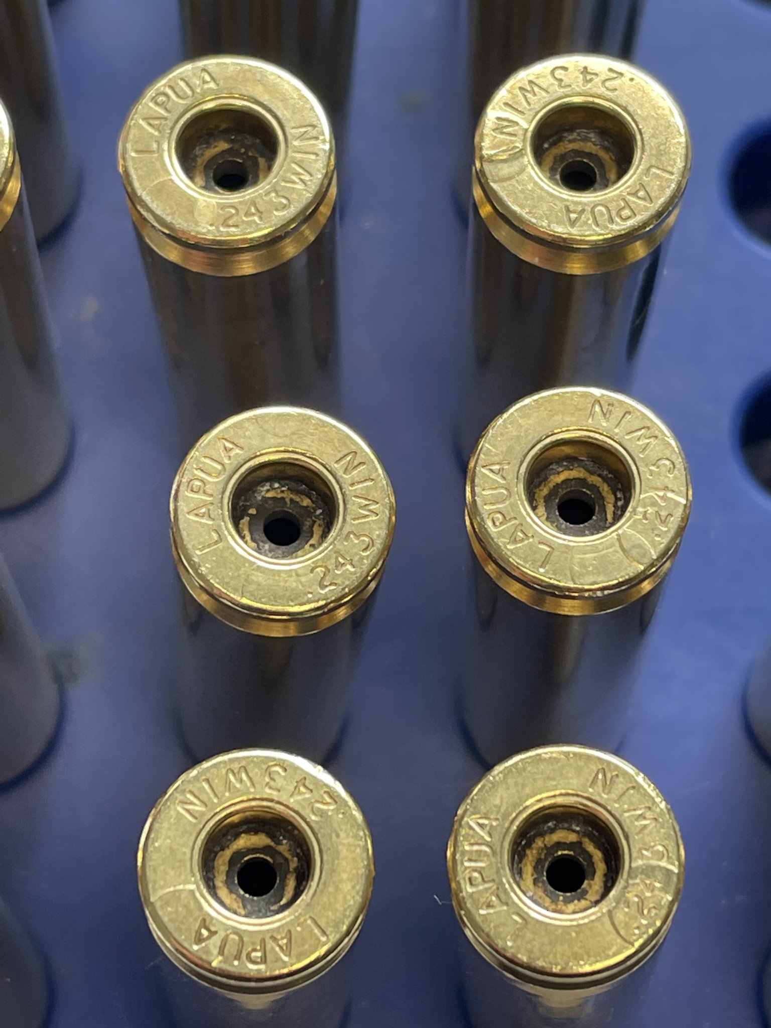

    Center row is what bad swipes look like. I didn't lose any primers but had to use a swiss file to knock some of the burr down so I could get a decent sizing out of it. This was 1x fired brass loaded with 140 SMKs fired from the 20" GAP10 G2 and the can was an OpsInc 3rd Model.
    Top-to-bottom rows:
    42.6gr H4350 - avg. vel = 2685fps - no suppressor
    42.4gr H4350 - avg. vel = 2688fps - suppressed (I rotated the raised ejector marks that I filed down to the 6 o'clock)
    42.8gr H4350 - avg. vel = 2701fps - no suppressor
    Ok, copy on the near max loads. I'm not disputing it, but curious what source data you're using for max. I find much of the published stuff like from Hogden to be very conservative. If my 123 and 130 loads are just about at Max, then I'll stop here with a couple of the promising nodes and do a final seating test and call it good. I just expected to get a bit more velocity out of them before it hit the top end.
    The necked up .243 brass was previously fireformed, but in the AI bolt gun and then FL resized and shoulder bumped down to the gas gun's chamber specs. The gas gun headspace is about 3 thou under the bolt gun. I know that's not ideal to mix brass, but I didn't have any fireformed brass for the new gas gun and wanted to get some initial data points/starting loads before beating up my box of virgin lapua. The good news is the whole box of virgin Lapua is now fireformed to this new chamber and will be dedicated to only being used in this rifle.
    Oh and sorry, I'm dyslexic today. Meant the Bolt gun load was 42.3 H4350. NOT 43.2.
    Top-to-bottom rows:

    So... I went out and tested that today. Shot my Unsuppressed OCW node with the can on (TBAC U9) and sure enough shot into one hole. There was a POI shift of about 1.1 mils low with the can on, windage was dead on still. Interestingly, the speed actually dropped about 10 fps with the can vs unsuppressed. I would have expected it to go the other way.
    Wow, the suppressor really kicks the brass's ass!
    Well, yeah. Suppressors cause more residual pressure in the gas system, which causes faster/earlier unlocking. Even if your rifle is tuned perfectly without the suppressor, it’ll be overgassed when you add the suppressor.
    You probably aren’t seeing pressure signs, you’re most likely seeing over gassed (i.e. early unlocking) signs.
    Also, flat primers are a piss poor way to judge pressure. There is a ton of variation between actual pressure and primer appearance, and headspace has as much or more effect as pressure.
    You haven’t mentioned headspace (in relation to your sized brass, not a go gauge) and how much you’re bumping shoulders back relative to fired brass from that chamber. If you’re bumping too much, that alone can cause all the symptoms you’ve described. You might find it necessary to size differently for the gas gun than the bolt gun if the chambers are significantly different.
    Agree with all. To answer some of your questions.....
    1. the gas block is set up for unsuppressed currently. I did fully expect it to be overgassed when I put the can on, I just wanted to do a test to see if my OCW load held accuracy with the can on. It did really well, but there was a POI shift as expected. Eventually, I'll find the setting for suppressed and then know where to set the gas block depending on which configuration I shoot. I have a JP detent adjustable gas block, so it will be easy to count the clicks from one to the other. I just haven't gotten to that yet. The upper is brand new and I'm still sorting out basic load development. The plan is to shoot PRS Comps unsuppressed with only the TBAC brake and then shoot suppressed the rest of the time when just doing LR steel for fun.
    2. I measured the Headspace for the fired round IN THAT chamber (gas gun) and then FL resize to bump the shoulder .002 back. I do not mix the brass between gas gun and bolt gun. So headspace currently should be good to go. I do the same for the bolt gun, just using a different bump amount to match that particular chamber. The cool thing is I'm using the Redding Full length Bushing dies and have the Redding Competition shellholder set. By just changing shell holders, I can control the shoulder bump without having to change the FL sizing die setup. I use the .008 shellholder for the Bolt gun and the .006 shellholder for the gas gun. Works like a champ.
    I think you may have the dreaded doughnut from using the 243 brass. I can't be sure, I'm giving secondhand advice, trying to be an internet gunsmith, somerthing I swore I'd never do.
    Back in the 20-zeroes, I started shooting the 260 and was using 260 from 308 brass, which was just plain too much work (for my friend) to get up and running. Regular 260 brass was hard to keep in stock at the time. So I tried running necked up 243, and necked down 7mm-08. I was quickly advised on this forum not to use the 243, because the original neck/shoulder junction typically had a tendency to produce donuts. I never saw any problems with my 243-260 brass, but when it hardened up, I dumped it and went with 7-08 necked down. But if there is a doughnut, this is not helping your pressures, especially if you are seating bullet bases past the neck/shoulder junction.
    Why 7-08 instead of 260? Compare prices, that's a part of my explanation. Another is availability, 260 brass usually dries up before 7-08, and it's a chambering which my local source (normally) carries.
    Greg
    Sounds like you have the headspace stuff figured out. You just hadn't mentioned it (and some guys really don't get it) so I figured it might be a possibility.
    The suppressor POI change you saw is pretty standard, but always good to confirm your accuracy held up. I like to mark my turrets with the click value to change for suppressed use (i.e. 0.7 mil up S, or whatever it is for that rifle).
    Yep, I'm very pedantic about checking headspace and making sure I'm sizing correctly.
    Good trick on the turret marking. I'll try that, thanks.
