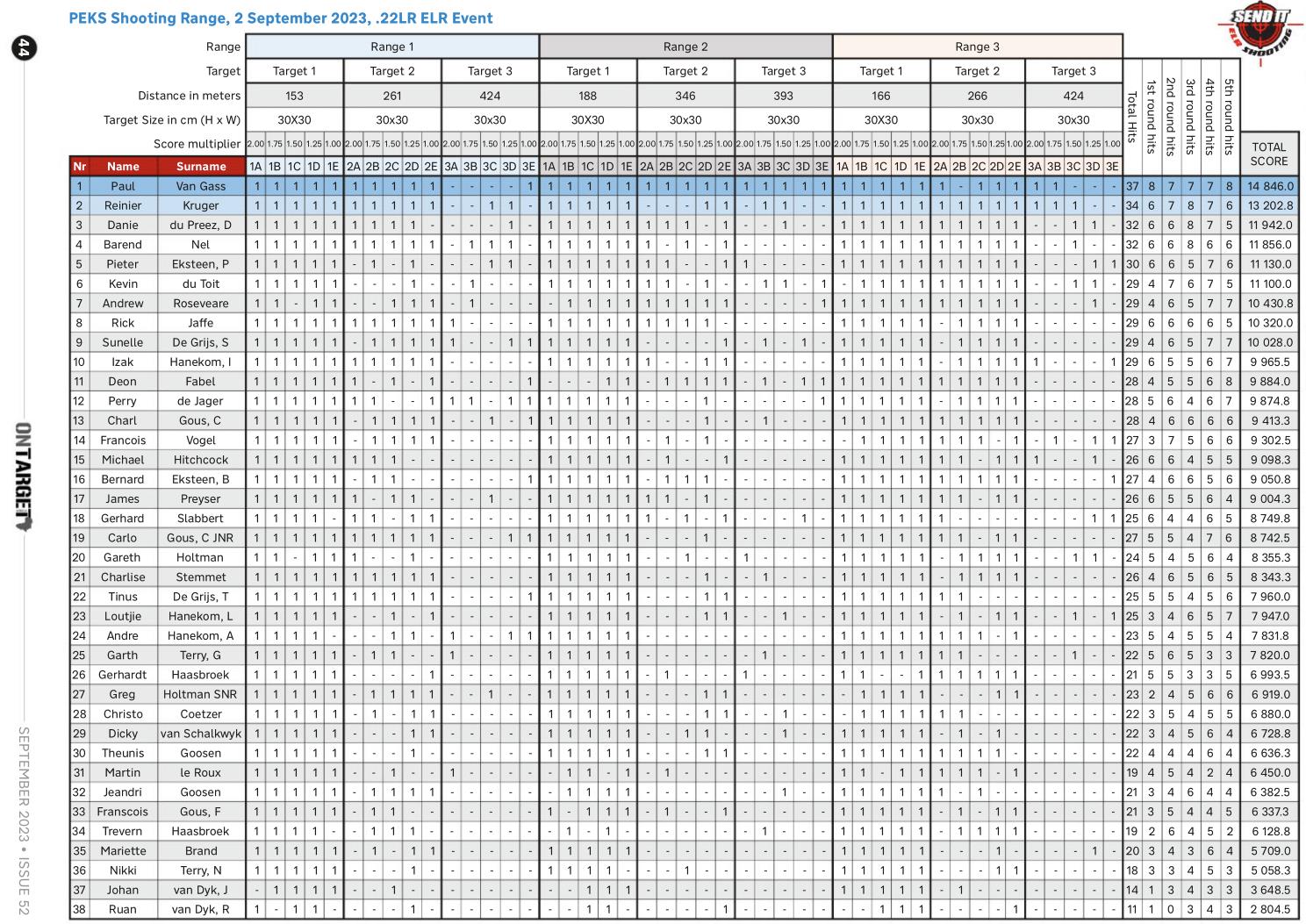

I agree that conditions play a big part when shooting 22LR past 200y. At our September 22 ELR match I managed to shoot a full score early morning when conditions were good on Range 2 - competitors are divided into 3 groups and each group start on a specific range and rotate when complete. That is:
- 5/5 hits at 188m (206y)
- 5/5 hits at 346m (378y)
- 5/5 hits at 393m (430y)
All at 30cm x 30cm (12" x 12") gongs without any sighters - see attached results.
However after conditions steadily deteriorated I only managed 2/5 hits at 424m (464y) on Range 3 and later the afternoon only 1/5 hits also at 424m (464y) on Range 1.
