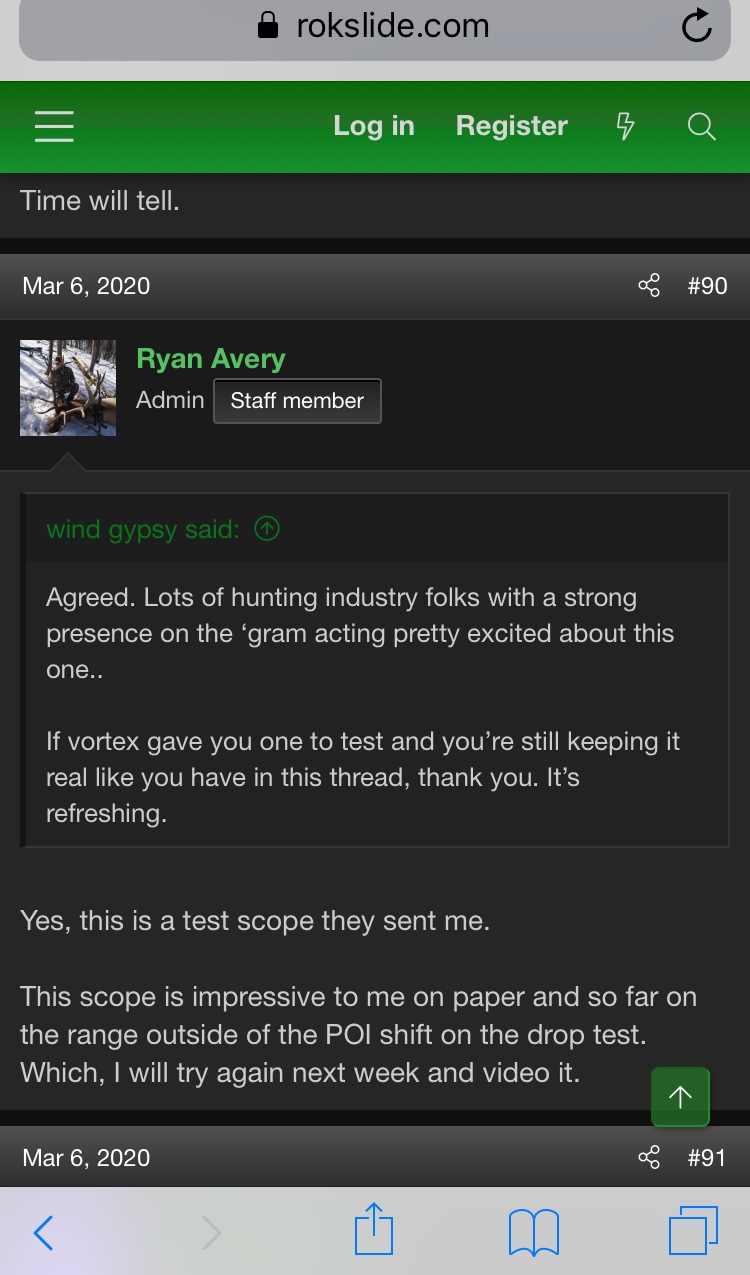

In regards to LHT.. search around for POI shift LHT on rokslide.
