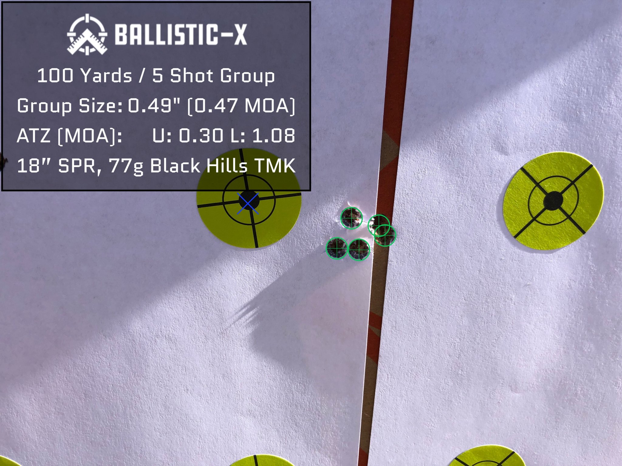

I had a Ballistic Advantage premium series 18” SPR barrel that was ridiculously accurate. It would shoot right at 1/4 minute with my 77gr Berger OTM load with Varget. My 77gr Sierra load was about 1/2 minute and my generic 77gr Nosler CC blasting load with PP2000MR that I found shot well enough in everything was just a hair over 1/2 MOA. It also ran the Magtech 77gr (Sierra bullet I believe) and FGMM 77gr just over 1/2 MOA too. Most quality 55gr brass cased would do sub MOA.
I assembled a few others for people using the same barrel and they reported similar results... 1/2-3/4moa with match ammo. For the $150ish they cost you can’t beat them.
Their other barrels are a different story though, my experience has been hit or miss.

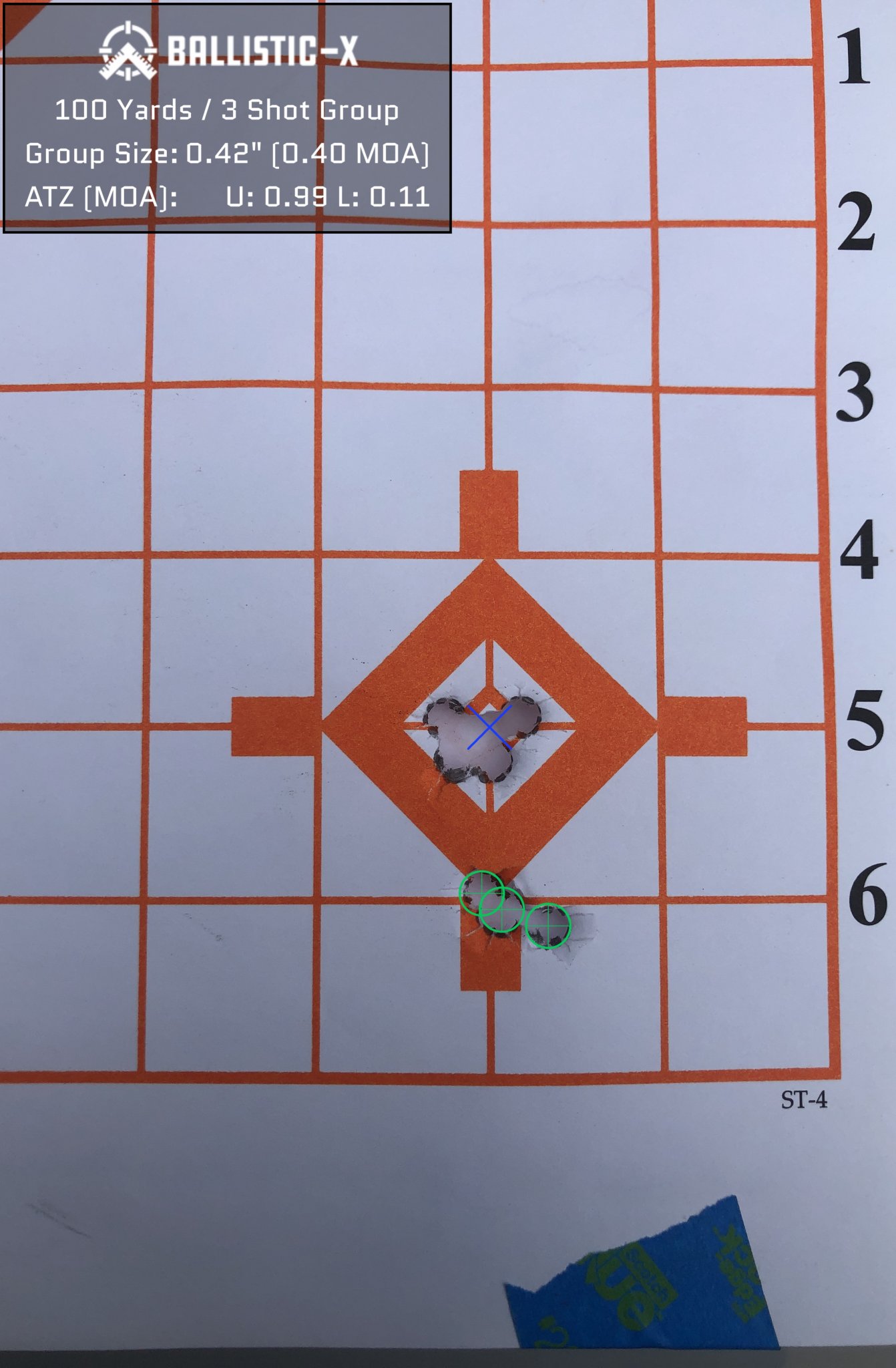

1 5 shot and 1, 3 shot group. 6.5 Grendel, Hornady Black ammo. Sighted it in, shot those 2 groups and haven’t shot for groups at 100 yards again since. No pics but it’s held sub moa out to 689 yards.

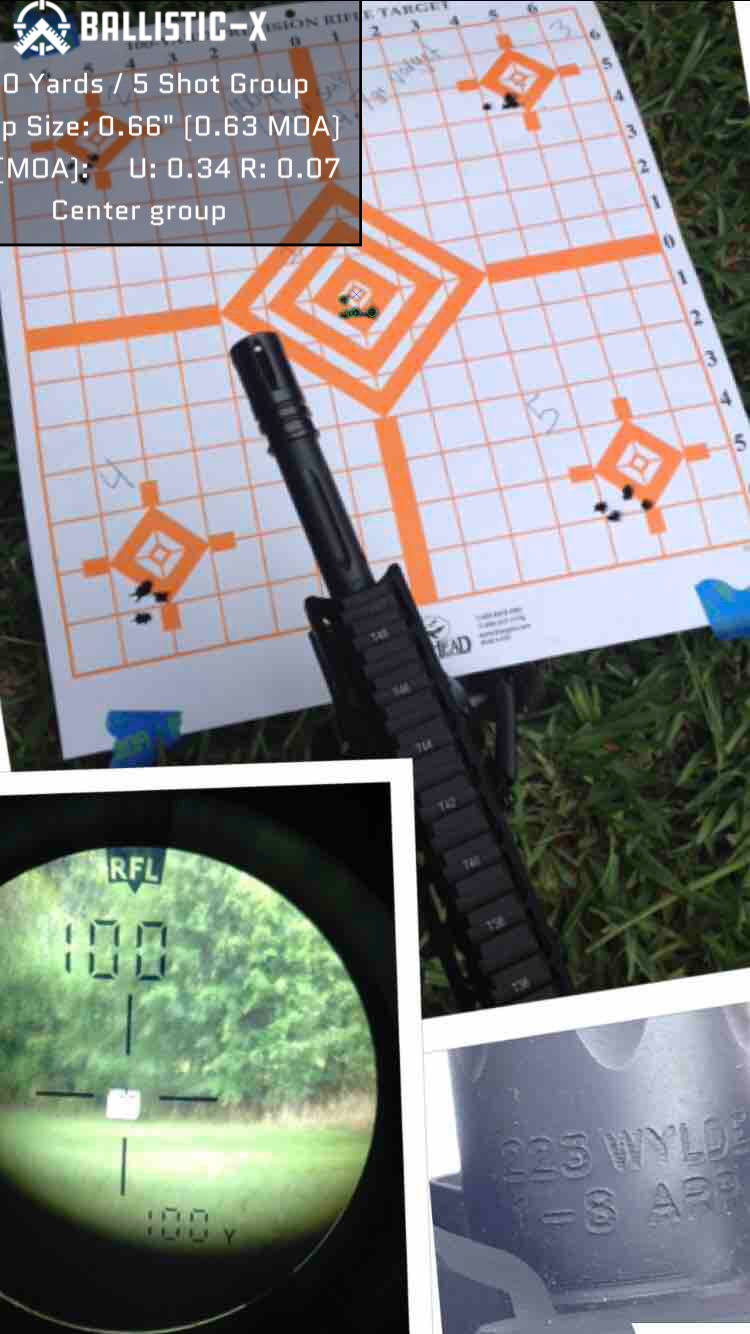

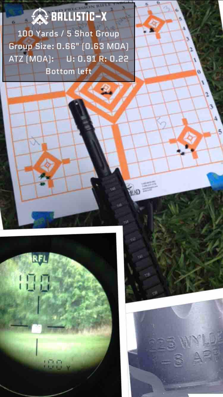

18” 223wylde spr profile that loves 69 grain smk’s. This one has been out to 600 and stays under moa. Those groups were shot back to back with no cool down time between groups. After the 1st group I dialed down 1 moa to keep the aiming point intact. I was impressed with the minimal group shift as the barrel heated up.
I have a couple other 223 guns built with these barrels that perform about the same and wanting to try one of his 308 barrels.
The Kriegers I have will shoot a little better off of a bench but I see no difference shooting from field positions. I think barrel manufacturing has gotten good enough that a maker has to almost try to make a bad barrel these days.
