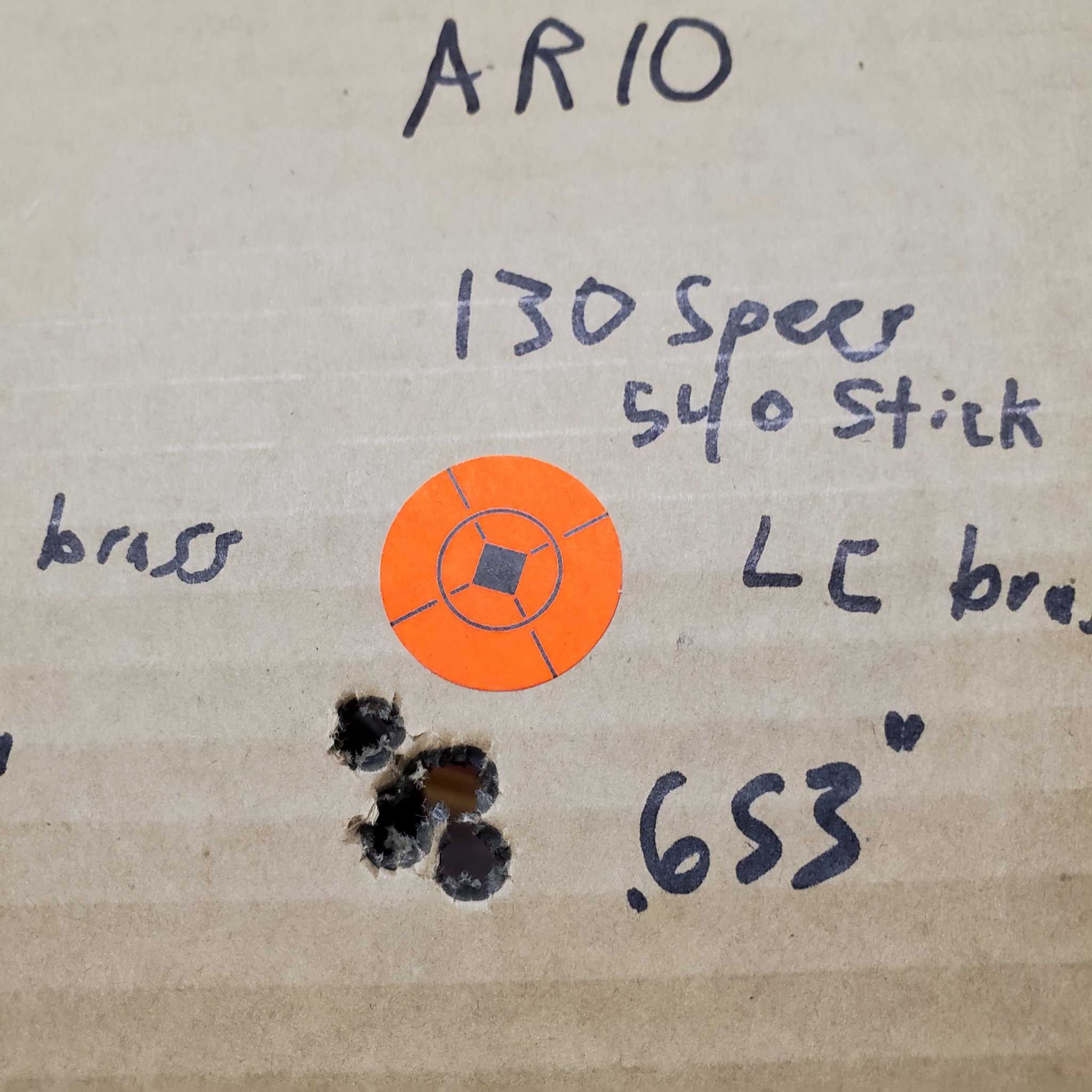

Yes, its easy... to get AR 10 & AR 15 to run under 1 MOA.
Every AR I build will shoot a few loads under 1 MOA, some a 1/4" to 1/2" for 5 shots..
"Build" requires more than just "assemble"...
A good (expensive) barrel is usually a good place to start, although a cheap barrel will get it done, sometimes...
Really cheap fmj military ammo won't cut it. Even factory ammo is not up to snuff, most of the time.
I shoot handloads in everything.

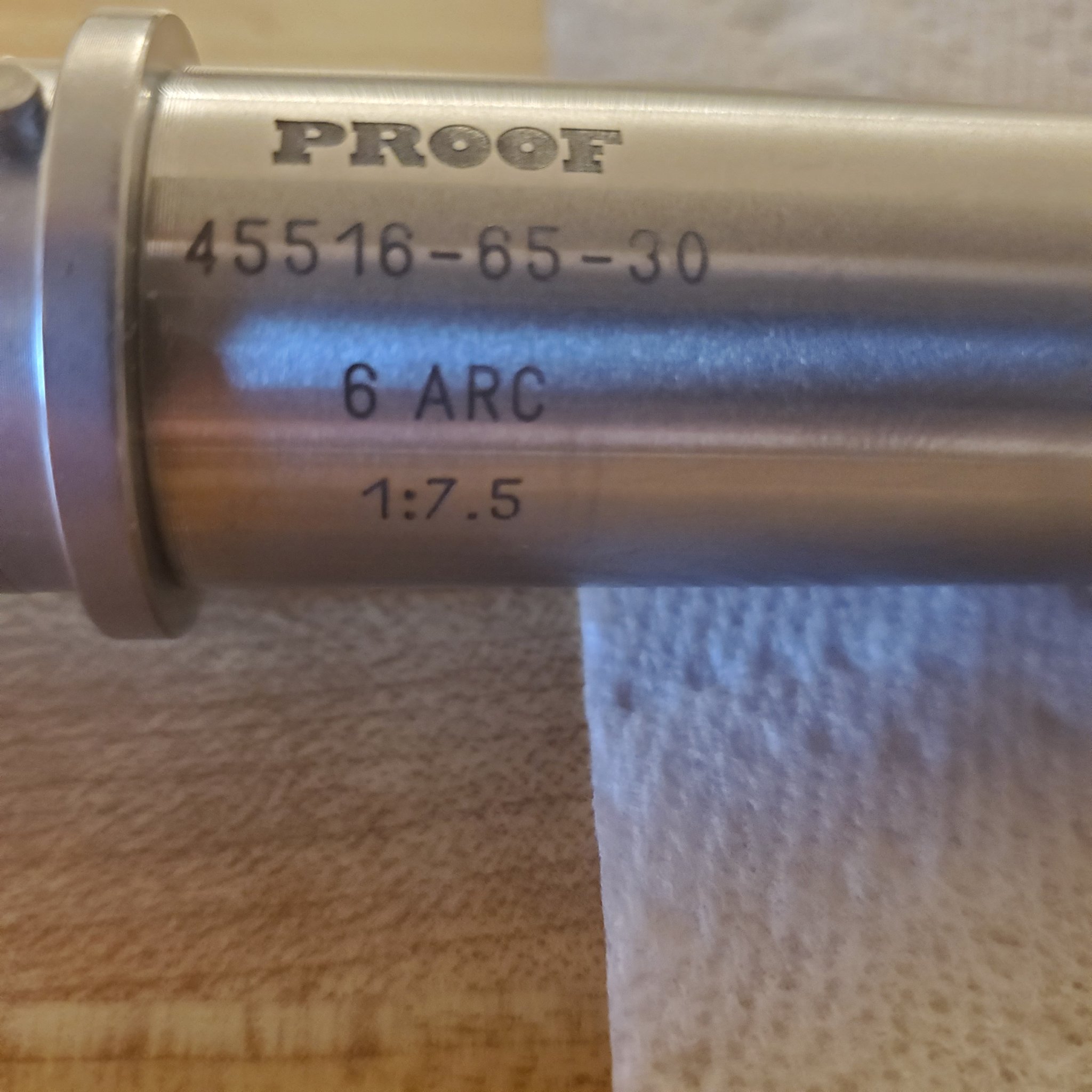

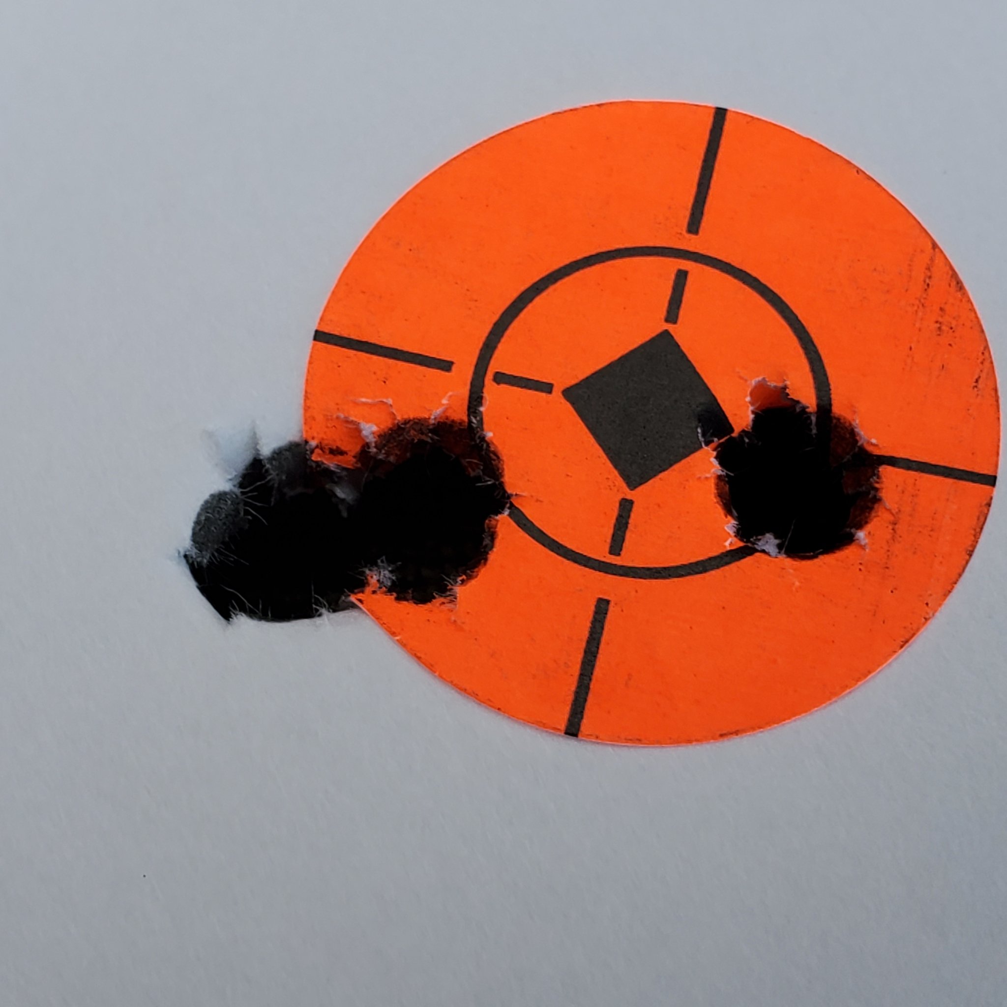

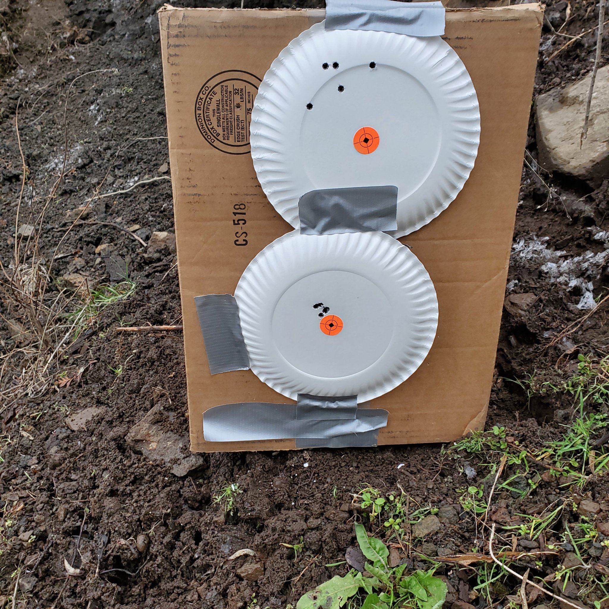

The last photo is two 6 mm ARCs in AR 15 same match ammo ...top is a factory "assembled" upper 5 shots 2.5".
Bottom is a AR 15 "build"...with the Proof Research barrel, 5 shots 1/2" on the first try...big difference.
