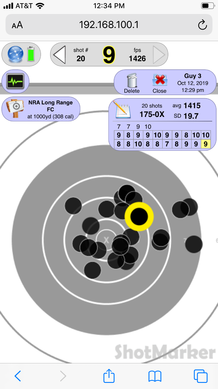

It's possible with a slapped together Aero Precision upper, Criterion mid-weight 20" 308 barrel, Brownell's BCG shooting basic 168 reloads shot off a bench with a bipod. Maybe I'll true the upper, shim/bed the barrel with Loctite and do some load development to see if there's an improvement. Ten rounds just a hair under MOA:
Wow... Looks impressive! I assume we are looking at 100 yards. I wander what it would look like at 1000 yards with .308. In general, is it even a good idea to use .308 or 6.5 creedmoor for 800-1000 yards? Would bigger calibers like Lapua or something else be the way to go? .50 would be tto heavy for me.

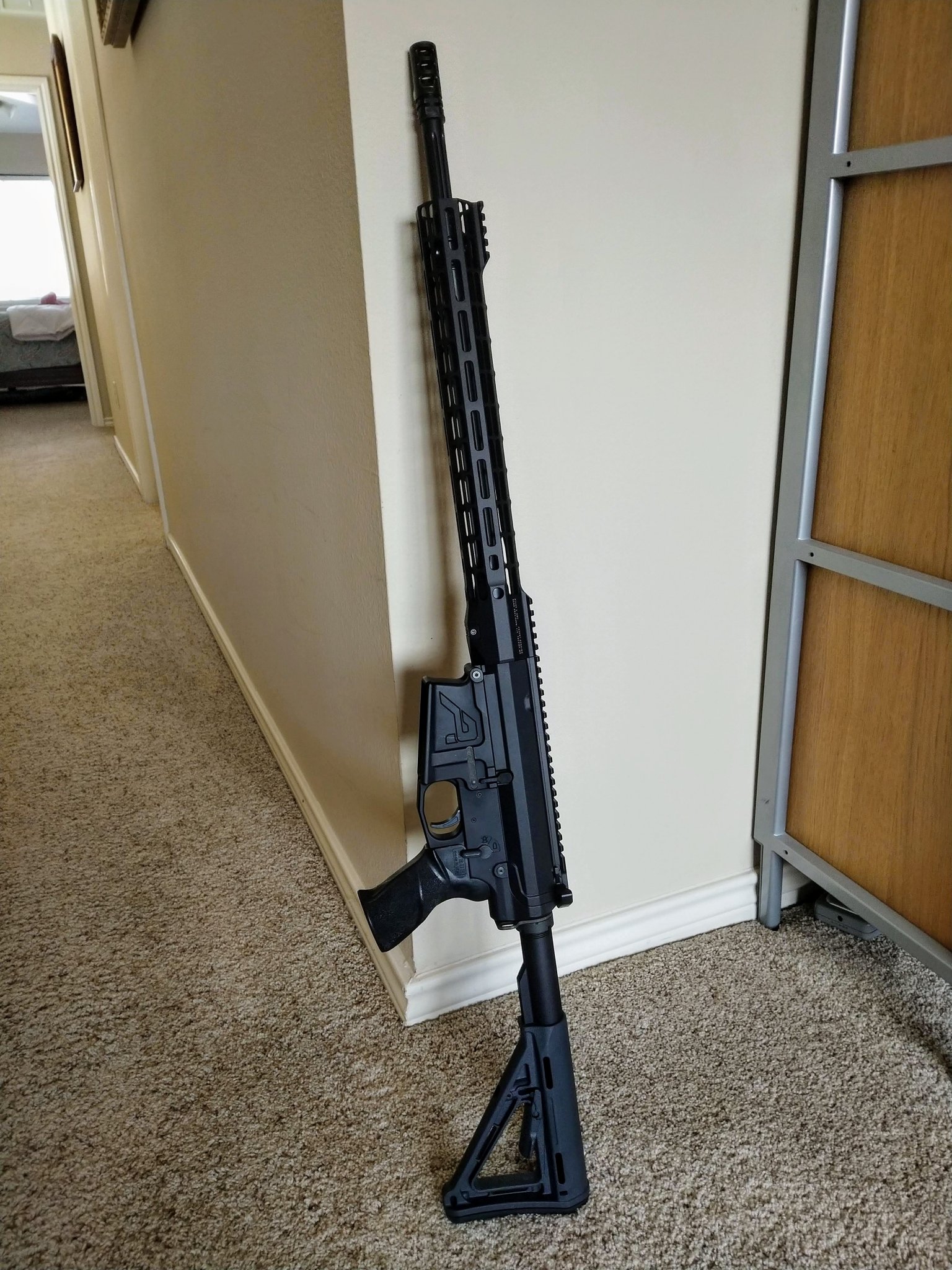

This is basically my build except I went 6.5CM, SLR gas block and a Geissele SSA-E trigger
1,000yds is the top-end of 308 capability in an AR, but still works. 6.5 Creedmoor is a better choice. The 6mm CM has the downside of a shorter barrel life than the 6.5 CM.
Here is a target with the same rifle at 1K using FGMM 175gr
