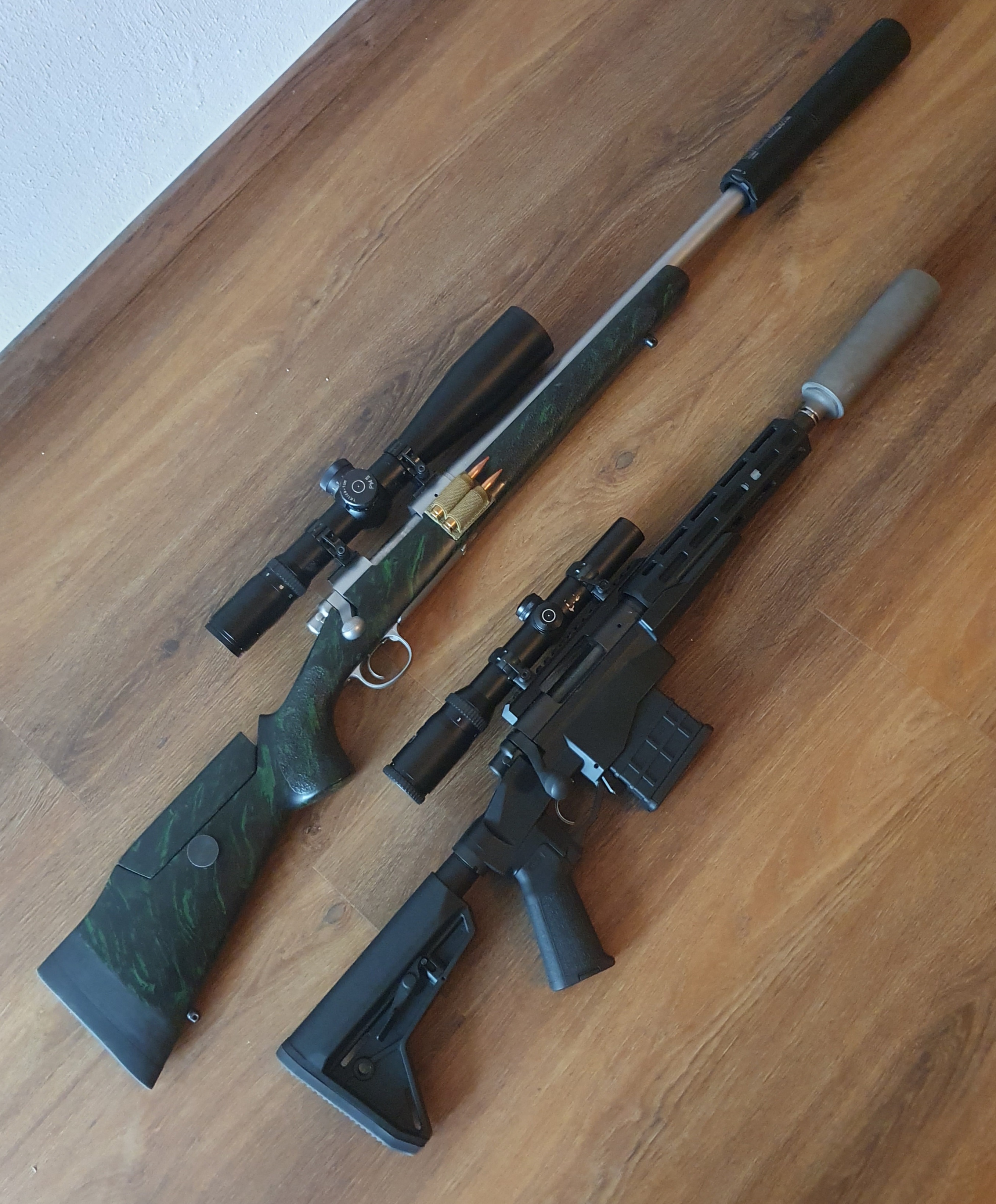

I am trying to build an ultralight 223 bolt gun. I plan to shoot 77gr subsonics with a suppressor. But I want it to be as short a barrel as possible (sbr length).
At what point in cutting down the barrel would subsonics lose the required speed for rodents and other small game?
