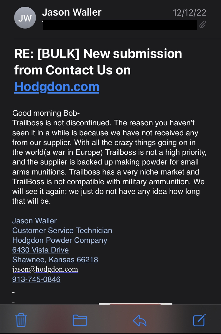

A asked about it in Dec. here is the reply I got:
I have tried 175 SMK in 308 and good accuracy in all twist rates 12, 10 ,9 & 8 barrels 18" 22" 27" & 30".But I used Trailboss powder still have some left ..Trailboss works in everything even in the 50BMG, totally fun. Around 10 grs to 10.5 grs depending on barrel length for the 308.

ADI who make it did not make any in 21 or 22 with no update since Dec 21.
ADI news link,
Last update,
From the above,
"Trail Boss – This propellant is unlikely to be released in 2022 as there continues to be an active research and development project associated with its manufacturing optimisation."
Have also been told it has been discontinued but have not seen it officially.
