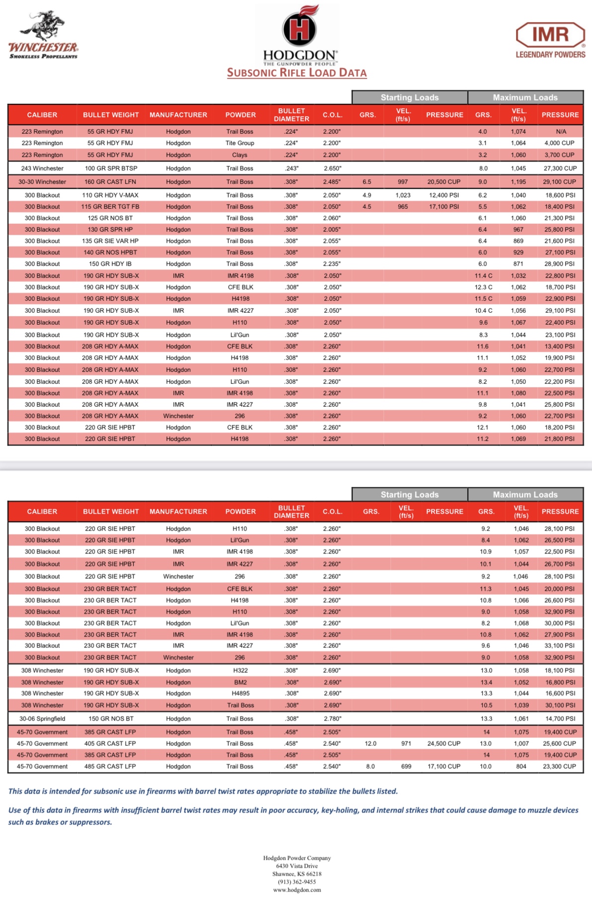

I have a load I use in my MDRX that will cycle (just on the edge of short-stroking)
uses a hornady 220gr Round Nose SP over 10gr of Trail Boss. since I live in the People's Republic of Marylandistan fun is not allowed and I can't have the 16" 300 blk barrel kit, I made this work. (we have a dumb 29" OAL requirement for centerfire semis)
Incase Imgur shits the bed: 2.760 COAL, 10gr Trail Boss, Norma Brass, CCI LR primers, part # for the bullet is hornady 3090
