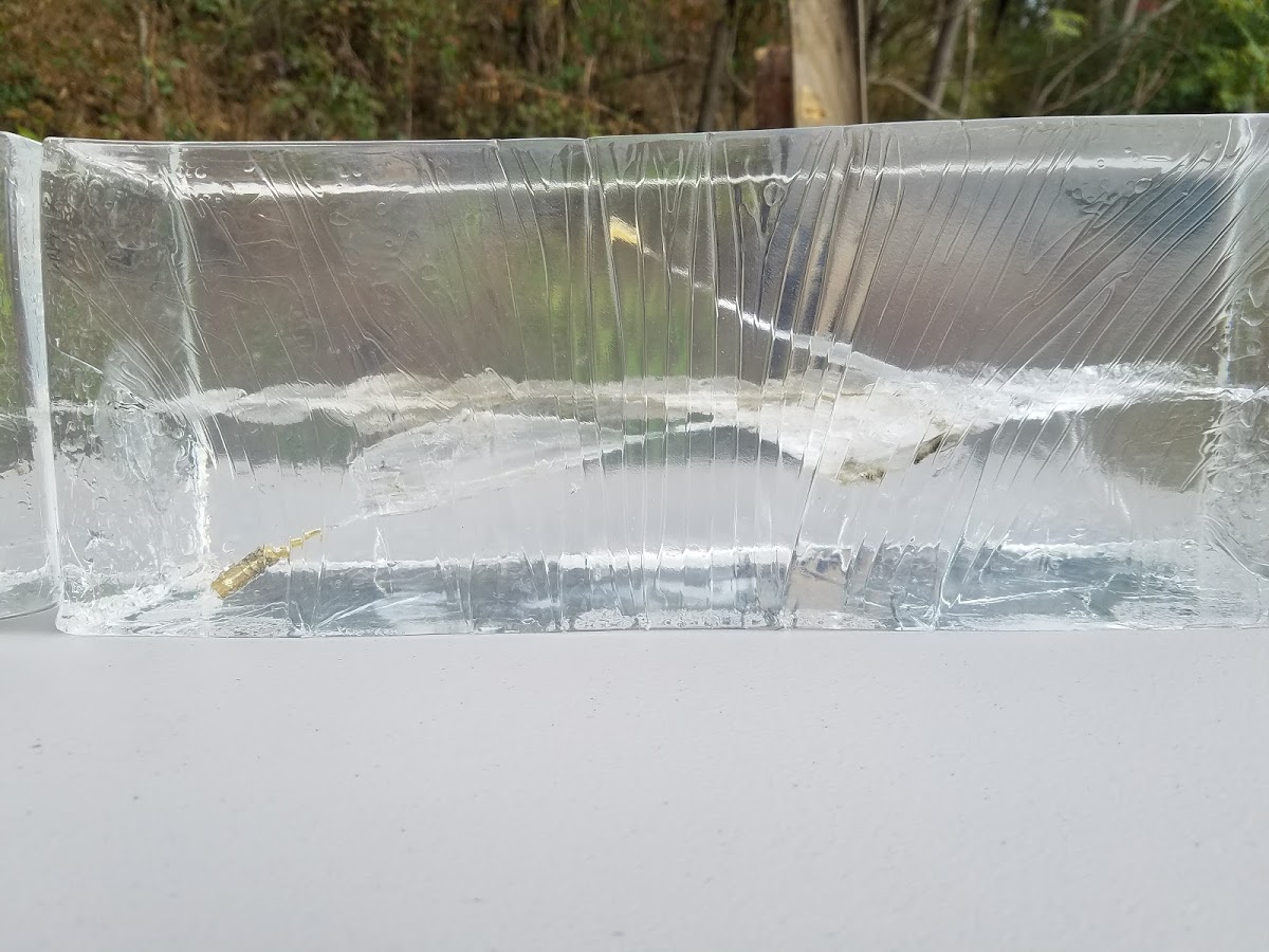

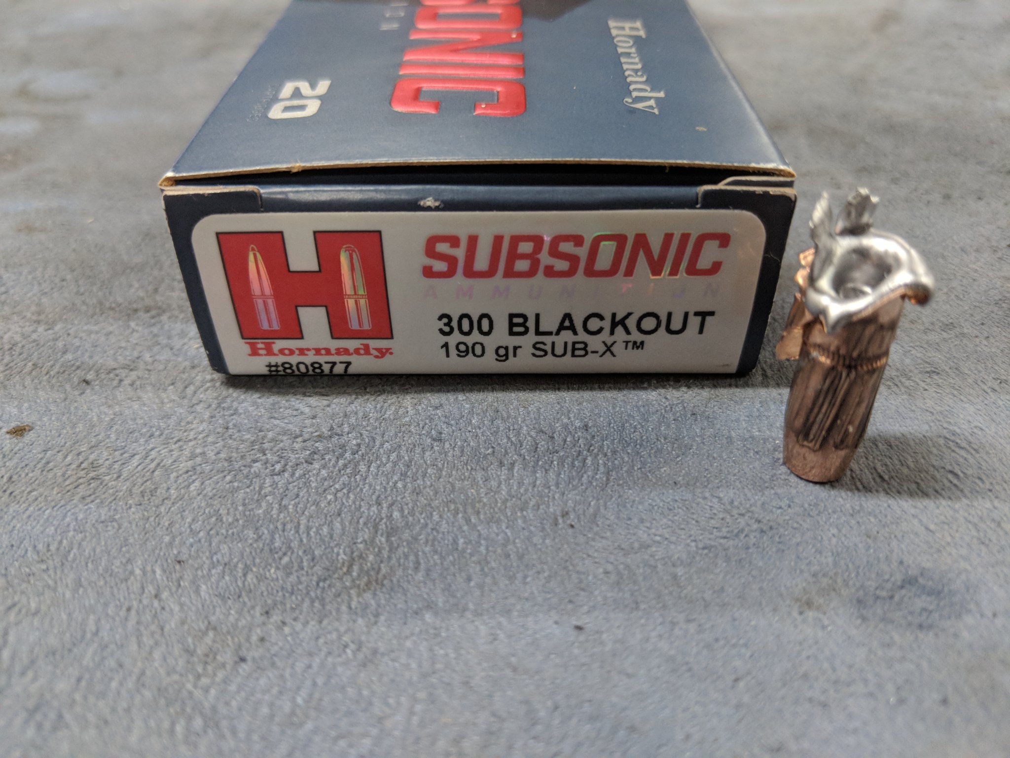

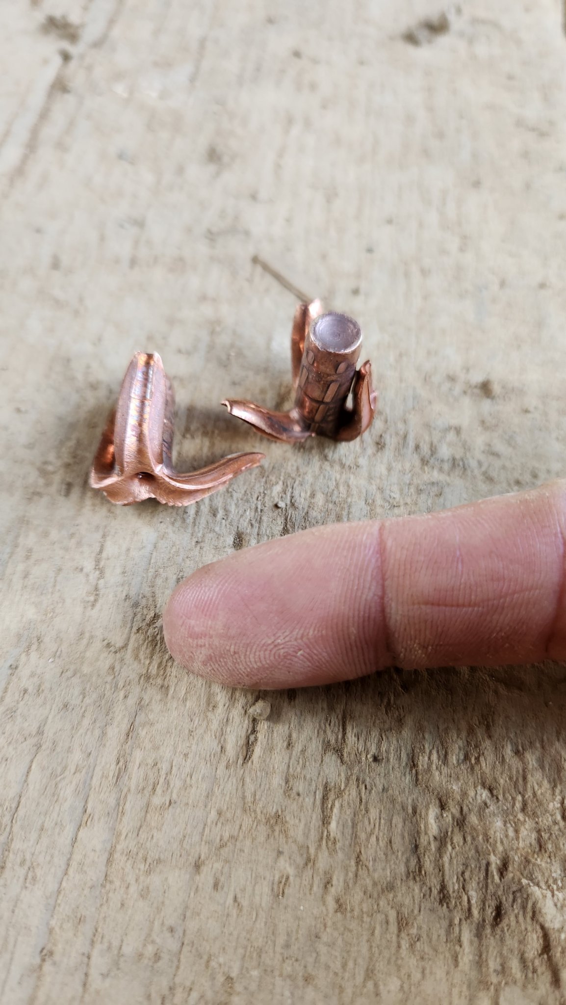

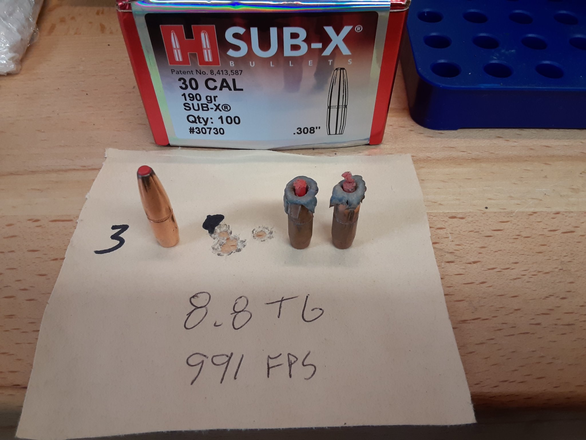

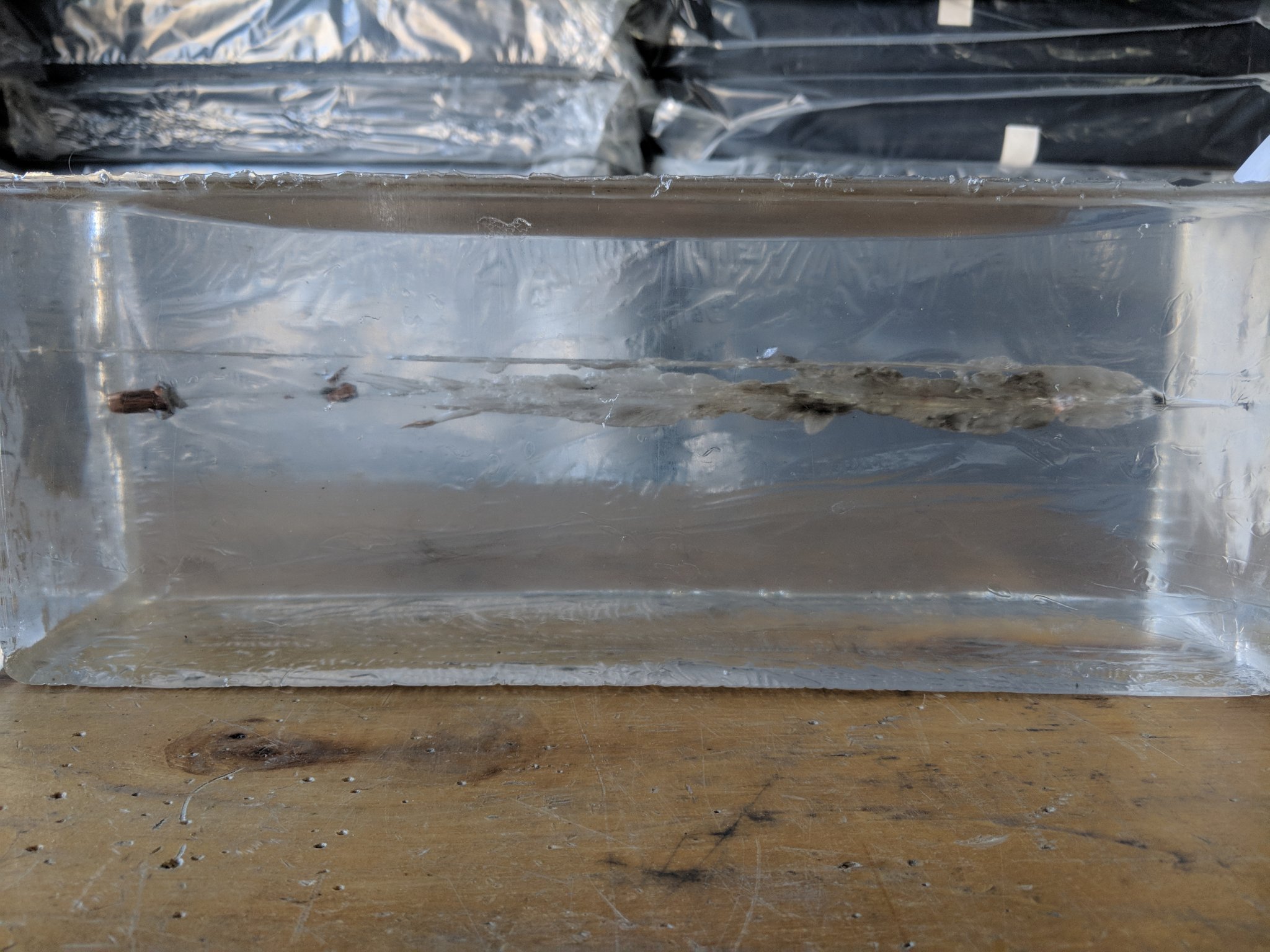

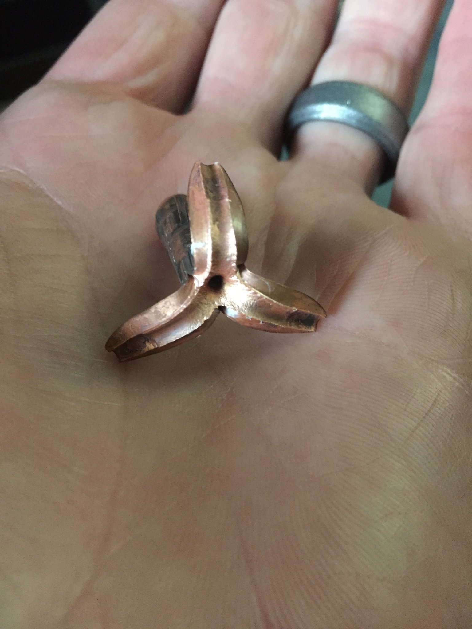

Anyone have any experience with the 200 grain Speer Hot-Cor bullets for expanding subsonic .300 Blackout? Also, considering the 180 grain Grand Slam as well. Looking for a good performing bullet that will expand at subsonic speeds.
I'd suggest the 194gr Lehigh, that bullet has proven to work well enough on both deer stateside and even better on humans in the Mid East.
there are also several maker bullets like the 200gr Rex that will reliably expand at subsonic velocities.
The trick to finding expanding subs is to find bullets that are advertised and designed to work at 300 Blk velocities, 200gr + bullets made for the 308 will have no expansion at subsonic velocities.
If this is for a serious deer or other medium game hunting load I would avoid subsonics all together. The best performing expanding subs give about identical performance to broadhead arrows. I'd suggest a supersonic bullet like the 110gr TSX or 125gr SST for longer range and rifle like performance on game
The 125 sst are great and the barnes 150 tsx and ttsx. At super are pretty good as well
None of the expanding subsonic bullets have been reliable from what I have seen. I am also of the opinion that subsonic ammo in 300 Blackout is a novelty, as literally any application of it would be improved by using 110-120 gr supersonic projectiles. I get that some people have killed people and critters with subs, but it's genuinely not an optimal thing. All you're doing is using a rifle-size firearm to perform pistol performance.
But vewy vewy quietly
This link is worth reading on testing done with a few different bullets including Lehigh. I have come to the same conclusion and have found the same results. I may try a fragmenting offering from Lehigh as a last attempt but head shots is the only method I would recommend
If looking for subs that are actually going to do what they are supposed to Lehigh and a couple others are the way to go. Ive made light subs and heavy subs just playing around 110 v max all the way up to 208 220 with all different manufacturers the 150 gr. Barns tsx actually opened up pretty good but nothing to write home about. For a BO sub to be worth a shit it needs to frangible projectiles like some controlled chaos or something along those lines not just an open tip of rapid expansion
i dont load 300, but i do have a buddy i put some 308 subs together for. with the reduced velocity, most bullets designed wont expand well without the velocity….which is why i used 170 gr 30/30 bullets. they are designed for expansion at lower velocities. what they actually do on game, i couldnt tell you.
were it me, and subsonic was the interest, i’d go with either sub 44 or 45 caliber pistol cartridges and go with the heaviest bullets i could….no need for expansion due to the original bullet diameter. but.. that would exclude the ar platform from consideration. maybe the 458 socom could be used to fill that nitch..….but that is outside my wheelhouse.
I found a few thousand new 300 BO cases in my shop today. I probably shoot 20 rounds of it a year, so it should keep me a while. No idea what I am going to do with them, though. I have tons of the Barnes loaded up, and for subs I usually just load up heavy 30 cal bullets I've decided not to use elsewhere.
The Lehigh bullets expand as they are supposed to. The problem is that unless you shoot them directly through the heart the deer run to far off to find. Blood trails non existent or very light and sparse to track them. This lead me to head shots only. If you read the report I posted above It shows the issue with low velocity 30 cal bullet impacts. Going to try a bullet with petals that break off to see if it will produce a better wound channel but have a feeling results will be better but not perfect. Head shots are the way to go for me and expected results. Would like a 458socom I think it would be a game changer with the 500g plus bullets

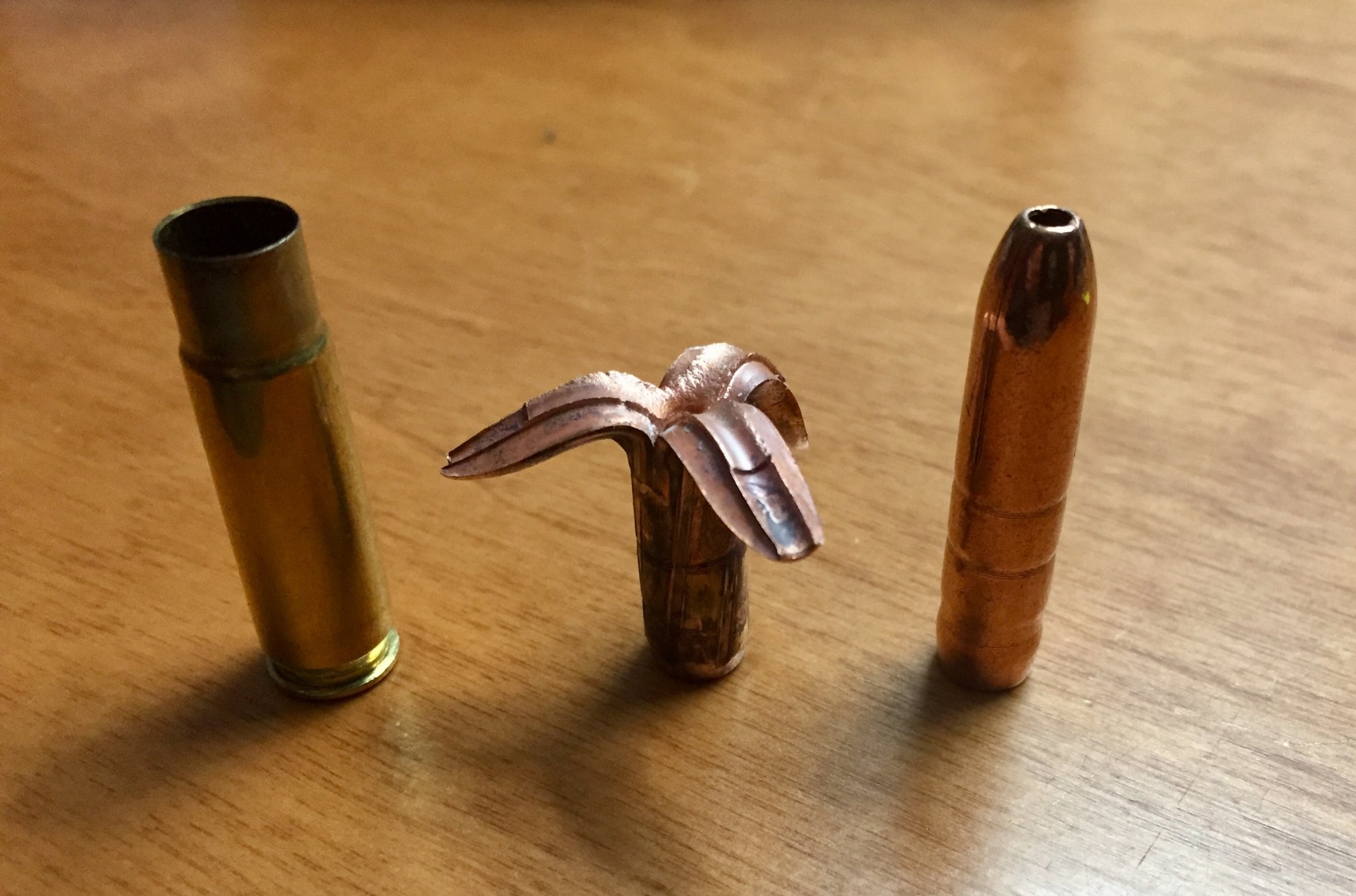

I don’t have experience with the 200 Speer Hot-Cors, but I don’t think they are going to expand at subsonic velocities. They are marketed for big game. I shoot the 150 Hot-Cors in my 308 shorty at 2700ish and they perform really well at that speed. If your looking for a good expanding sub bullet check out the Maker 200 and 220 REX bullets. I’ve had good results with them.
Reactions: Zeus0390
Was that pulled from a deer or what did you shoot it into

Every deer I have shot with the outlaw state bullets have been recovered. The ones that ran left good blood trails. The exit hole is 3/4-1 inch wide.
Before I found the outlaw state bullets I was using sierra 220 grain match kings. We probably only recovered 70% of the deer shot with that load.

I've used the 200gr Maker Rex to take deer out to 73 yds., my longest shot, and haven't lost one yet. I scoff at those saying we're unethical and we have to pick your shots more carefully. Does that mean that they can disregard good shot placement just because they are supersonic. If so they are even more unethical. I believe many opinions were formed pre-Lehigh and pre- Maker. I can only speak to my experience with Maker and so far they're batting a thousand with 9 deer.
MV and range? Or, estimated impact velocity? And, what was the target?
Those average 1050fps. I tested them at 75 yards. The rifle was a Rem 700 Tac with 16" barrel. They expanded all the way down to 850fps (130 yards) but only exoanded to about 1/2 that. The petals are ridiculously sharp. The testing medium I used was a 1/4" thick piece of leather over a 1# bologna pack backed by 1/2" particle board and then 6 water jugs. They penetrated to the 5th jug. I am gonna use them this bear rifle season
