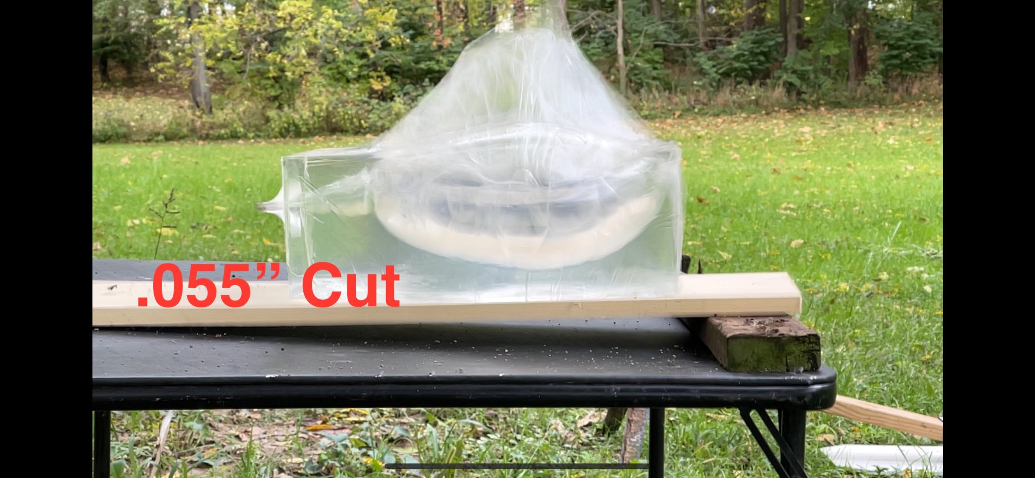

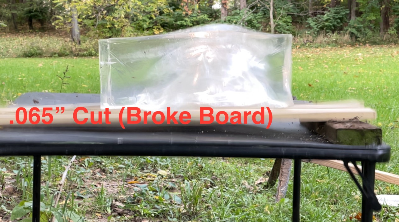

I have a couple gas options now. I’m going to be testing the Tubb Nose ring tool for the Sierra 220 to see what happens in gel. Probably not ideal for harvesting game due to the frangible effect it has. But good for critter control.
I already tested some 103 Vapor Trail 6mm bullets in gel and the rounds borderline explode with a .085” cut. I can go to .105” and still not to the lead core. My goal with the 6mm was to have the round enter and not exit. It was almost there at .085”.
The 6mm rounds are traveling much faster, but none the less will be interesting to see how the 220gr does. This is just for fun on my end but this thread peaked my interest so I thought I’d chime in.
I want to pop critters 100-150yds at night without disturbing my neighbors. Using what components I have already.
