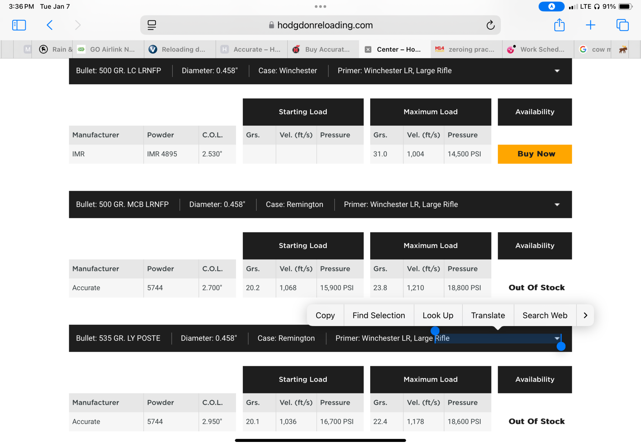

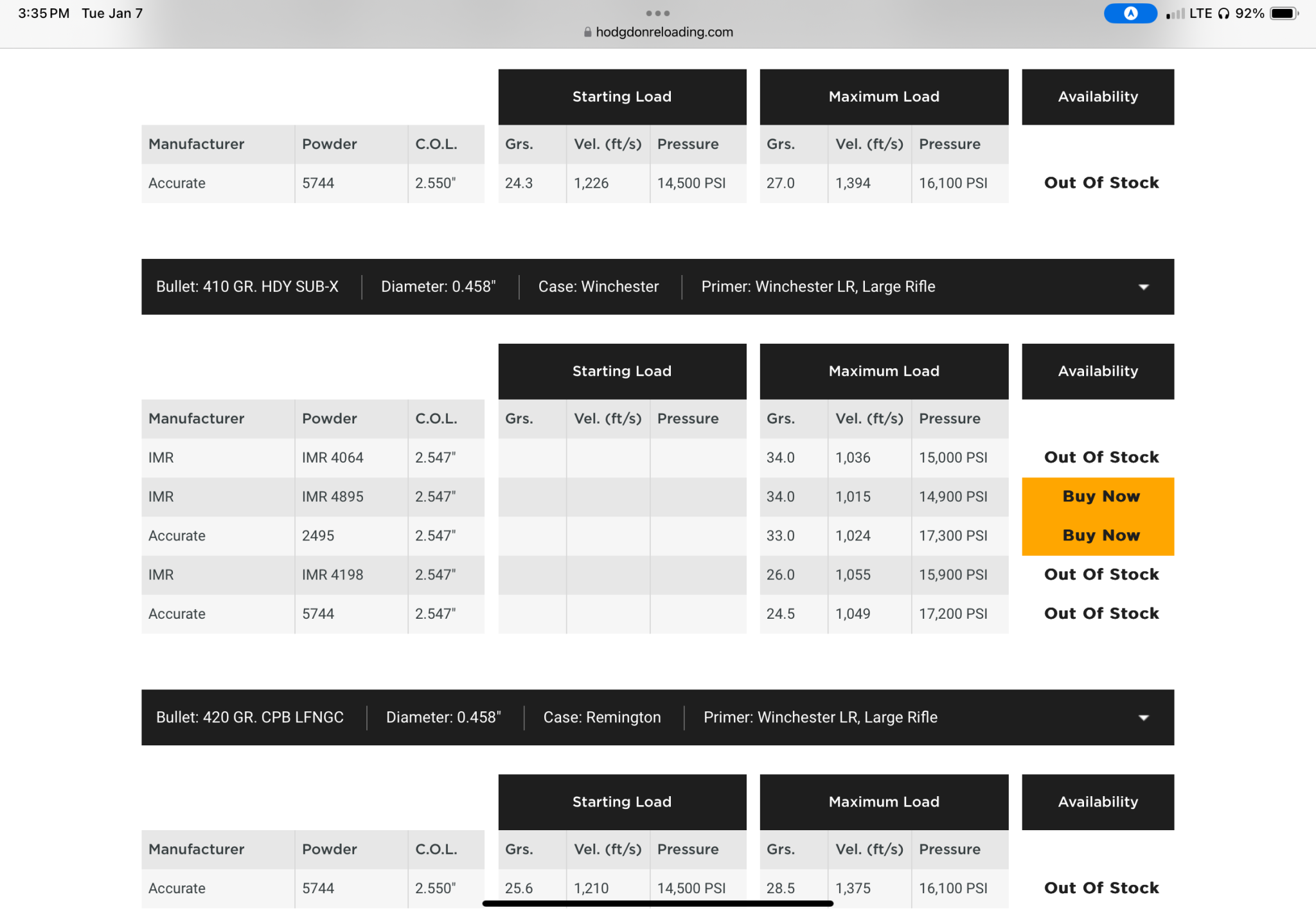

Here’s some 45-70 loads for a Trapdoor from the Hodgdon website, there are powders other than TB that will work:
Reactions: doubloon
