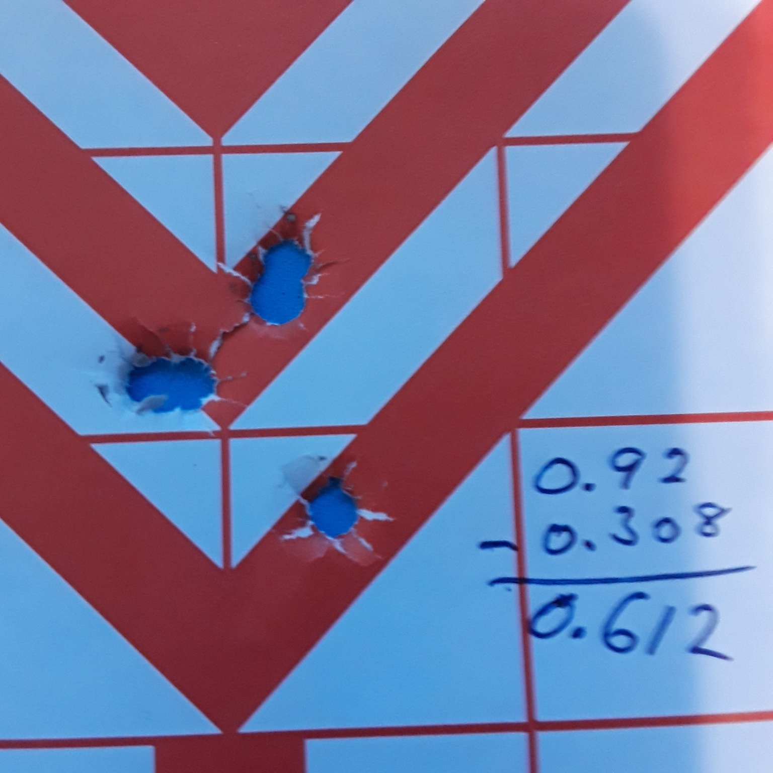

    I have an 18-in, 10TW .308 barrel from Criterion that I can mount to a Bighorn TL3 with a Savage nut. My primary purpose for this barrel was fun quiet subsonic loads. Second was an easily maneuverable suppressed option for hunting. A distant third was "What the hell - let's see if I can get hits at 1K."
    It is very quiet with 220gr subsonic loads, extremely accurate to about 600 yards with supersonic loads, I did get a deer with it, and I have made hits at 1,000, so mission accomplished. But to be clear it is no match for my 6.5x47 in any way other than subsonic suppressed fire, which I have never bothered to try with the 6.5x47.
    You can do it all with one gun - if you have reasonable expectations for what it will and won't do well.

    For relatively short range (i.e. inside 300 yards) the 300 Blk can produce pretty good accuracy. For longer distance though it's really not a great choice; it just doesn't have to ballistics to do well at long range. While the best ammo choices can technically reach out to about 600 yards before dropping into the trans-sonic region, you're dealing with a lot of drop and wind drift by that point so it's more challenging to hit with than the faster cartridges. It can be fun to plink with at extended distances though, just for the challenge of it!
    There are exceptions of course, I've seen a couple decent targets from a 300 Blk fan shooting at 1,000 yards just to prove he could, but for all practical purposes it's one of the poorest options for long distance in the AR15 platform. With that said, it can do anything the 7.62x39 can do, but better because of better bullets and the AR15's capability for much better accuracy than the AK.
    Hope that helps.
