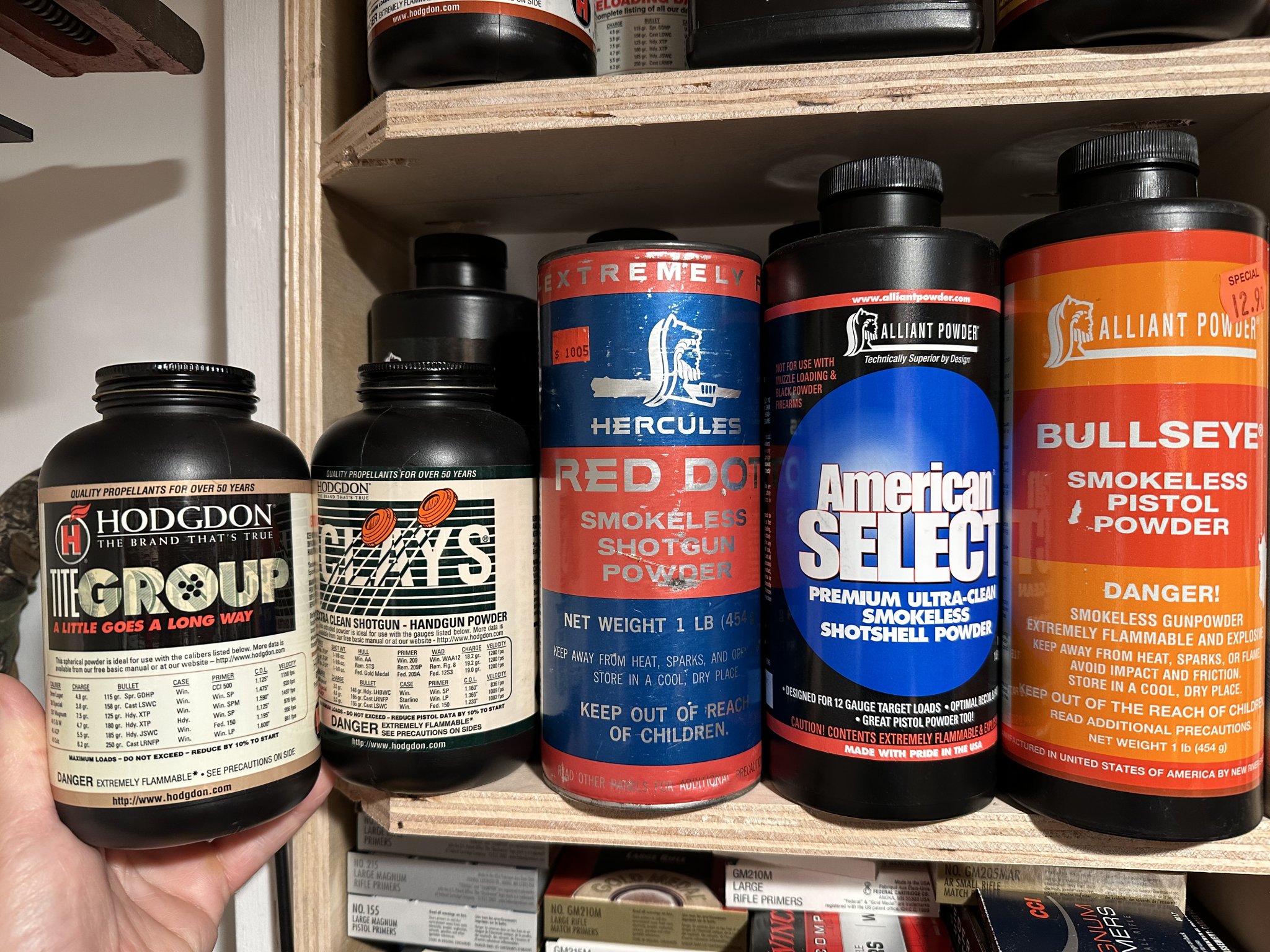

I’ve got the powders below to work with including 6# of TrailBoss not pictured. Any known loads would be appreciated. Don’t look too close at the price tags, you might throw up.
Looks like Hodgdon’s has TrailBoss load data for several bullets on their website.
For Red Dot and 150 gr bullets I settled on around 4.9-5.2 gr after starting at around 6-6.5 gr depending on the bullet. It was reduced until a velocity of 1000 fps was achieved. With other powders including Bullseye and N340 the charges have turned out to be surprisingly similar.
I have found the 110 gr loads to be slightly quieter than the 150 gr loads even with the same powders, and the same velocities.
There is no way Lil Gun or H110 will be as quiet as these.
Use this data with caution given the low case fill percentages and lack of published data! Some powders such as H110 can dangerous in these scenarios!
