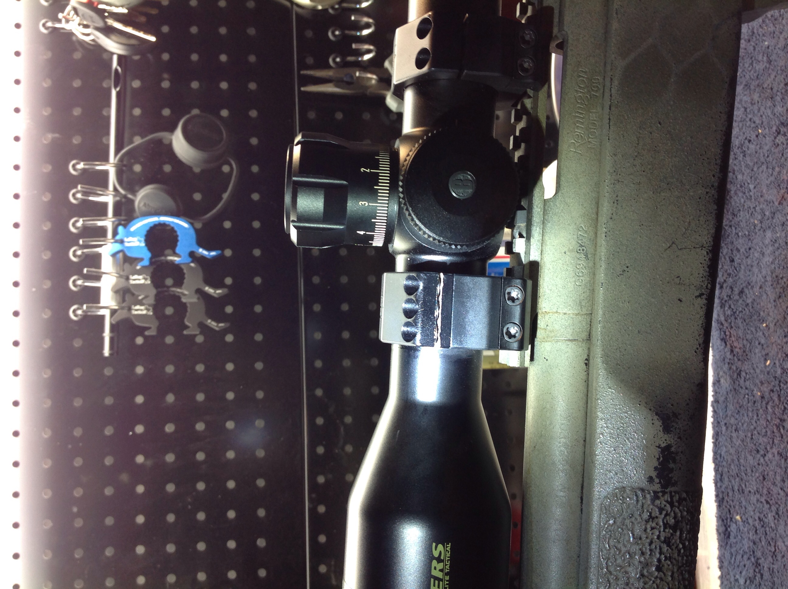

Did not read all comments, but my vote is for Nightforce on Nightforce. I'm running the NF 20MOA base with the NF ultralight 6 screw rings. I prefer the 6 screw just for added peace of mind. Caveat is you lose a small amount of scope adjustment. I ended up having just enough to get proper eye relief, so your mileage may vary.
