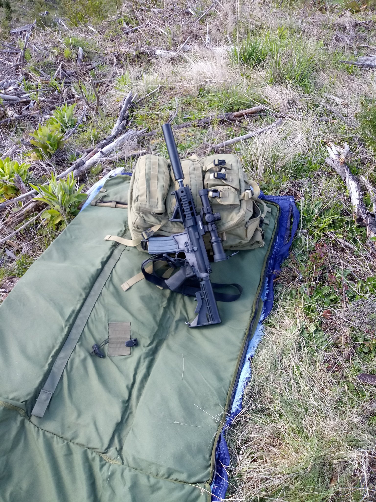

Seekins SP223 5.56 with Sig 7.5" piston and SWR 7.62 Suppressor (7.5" is very loud without). Seems to work good for me. Had it out to 330m bowling pin consistently. Fun to shoot!
