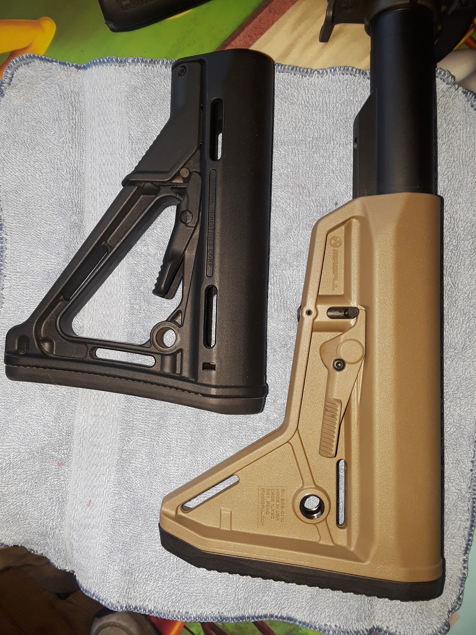

It's not a prs stock but rides a bag much better than the crt carbine stocks.
