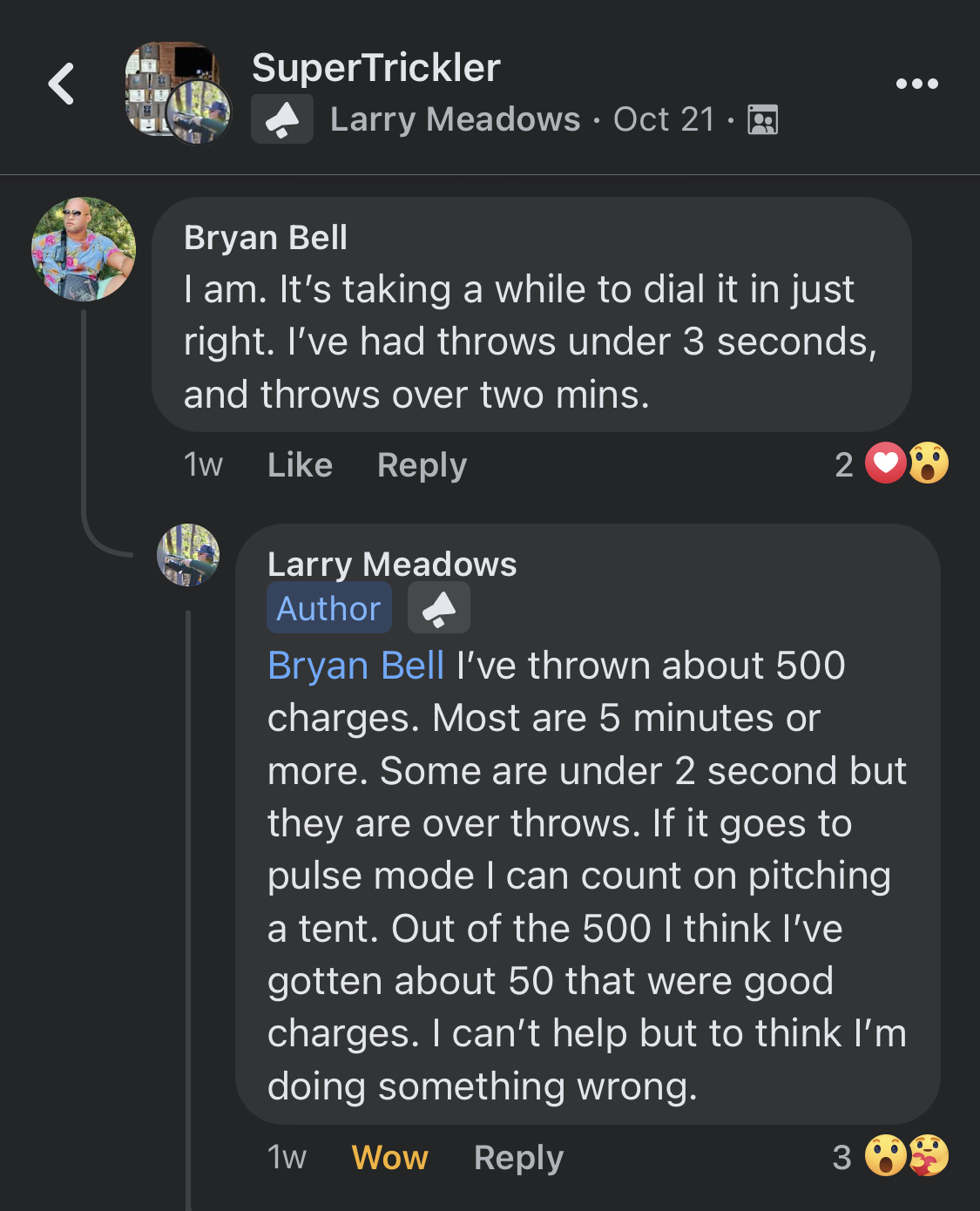

Where do you see this being reported? I've seen nothing of the sort reported by anybody.
This. I've been following the ST pretty closely and haven't seen anyone mention any issues.
Join the Super Trickler group on Facebook, seems to be powder dependent, at least in cursory review, but guys are having some really long charges, and a few guys reported the machine will “look for the last kernel” for a really long time.
Reactions: morning would
I’d like to see
More about this
Cuz I am in that group and I didn’t see that or anything else like it after august or so in 2022 when the first ones went to beta testers. Elfsters rifles hopefully will show up to comment, as they have had one for several weeks and they’re not retards
I’d like to see
More about this
Just passing on the observation. You can see the posters and the date stamp there, I trust you can find the thread, it’s only a few days old. The OP there mentions they tried Elfer’s settings and still isn’t getting good throws. Elfer, Peter, and Rex have all commented to the variability in the vibration control parameters between machines in the thread. I’m sure a resolution will come, but multiple folks are reporting long dispense times and hunting for the last kernel in the forum - which is one of the reasons for that forum to exist…
My confidence is high that they’ll figure it out, but as with all new product launches, it doesn’t seem to be without bugs. Buyers have to decide for themselves whether they want to be an open source beta testers at their own expense or not.
I’ll also admit, I don’t love that the V4 has no local control option, making it vulnerable to software survival - which was not an issue for the 1-3. In speaking with Rex on this a while ago, it doesn’t seem like ST has intention to offer revisions any time in the next 3-5yrs, so what we see will be what we get for a while, while MacDonald can be expected to issue a V5 before then, which may rectify the lack of local control on the 4. Or both groups could go teets up since they’re small, bespoke boutiques…

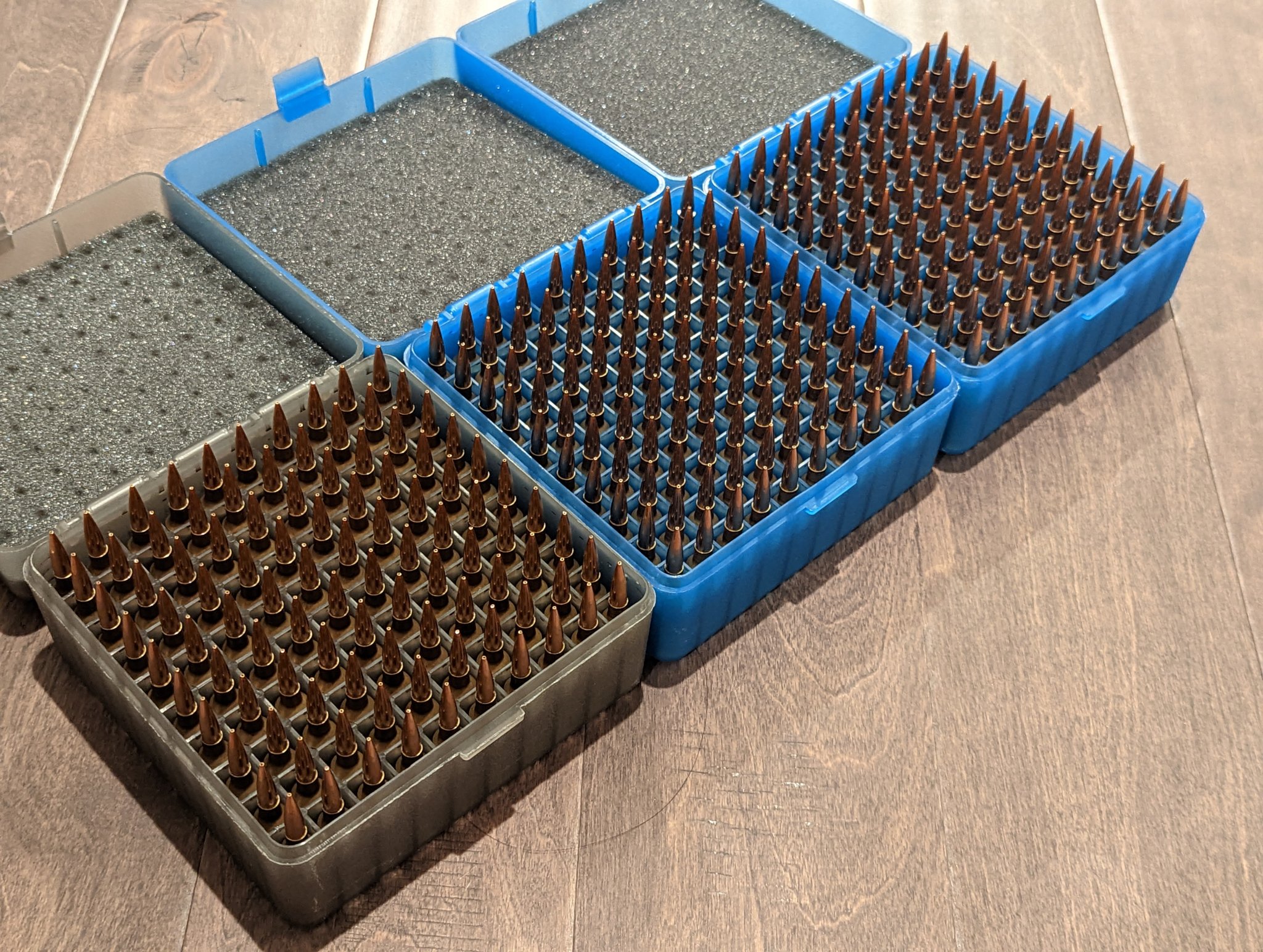

wow! 900!.... that's amazing! all at 5 seconds too!? id love to see an unedited video of this for just 100rounds plz. that's awesome! :)
Just loaded for a match before this post but I'll be happy to post an unedited video on the next go around.
Key with the IP is to set it at 1.2 gr under target, slider all the way to the right. It's fast. Having owned every version of the AT, this is the fastest powder drop setup I've come across. Awaiting my Supertrickler to ship.
Kinda get an idea.
