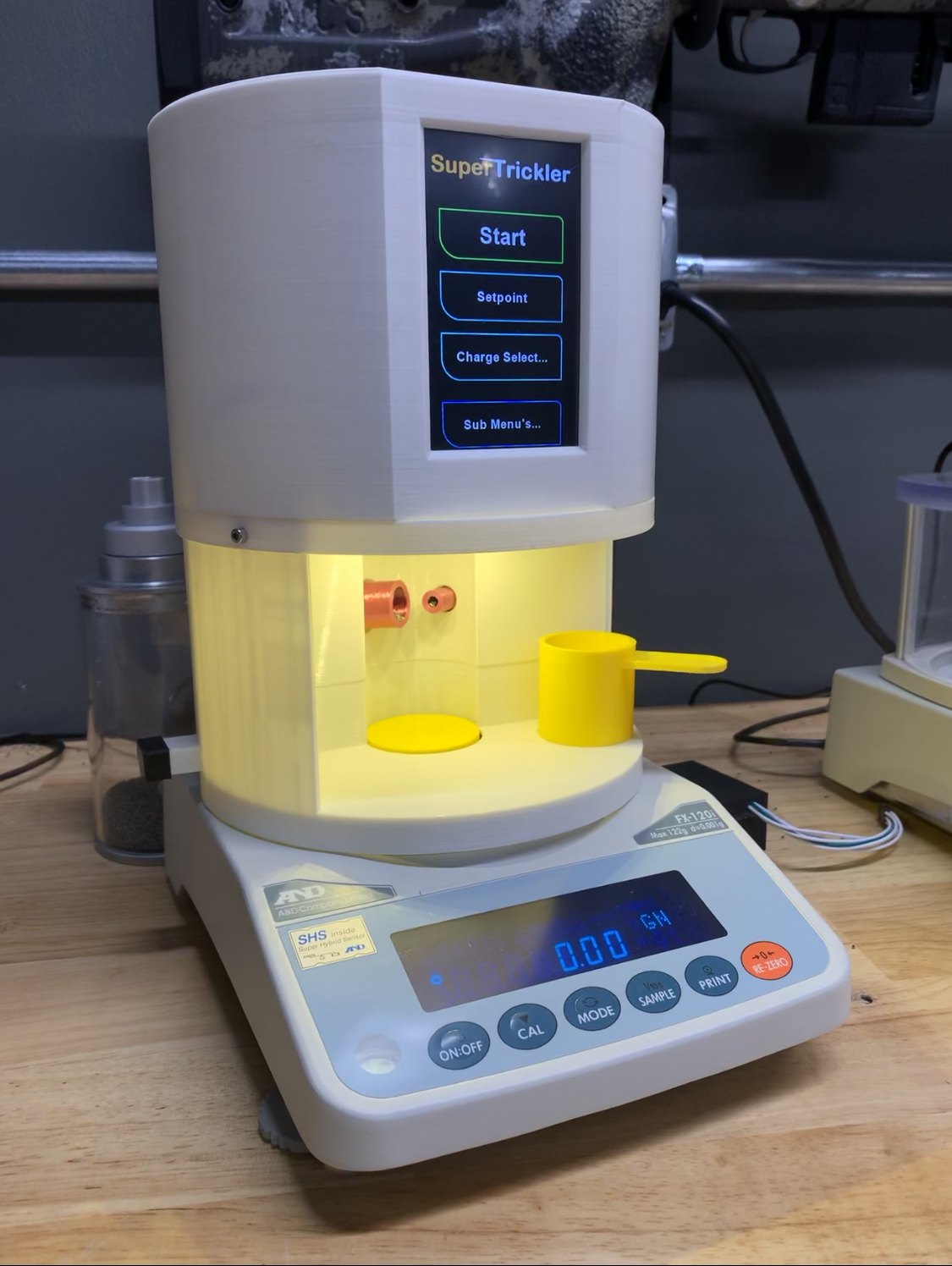

    My only concern is it costs $130 more then the autotrickler v4, and it's brand new and not proven by thousands of people and years of r n d. The only positive would be if they can keep supply up so it's in stock and not a multi-month backorder.
    Reactions: Lynn313 and Sigma
    If you go to the website for the trickler, it's made in Australia. Shipping may be an issue. I've only had one personal experience dealing with
    an Au. manufacturer (waterjet cutting machine) and I would put them 2nd to last on CS with every company I've dealt with personally and professionally.
    • Sad
    Reactions: Sigma
    Yep, I discontinued a product because the supplier was an Australian company. One time I sent them a case of scotch just to get product shipped......
    I spoke with Area 419 and the fella I talked to over there gave it good reviews and said the user interface was better than the auto trickler they have. He also said they were going to be manufacturing it and selling it and that he thought it might be on the market early next spring.
    Reactions: Josh1978
    I've got an autotrickler and love it but have been following the development of the supertrickler and it definitely seems to be a step up. Automatic powder calibration, a built in user interface, a solution to most of the environmental issues (wind/breathing) and what looks to be a lot more advanced electronics/software. I think it will be well worth a look once it hits the market. I imagine there will be quite a few head to head comparisons with the V4 autotrickler when they are both released.
    Competition drives innovation so it cant be bad for us as end users (y)
    Reactions: kindabitey
    I run the v2 AutoTrickler now. I’m going to be switching to the super trickler and run it with 2 cups. Should be a good set up. Looking forward to getting rid of the v2 auto throw
    Hi everyone, if you have any questions regarding the SuperTrickler, please feel free to contact me. [email protected], please use the subject SUPERTRICKLER.
    I can answer a few things from what I have read above.
    The SuperTrickler, is made in the USA by Aera 419 it will not be made in Australia.
    The SuperTrickler is a collaboration between Modgun in Denmark, Urban Assets in Australia and Area 419.
    The project started in 2019 after no suitable powder dispenser was available (including the Auto Trickler) that met the needs of Modgun.
    I as the software developer become involved to develop a highly accurate, fast, feature rich self contained powder dispenser, I am involved in all aspects of the design along with Modgun. Area 419 is the manufacture and distributor.
    We are more expensive than the Auto Trickler, we never set out to compete with Adams machine, we setout to make a very flexible, very accurate stand alone machine with future proofing and robotic interface that is in a new class of dispensers. Our machine can easily be taken and operated on the range as it has excellent wind technology. You can do laddering, it uses extensive Artificial Intelligence, multiple cups can be used, warm up timers, data logging, custom preset loads and a database of all the powders available etc etc etc.
    The SuperTrickler is not a copy of the Auto Tricker, in fact it was two months after we announced our system development (we have always been open with that) that Adam suddenly had a prototype V4.
    We have always been open as we wanted feedback and ideas about what re-loaders in the market wanted. We always listen to ideas and when we can will incorporate it into our design. We have never rushed the development just to get it on the market.
    There will always be Auto Trickler die hard's and defenders, I have no issue with that. I have also seen some very nasty criticism of the picture only on the Area 419 page. This picture is a PROTOTYPE as the text describes. We are the pre production stage now and hope to have the real thing on the market by very early 2022. We wanted the same things and many other re-loaders wanted that the Auto Trickler is not. The Auto Trickler will always have a place in the market and that is a good thing. The SuperTrickler is in another class at the attention to precision accuracy (not apparent accuracy like the AT) is and has always be at the fore front of out design.
    The other big focus has been meeting the needs from down to earth re-loader and at the same time meeting the needs of the nerdy re-loaders who want to control in detail the profile (characteristics) of the powder and presets. You can operate very simply or can get into the nuts and bolts, its up to you. if you want 0.00 tolerance you can, if you want to operate it noisy as fast you can or you can operate it silently with very little cost in charge time. "You have control or it can do it for you" has been a strong philosophy.
    Please don't assume or go on hearsay, if you have any questions please ask me.
    Thanks you

    Very interested, will there be an option to work with the Sartorius Entris 64?
    Sadly no - original and at the heart of the core the system was designed to operate on any set of scales/balances, however we had to make the very hard decision to only support the A&D FX/FZ120i or similar in the range. It came down to a mechanical cost blow out, and would have meant a significant increase cost for all. To overcome wind issues and the platen system (our own) meant moldings the unit around the A&D unit.
    Reactions: Huskydriver
    Man I would love to beta test one
    Reactions: Pkowald
    @Pkowald if a guy uses 2 cups and alternating how long is the drop time on average for a 35-38 grain load of powder? Just a rough average would be good. I know times can be dependent on settings but is the super trickler capable of dropping this kind of load in 10 seconds or less using the 2 cups? Thanks for any response and looking forward to seeing this thing hit the market.
    Newest video on FB group show the super trickler dropping 39.9 grains in under 10 seconds on average from the time the cup is set until charge is ready within.02 up or down. With a 2 cups a person could stay pretty steady dumping and moving the funnel.
    Reactions: Pkowald
    Hi Ken
    Naturally there are many dependencies, Rex just put a video up on the Facebook group, he was loading 3000 rounds; 39.90 grain of VV N133.
    He was running at 100% speed and knocking them out at about a rate of 5~8 seconds, there is also an additional 2 second final settling delay.
    so from start to ready in under 10 seconds, We found that running it at around 30% is dead quiet with little penalty with time around 10~12 seconds (the reason is the characteristics and dynamics of power in the tube at speed).
    You can use 2 cups, its not cup sensitive.
    I hope this helps
    Hi Ken
    I hope this helps

    I'm excited for the Supertrickler because it doesn't rely on a cell phone to work. I'm a grumpy old cuss who doesn't like cell phones.
    That's the only thing that kept me from the V4, and I was a little worried that I'd die old and alone with an RCBS beam scale still on my bench. Now there's hope!
    I've emailed Peter a couple of times with various questions. I'm happy to report he's really on top of his game in responding with solid answers. I know customer service means a lot to most of us. His actions inspire confidence.
