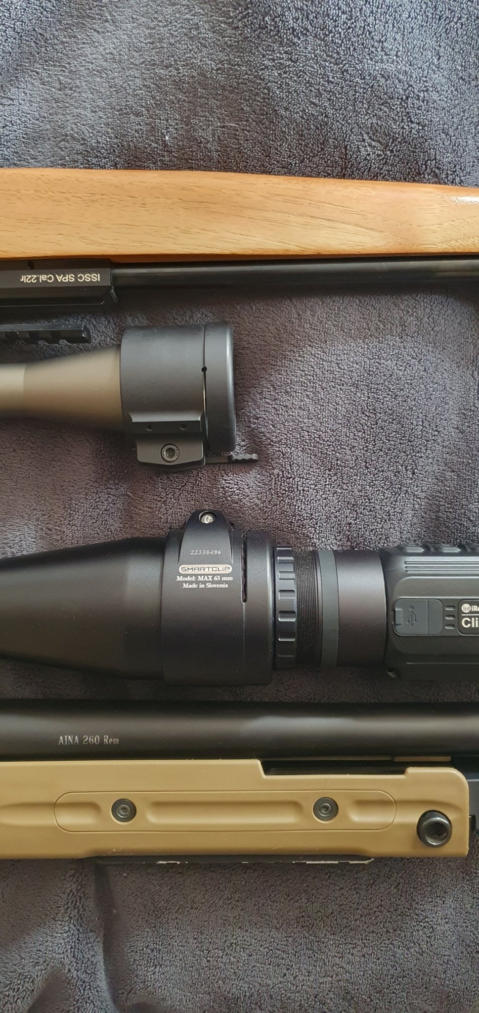

Could someone objective mounting this tell me how much room is needed underneath the unit? The HNT26 forend sits above the barrel a bit.
I think that will depend on the adaptor and/or spacers you use.
I have 2 objective mounts a no name chinese and a smartclip I just measured them both and the chinamount is .350 and the smartclip is .150
Hope that helps

Pics for reference.
The thermal doesnt protrude any further down than the chinamount on a 40mm objective for reference. The 56mm smartclip is bigger than the thermal so non issue.
