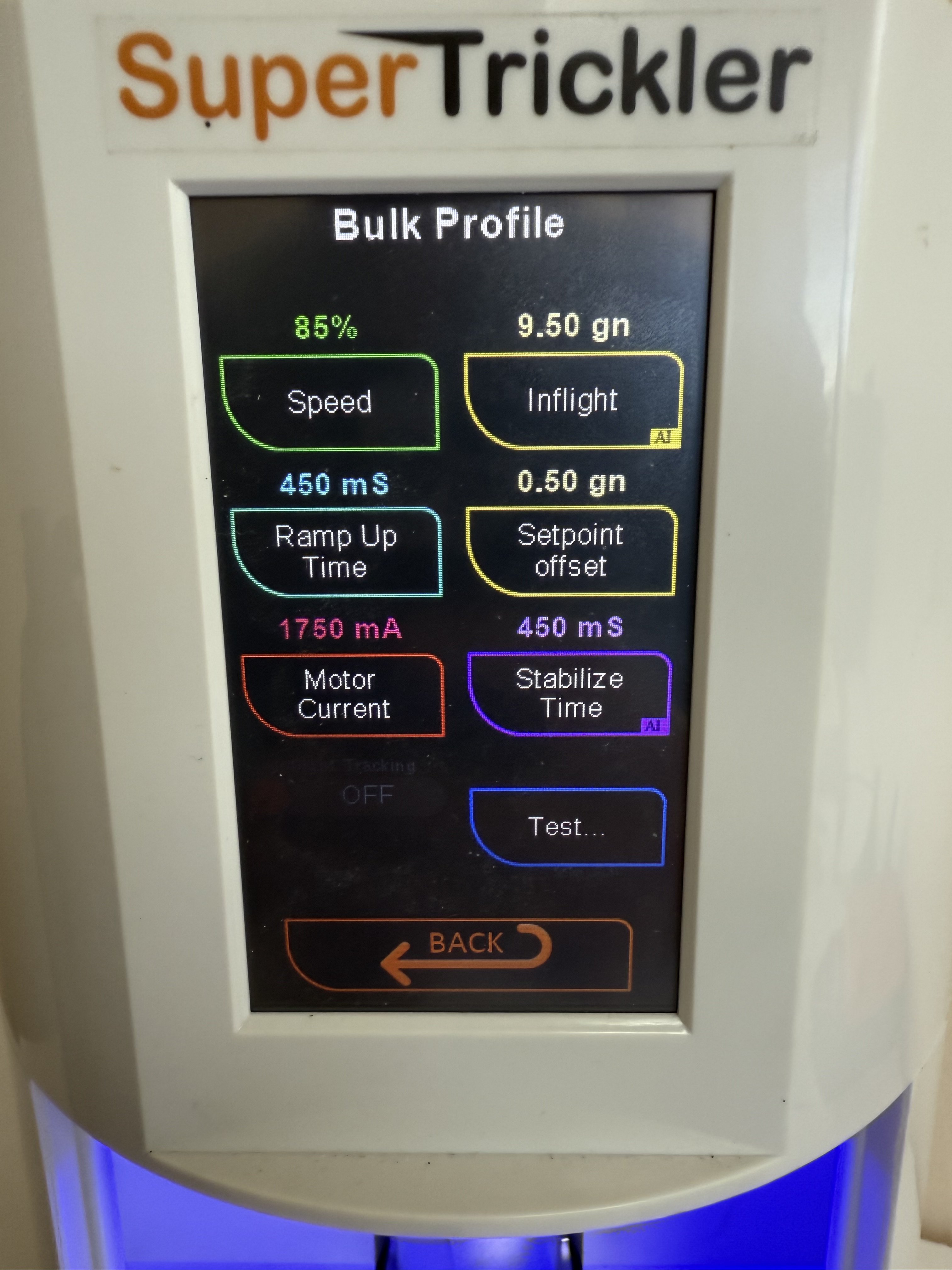

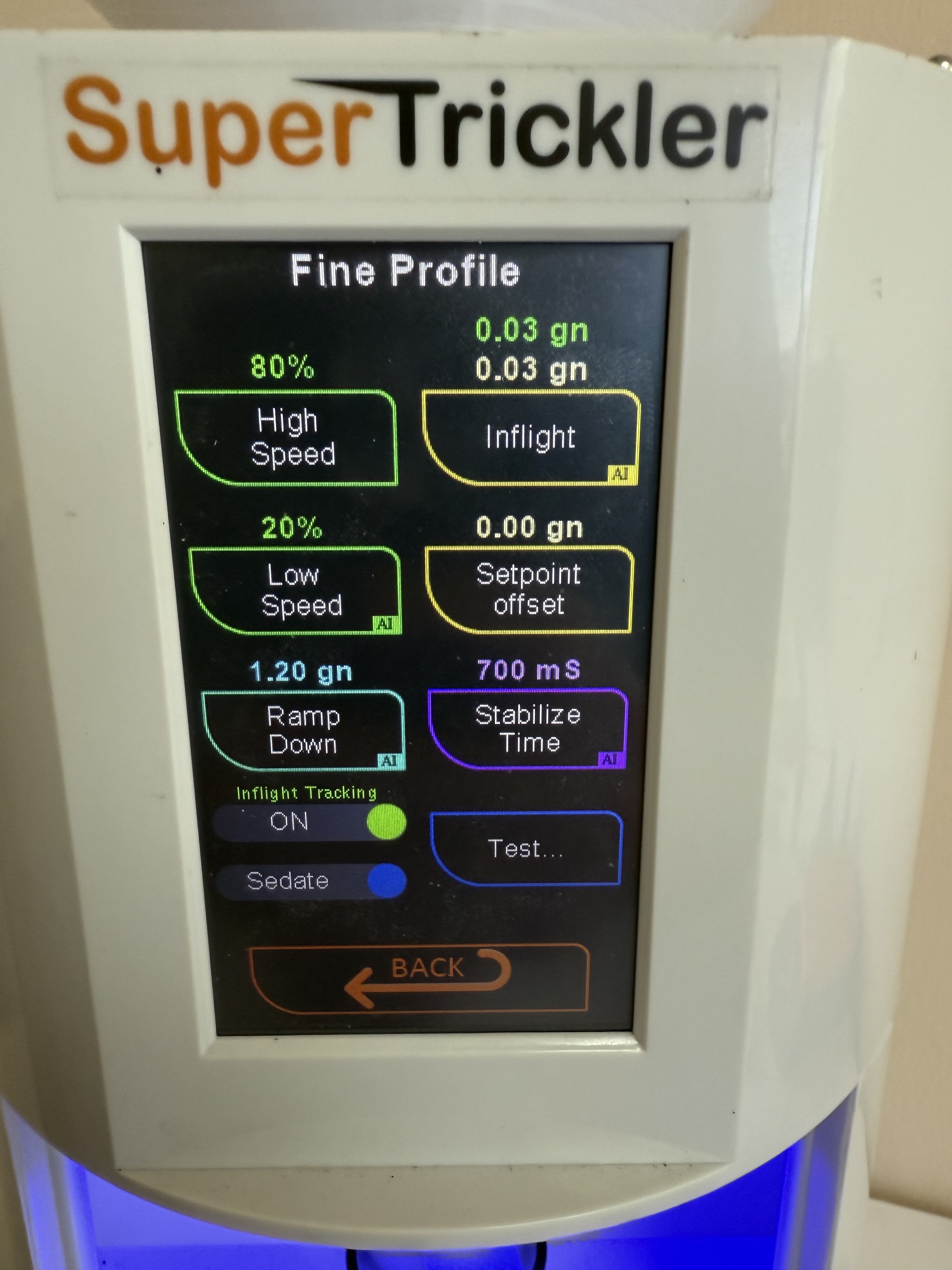

Unfortunately, you're just going to have to play with stuff until it works for you. I think these are my N150 settings. They could be improved a little, but this throws in 8.5 sec @ 85%
Varget just wants to overthrow, I gave up:

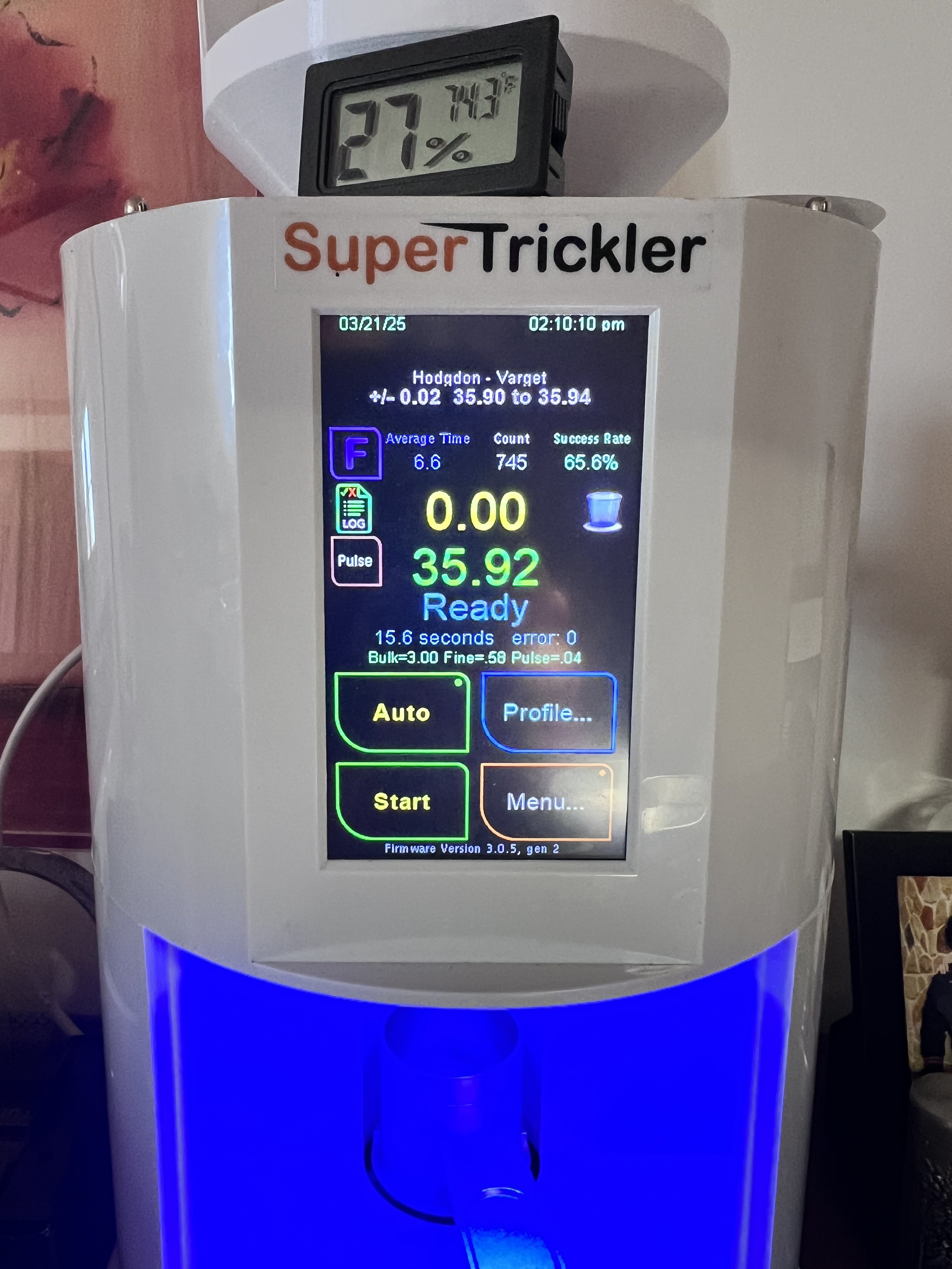

Like the others said, just kind of the nature of the beast. Iv had pretty good luck with n540 but the kernels are smaller than varget this flow better. Here’s a shot of my average varget session. Iv got the bulk dialed in pretty good but the fine adjustments need work. I load on a Dillon so waiting a little longer doesn’t bother me, but the overthrows do.
Like the others said, just kind of the nature of the beast. Iv had pretty good luck with n540 but the kernels are smaller than varget this flow better. Here’s a shot of my average varget session. Iv got the bulk dialed in pretty good but the fine adjustments need work. I load on a Dillon so waiting a little longer doesn’t bother me, but the overthrows do.View attachment 8698747

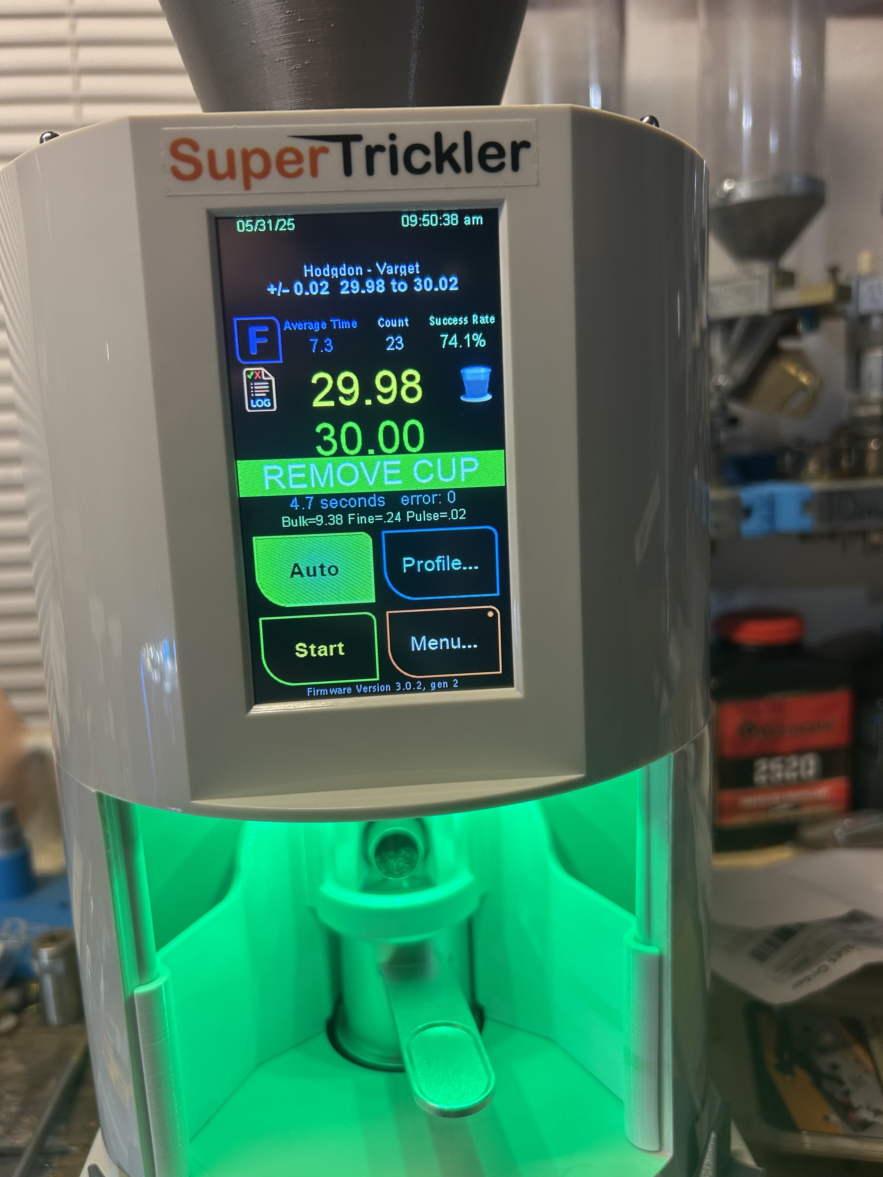

Thanks for the help y'all, I turned off the ai and just dug into the settings to really dial it in.
The current vibrator design hates large kernels like varget and 4350. The twist rate of the tube ends up making the grains orient straight and causes it to hang up and stack side by side.
Looks like the trick is to avoid pulse as much as possible. So bulk to a reliable set point below then let it do a "fine" pour right up to the line then only have to pulse .1-.2 of a grain.
Tweaking it this way it often throws to the dot in 4-5 seconds back to back and usually 10-15 seconds at 70-80 percent otherwise!!

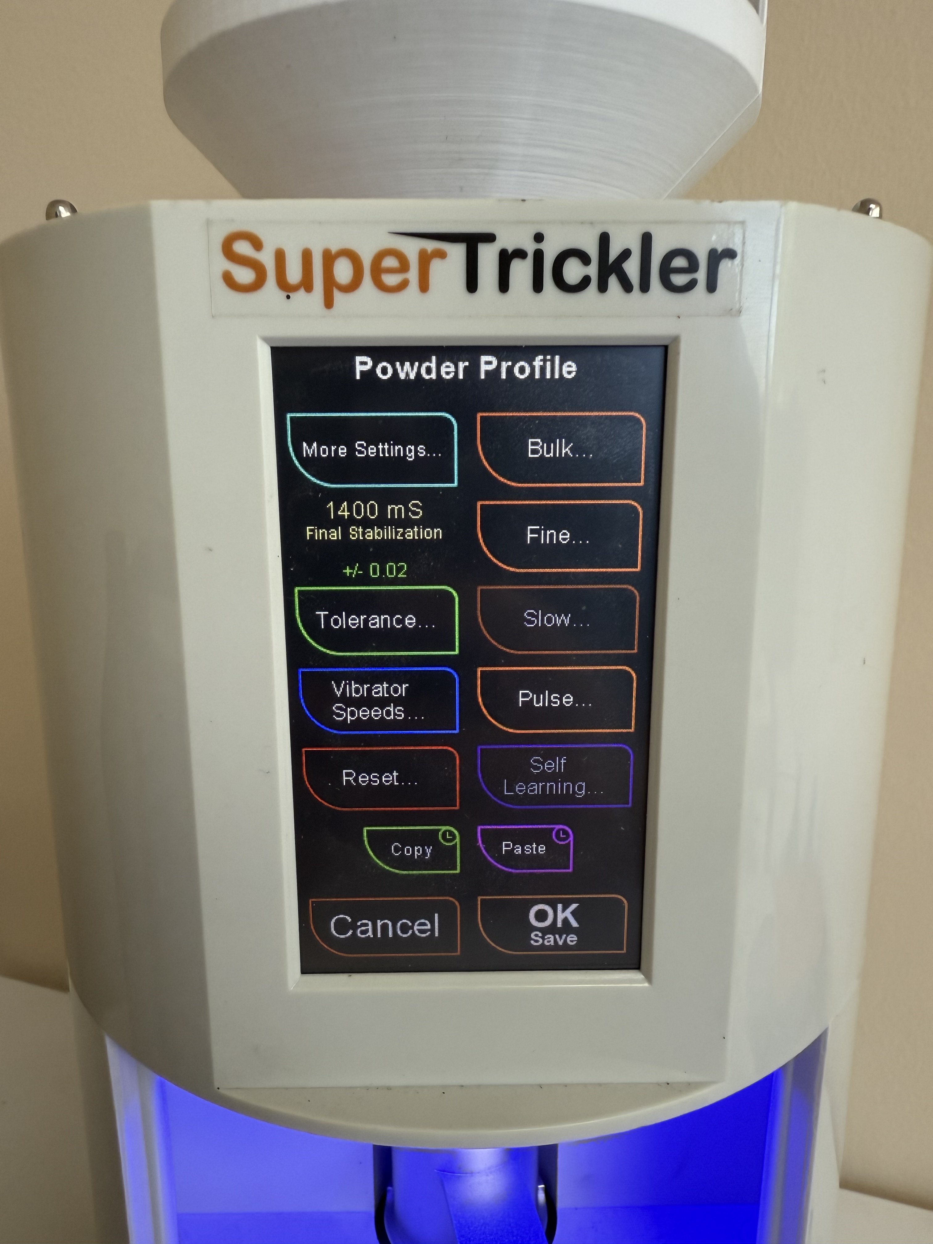

I just got my ST two days ago. Have done the AI. I use mainly 4350. I've read about shutting off pulse, could you please share the steps to shut it off. Be gentle, I'm a total ST newby. Thanks.
