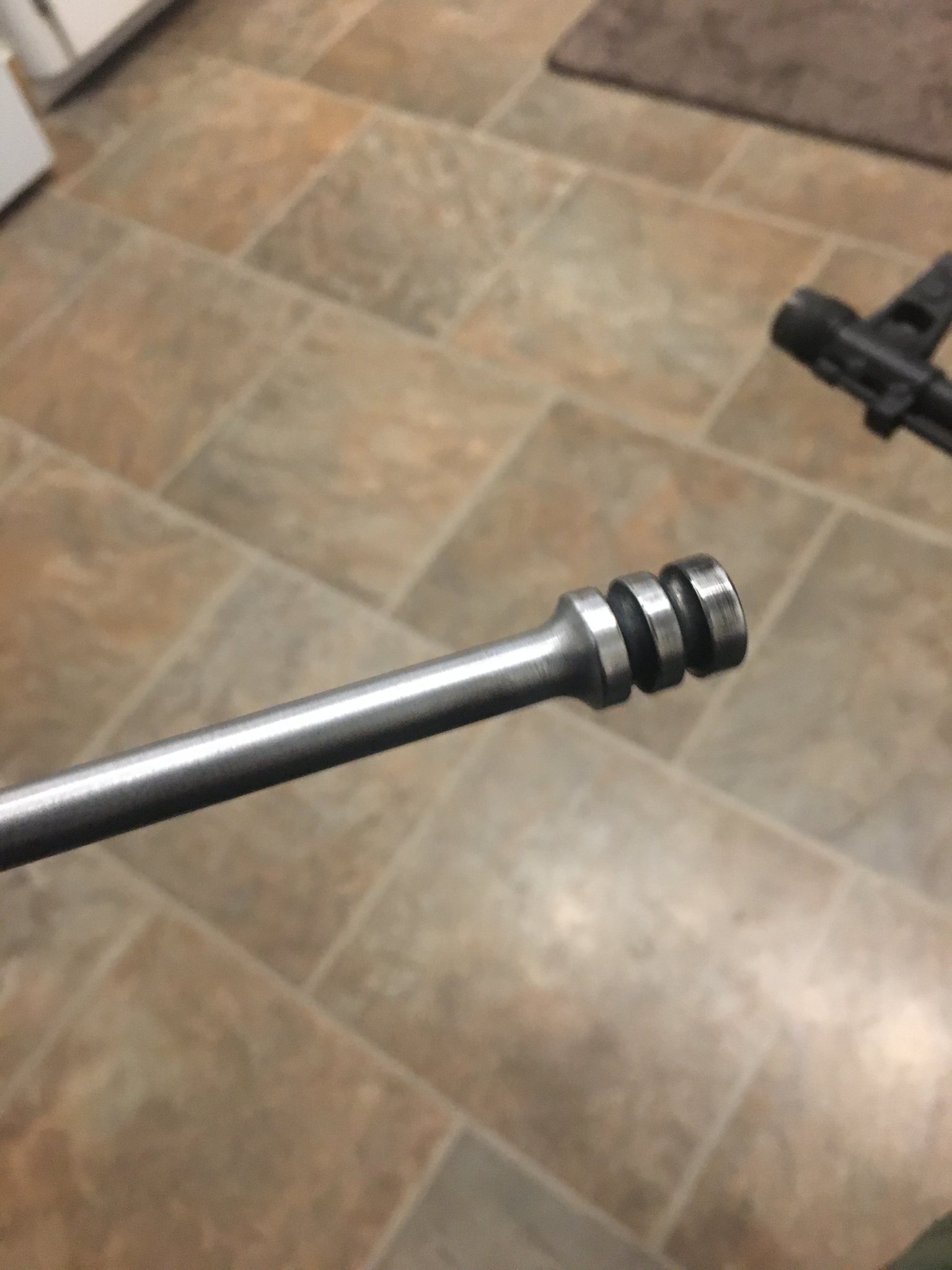

I have some stuff that I make because all the stuff we used in the military didn't hold up. I make a slightly different version for piston driven guns. This is what an AK piston looks like after 700 rounds while using that stuff. No lube was applied other than at the start the range session and the piston was given one wipe with a paper napkin after I disassembled the gun. The piston was still wet and the lube hadn't burned off. You can dip a small steel rod in the lube and then hold it in the flame of a propane torch and it won't start smoking for a really long time. Most gun lubes burn off WAY too easily. This is why you are having problems with your lube not lasting when you are running a suppressor. The gas that goes into your bolt carrier is around 400 deg F.
I specifically designed this stuff for a DD MK18 with a can on it. It works great in maritime environments, too.
