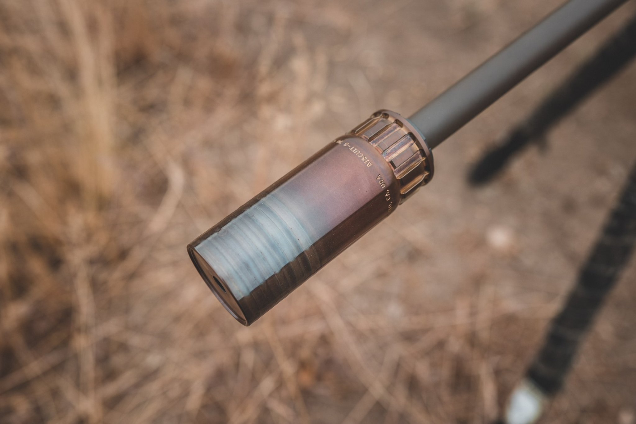

I was looking for something similar, and I went with an Abel Co Biscuit. It's a great can, and the guys at Abel are awesome. It does a decent job of noise suppression, it performs similarly to my wife's SiCo Omega. Low backpressure, so it works great on ar15's (not gassy). The recoil impulse is awesome. Hard use can, so it can survive most firing schedules you can throw its way on an ar15. HUB so you can use whatever mount of your choice. It's also not too expensive.
The downsides are its heavy for its size (all 17-4 SS), and doesn't suppress large cartridges well. If you are shooting only short action cartridges, it should work great. If you are shooting something like a .300WM from your AI, you may want a bigger volume can.

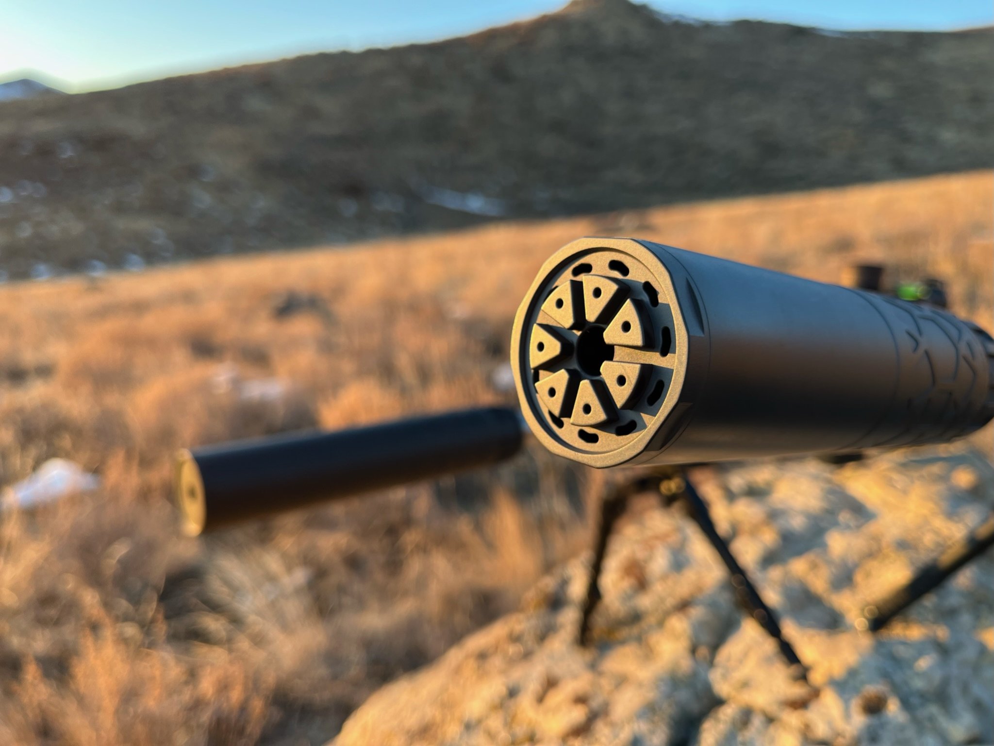

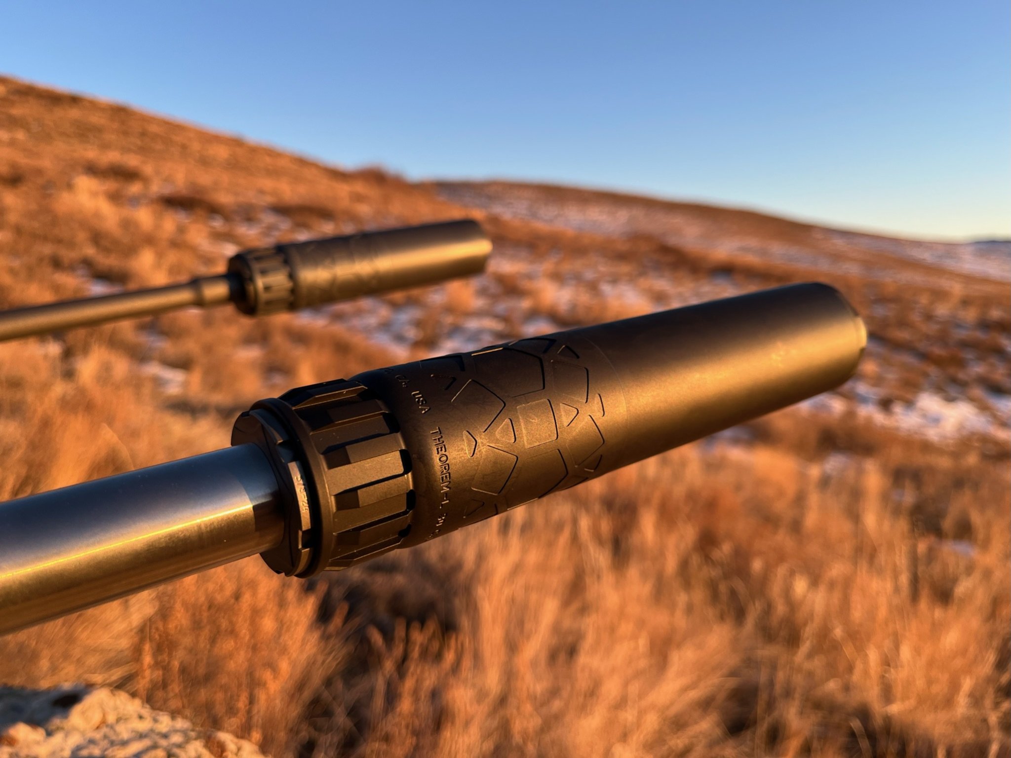

Look at the Abel Theorem L.
You might also find the vented cap does make the impulse off the bolt gun a bit shallower into the shoulder in my own personal experience shooting a short theorem vented in 6.5cm. And on the AR side cut a bit of the back pressure. You're compromising very little on both ends with the Theorem if you re set on getting a “double duty” can.
pretty light for class and solid suppression per inch.
And also, available with probably minimal to no wait direct from Abel.
Reactions: HD1911 and kthomas
It ain't the hide if personal bias doesn't derail an otherwise pretty legit technical discussion.
@chopit both companies have good manufacturing know how driving their can design / accessories.
However if you're seeking versatility which it seems you are, Theorems have a edge there. I have a bunch of Abel and TBAC and being able to switch from a cal specific end cap to a vented 30 for gas gun use is valuable.
Id reach out to @hic28 for more detailed info on the options and availability of theorems and bisquits. He's not the owner but is real close with Abel.
