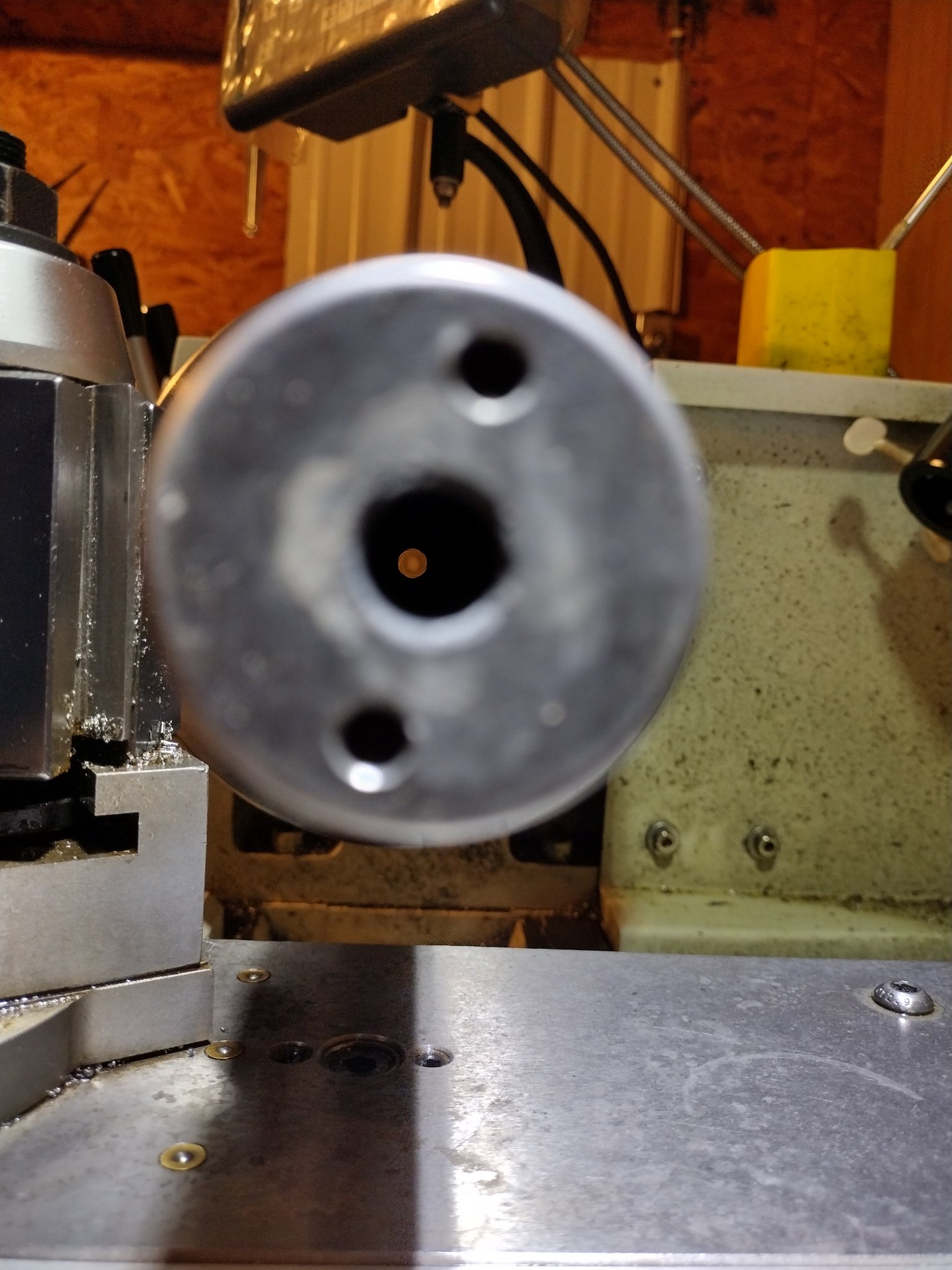

Hello everyone,
My HUXWRX 7.62 Ti finally got approved. Checking the alignment for one of my guns with a Geissele alignment rod, it seems very questionable.
Technically it's not touching the edge but it's far from centered. How centered does the rod need to be to avoid any issues?
I don't want to damage the suppressor I waited 9 1/2 months for.

Do these alignment rods fit nice and snug in the bore or is there some wobble? I haven't used one. I just visually look down the bore with a light in the breech. It's obvious if it's centered with just a visual inspection. I have seen one that wasn't centered and was causing end cap strikes and that was also very easy to see with just a visual inspection.
It's nice and snug and appears to be visually good, thanks.
I have one can that looks like your picture. The rest are basically centered up. It's a .30 cal can and accuracy does suffer when shooting anything .30 cal, .264 and .223 shoot fine. It turned my .75" groups into 1.5" shooting my 308 bolt gun.
