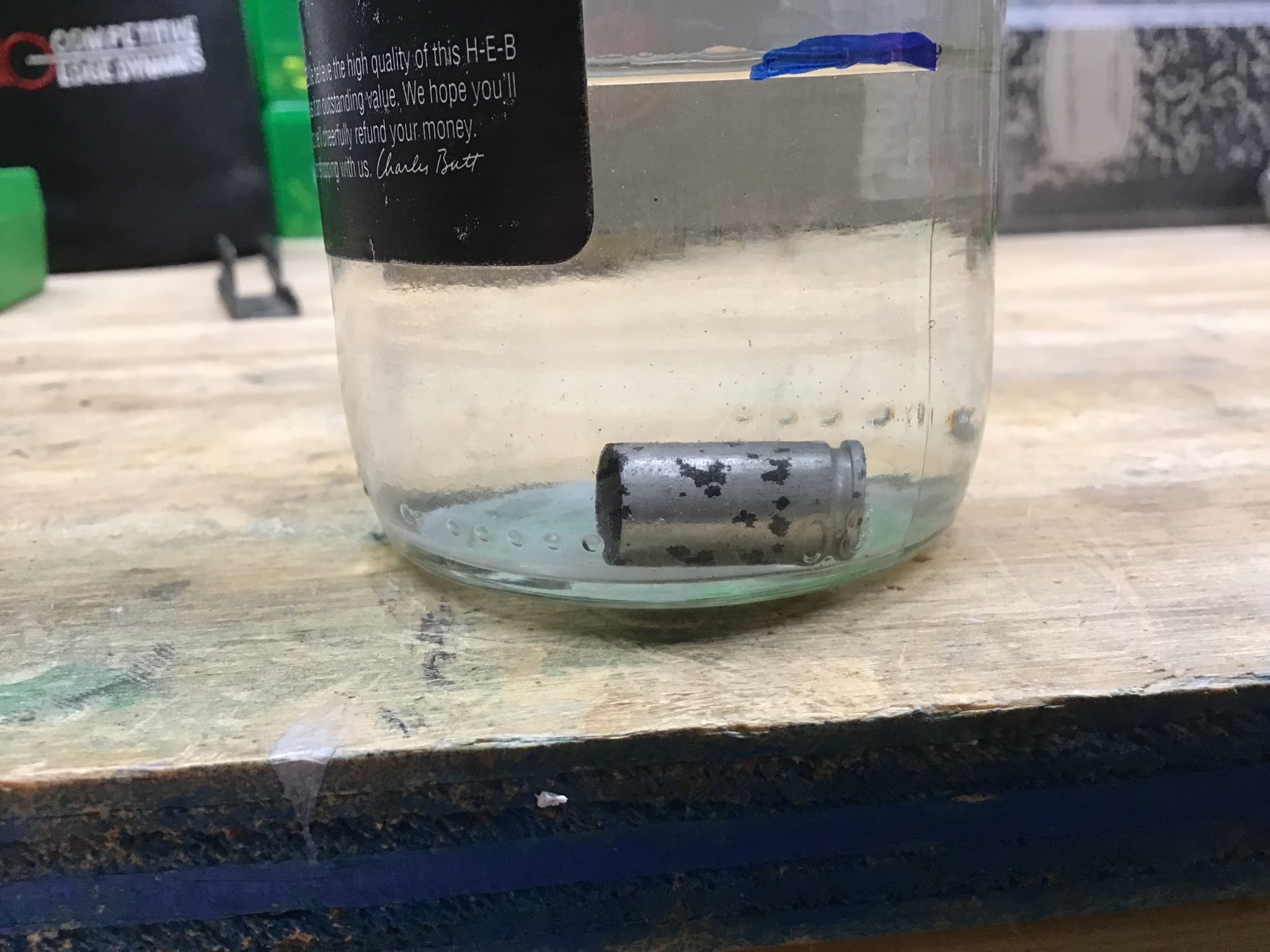

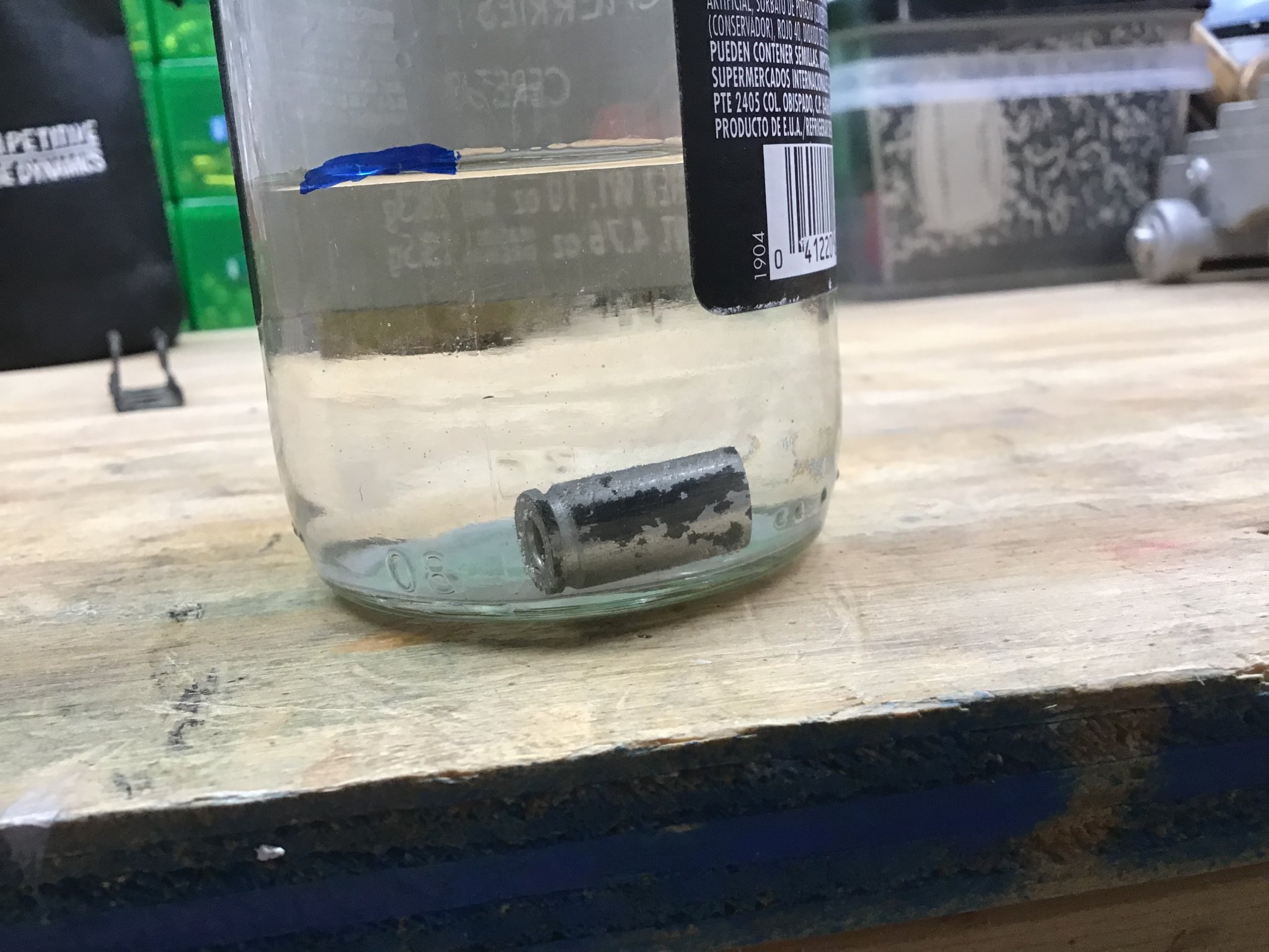

Ewoaf & all,
I made up a few ounces of “the dip” and the only aluminum I had laying around was a single 9mm Blazer case. I took the side of my knife and scraped down to bare metal..I’m sure there’s some kinda coating on them. And chucked it in the stuff.
overnight: just bubbles on all the case
-2 days: the scraped area shows black blotches, the rest of the case is normal
-3 days: same black blotches that seem to have gotten a little bigger, nothing more than a few flakes of pepper on the table, I can only think it’s where the peroxide or acid in the vinegar has begun eating the aluminum.
-today is day 5: the case is speckled all over like a cheetah.
so I guess it’s not good for the aluminum, but it’s certainly not gonna dissolve a baffle into dust for an overnight bath in it.
Reactions: ewoaf
Bravo Zulu for the fine empirical study of how proxy acetic acid magically melts Al. I can't recall if I ever did a 4 hr soaks or an overnight soak, but either way I don't think I ever got beyond the gunk. It's definitely less destructive than shooting through one. Hope it helps. Lead is a PITA without it.
