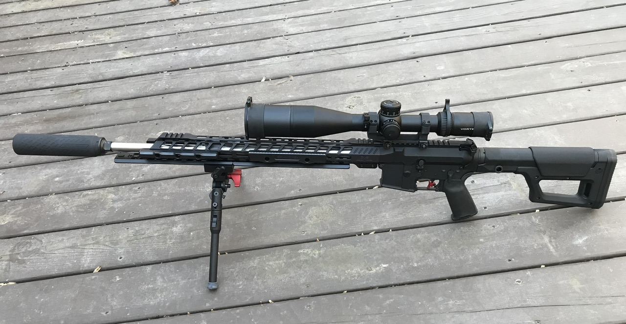

ETA a pic of my B&T 762 Inconel on my 22” 6ARC for size reference. That’s with the DT mount it came with but it wears a Xeno mount now about a 1/2” shorter.

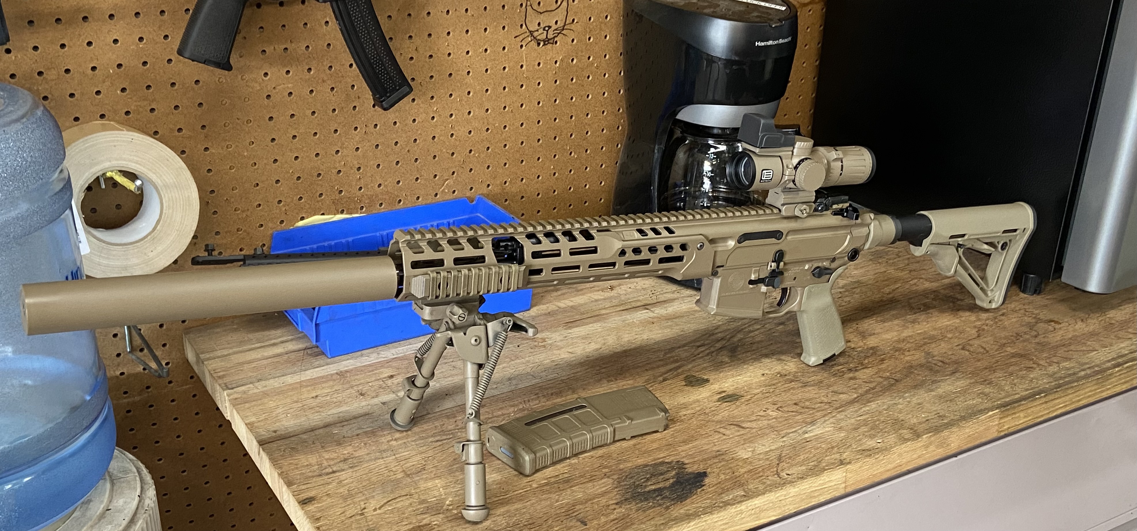

I use an Abel Biscuit with my AR-15's. They definitely have less back pressure than a SiCo Omega, another can I've used on the same rifles.
Quality is top notch. Sound suppression is pretty good for being a shorter can. The guys are Abel are awesome.
I'm using a .30 cal version of the Biscuit, but they've since come out with a .556 specific biscuit.
