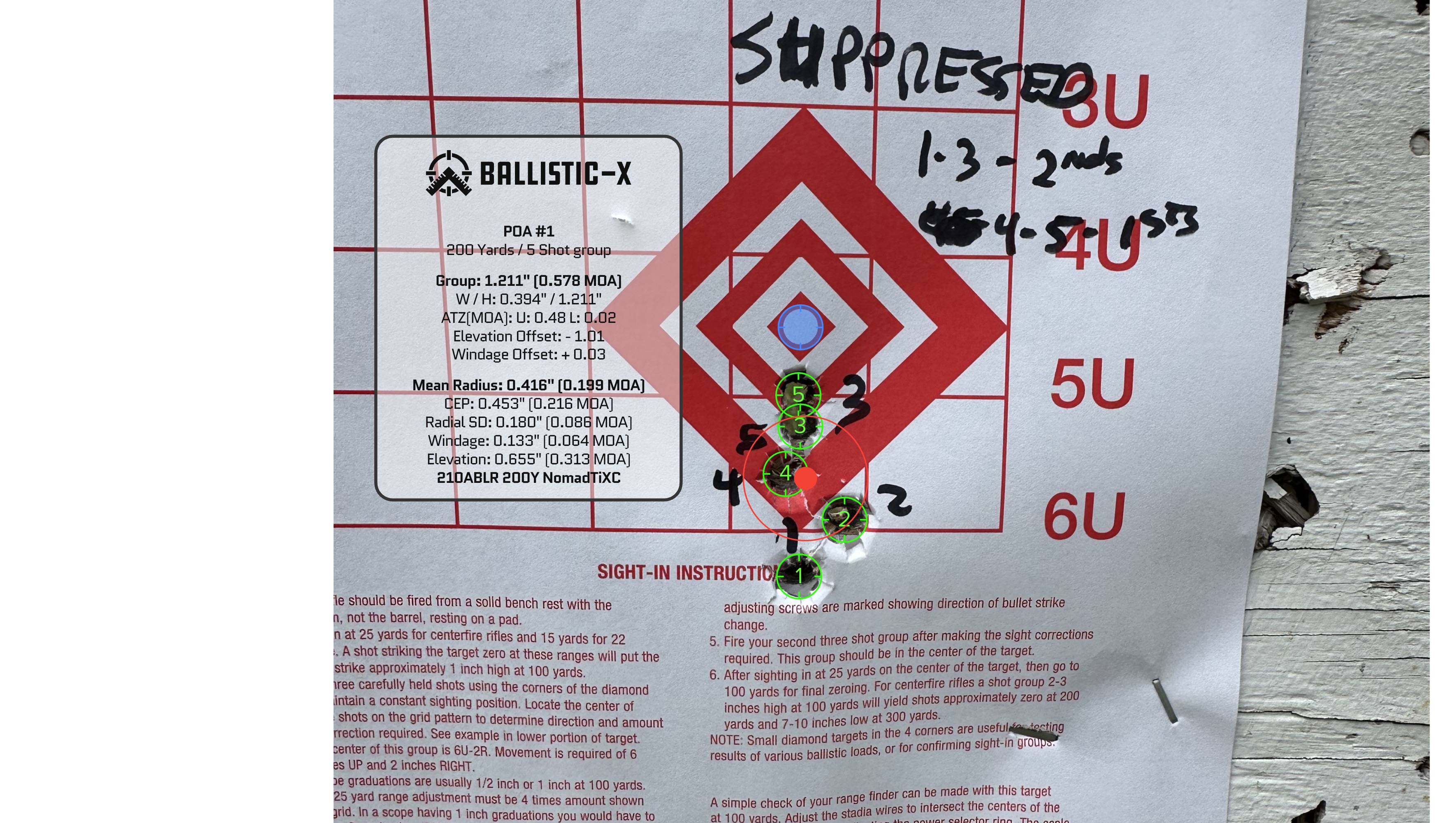

    How do I make it shoot the same group size not suppressed as suppressed? Obviously, removing the Aera 419 Hellfire is a good start. Perhaps I should try it without a muzzle device? I could also try it with a 2A Arms titanium brake as well as its lighter and might have better barrel harmonics. Any other ideas as to how best accomplish this? Pics below show how much better it shoots with the suppressor.
    Groups shot at 200 yards:

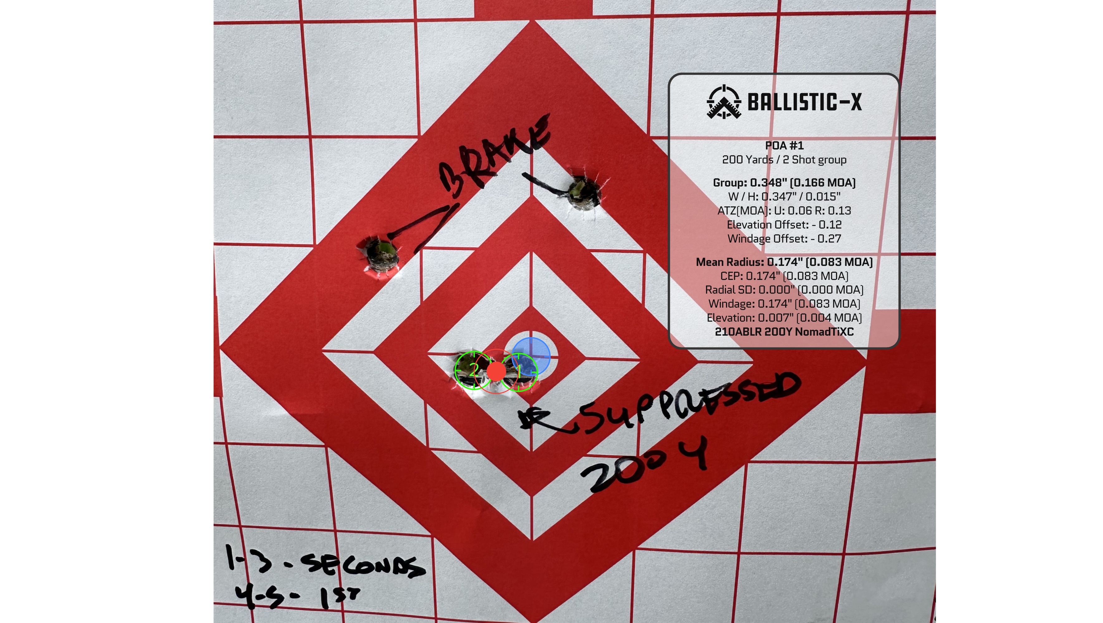

    With 419 brake:
    With suppressor:
    Adjusted scope up 2 clicks. The group with the brake is .802 moa, quite a bit larger than the suppressed group.

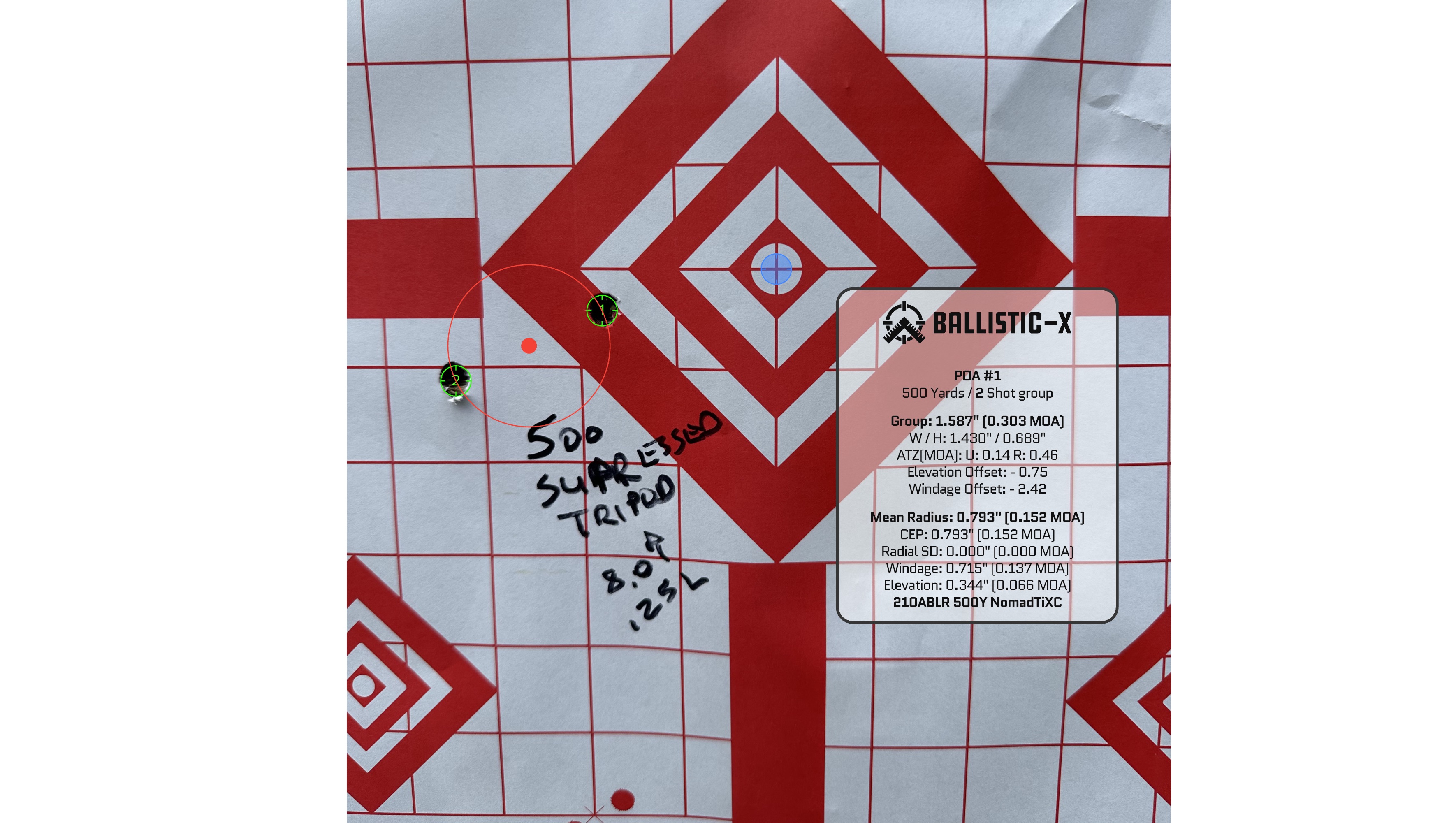

    500 yard group off tripod suppressed. The wind was calm and my Kestrel 5700 link with AB suggested .25 min left adjustment, obviously wrong, I need to sort that out.

    It is a weight at the end of a barrel that effects harmonics. Frequently it helps, sometimes it doesn't.
    I think suppressors help the shooter more, or at least those that are recoil and concussion sensitive.
    Brakes can also negatively affect accuracy. In your case, I agree that might be what you're seeing.
    You change the tune of the barrel in a huge way when you add/remove a brake/suppressor etc. Some barrels/loads care less than others. My only advice if you want it to shoot the same with/without the suppressor is to tune your load with the suppressor on, and then try using a tuner brake like the Cortina brake to tune the rifle without the suppressor. Hopefully you can adjust the tuner to get the rifle shooting well and then just leave your tuner setting alone when you add/remove the tuner from the rifle.
    Or develop 2 loads, suppressed load, unsuppressed load. Probably not what you want to have to do though.
