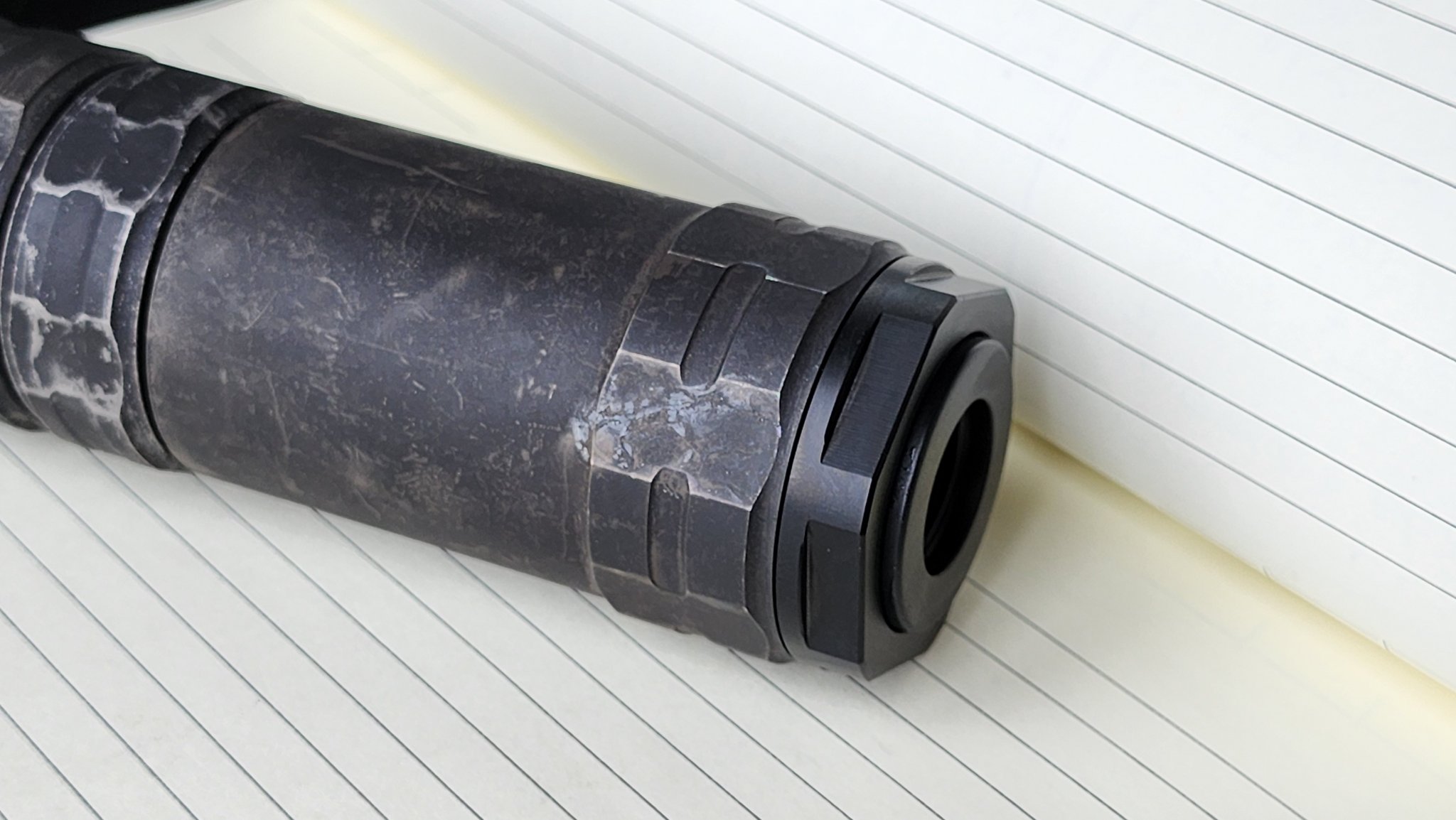

This is not true. Energetic Armament makes an adapter for HUB suppressors:
Very nicely made, titanium. I have one.
Mounted on my Liberty Precision Machine Anthem S:
Mounted on another one of my cans with CB Brake inside of it:
Mount on the right with TBAC CB Brake:
Reactions: Raffy and kthomas

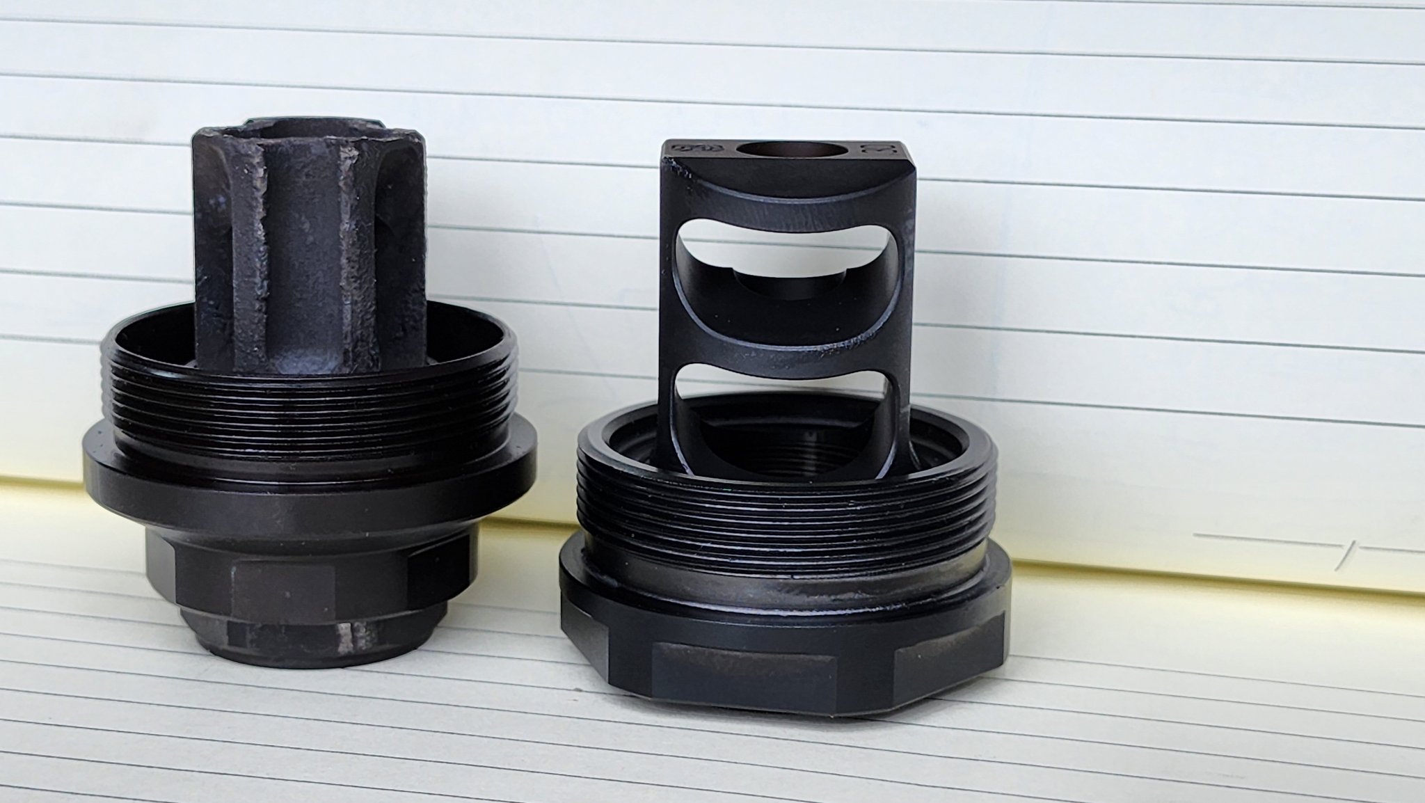

Correct, the flats on the barrel and can mount touch, the taper on the barrel mount interfaces with the oring in the can mount to keep the soot off the threads and surface.
How well does the system seal the carbon away from the threads? How bad is the job of keeping it maintained vs a tapered system in front of the threads?
Spife are you running your can on your barrel the entire time between cleaning without taking it off? How many rounds are you going in between?
I take it off after every session. Clean every few hundred. You don’t have the clean the hex though. It just looks nicer. No idea how much build up it would take to impede function.
