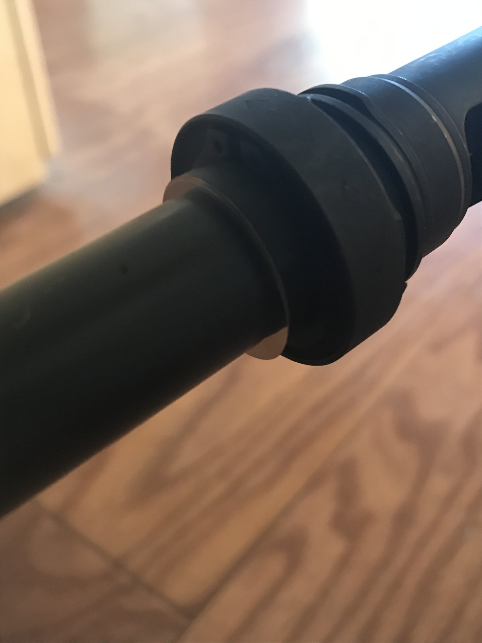

Hello all I’m currently waiting on my first can to arrive in another 5-6 months. In the mean time I’ve been ordering quick detach mounts for a few rifles, most of which are brakes that need to be timed. What are you guys using for shims or are you sending the rifle off to be mated? I absolutely hate the mfg’s stainless shims that are way to large for my barrel. I’ve thought about a matte black crush washer with loctite but am unsure. Any advice here? Also threads are 5/8”.

Self timing QD muzzle breaks. Or I use the shims that come with my Rugged mounts. Or spend the money and have your barrel timed to your break... lots of options. Dont use crush washers
I have this issue with my Bergara HMR.. The shims are larger than the shoulder on the muzzle threads.. causes weird issues if Im not super careful.
I would love to find a peel washer or set of shims that have a smaller OD.
Oh I have the shim set that came with the brake. It’s just that they are larger than the brake in diameter. And stick out like a sore thumb.

I believe I have found a solution. Down range products offers a black stainless kit that has an outside diameter of .748”. They also offer a kit that is .810” in diameter.
