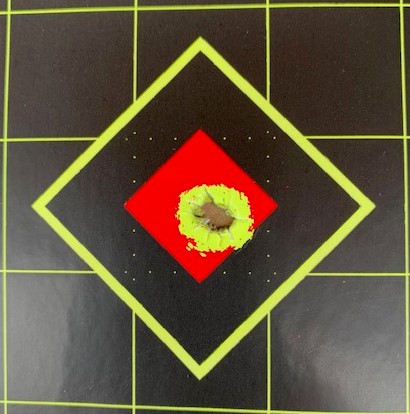

    I continue testing, and am currently still undecided. I put two APA Gen-3 Fat Bastards on my Barrett MRAD barrels (300-WM and 338-L), and I have a Gen-3 Little Bastard on a Tikka T3x TAC A1 (6.5-CM). Concussion is impressive ... but recoil and target re-acquisition are awesome, especially on the MRAD. That said, after a few rounds, I get used to the concussion and noise, and stop flinching or closing my eyes in anticipation. Put 4 shots through the same hole at 100 yards with the MRAD (300-WM barrel) running the APA Fat Bastard on Friday (photo below). Still using my SC Chimera-300 suppressor on two other rifles (MPA 300-WM and LWRCI 6.5-CM) and enjoying the peace and quiet but not liking the recoil on the MPA 300-WM. LWRCI is a piston-driven gas gun so recoil is minimal either way. With the APA Fat Bastard, my 338 Lapua MRAD has almost no recoil ... it's an awesome brake for big bore guns.
    My Chimera-300 suppressor is standard equipment on a bunch of gas-guns I use for shorter distances (223's, 300-BLK's, 224 Valkyrie, 6.5 Grendel). They all have ASR brakes for easy on/off. Same with a few sub-guns I always shoot suppressed (SIG MPX (9mm), SIG Rattler (300-BLK), and LWRCI SMG-45).
    (Yes ... I know ... I have too many guns ... you sound like my wife.)
    Another consideration in the "Brake vs. Suppressor" debate really has to be "cleaning". Everything gets way dirtier way faster with a suppressor, especially the chambers, bolt carrier groups, and lowers/triggers on gas guns. I can see how carbon rings and throat buildup could be a problem much earlier with suppressors. It makes me wonder if suppressors actually decrease barrel life expectancy due to all that back-pressure and rearward carbon.
    Anybody know whether that's the case, or not?
    For me, this is still an unsolved riddle shrouded in nuance, paradox, trade-offs, personal preference, and continued testing.
    So far, I've learned that the answer is ... there's no clear answer.
