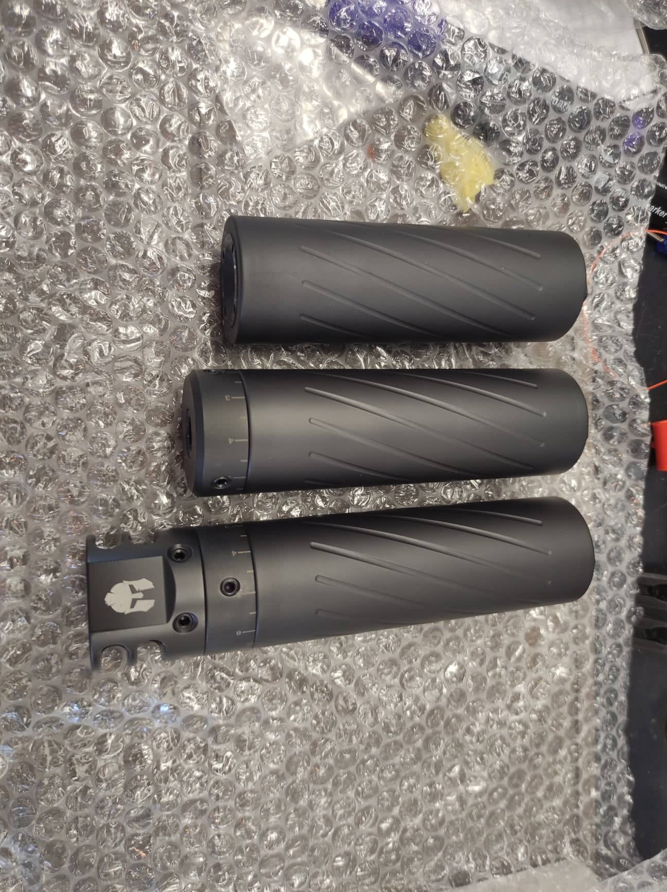

Guwarrior head honcho is one of the world's top PRS shooters and the company makes chassis, brakes, suppressors etc at competitve prices .
I am importing a bunch of their products shortly if the UPS doesn't screw it up.
Was just trolling through their website. Very nice stuff. Sent a link on to an SA friend of mine.
Suppressors with muzzle brakes and tuners on them
South African Gunwarrior
Wow, even with a tuner!

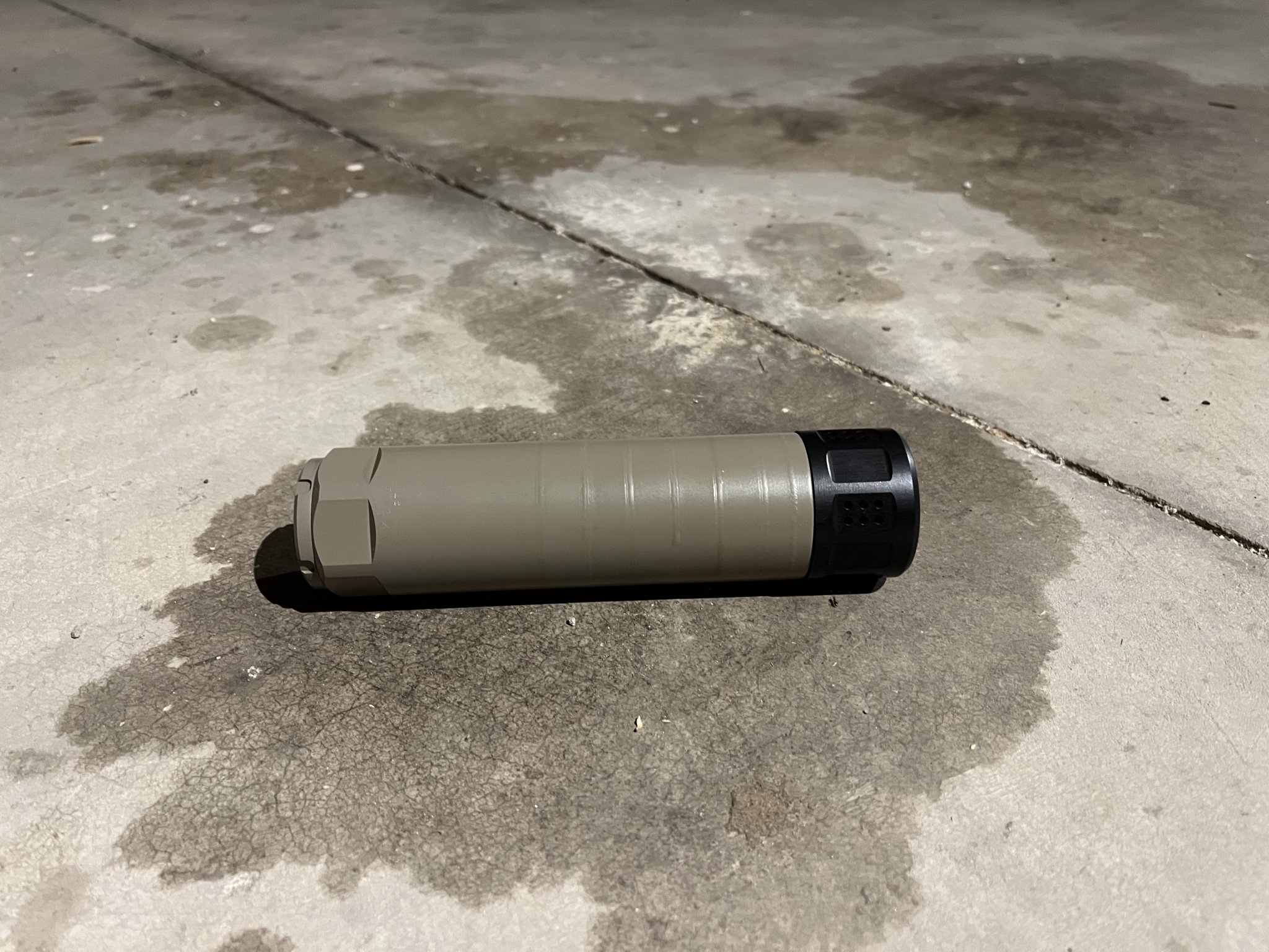

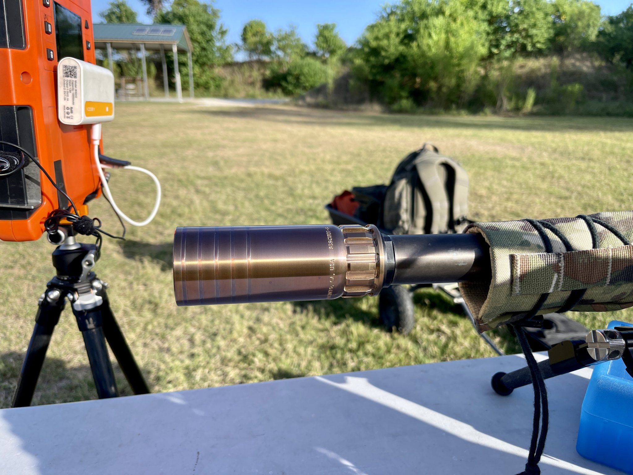

I can only directly compare 7" Ultra & 7" SiCo Omega with brake at end shooting
Overall, I think the Ultra is the better can and would recommend it over the Omega. (go CB mount)
That said, the Omega recoils slightly less than the Ultra shooting the same .223 ammo (69gr SMK) out of a 24" barrel.
I assumed it was a gimmick, but I think it works.
Very noticeable difference between bare muzzle .308 vs Omega w/ brake on it as well.
The Omega 300 Anchor Brake works really well. I have an A-Bolt 3 in 300WM (7lb naked, 10 lb w/ bipod, scope, etc) that kicks hard without any muzzle device. With a brake, it is more tame but my face still feels the concussion.
The Omega 300 turns that recoil into a longer slower push, no concussive blast/force, and reduced recoil. Another person a few stalls down at the range had an Omega 300 as well and his muzzle report was like someone slapping a heavy phone book on the table. It was far far nicer to shoot. I couldn't believe it was the same 300WM rifle.
My Omega 36M doesn't have the anchor brake, and the rifle still kicks pretty hard although not as fast.
The Omega 36M and Omega 300 are similar in size/shape and number of baffles (Omega 36M has 1 additional baffle and is slightly longer).
I am not sure about longer cans (TBAC Magnus) or cans with more baffles (e.g. OCL Hydrogen S), although I am tending to think those won't cut down much recoil versus the Omega 36M.
I suspect the people that feel the Anchor Brake is a gimmick are shooting lightweight calibers. I have heard the Anchor Brake works more and more effectively with bigger magnum cartridges.
