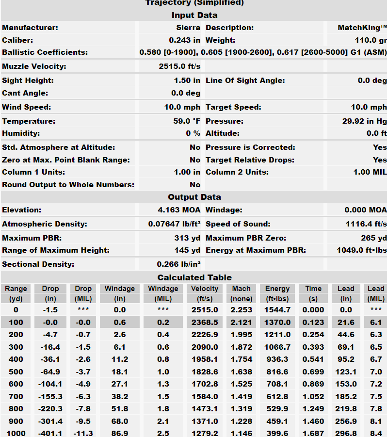

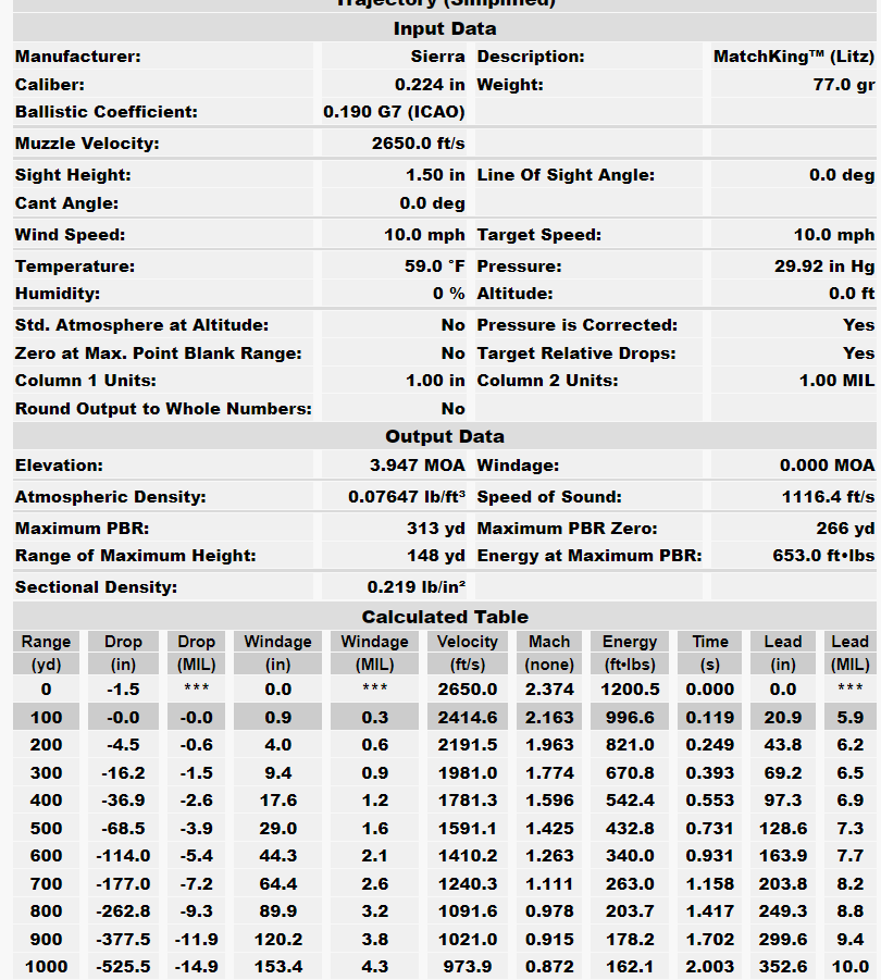

Are you shooting Berger 80.5gr Full Bores from 5.56?
77gr SMK doesn’t do so well in the wind compared to 6.5 Grendel and 6mm AR/6mm ARC. It’s better than 55gr or 62gr. The one that really surprised me was a guy who showed up with 75gr A-MAXs stuffed into 5.56 cases with the necks crimped over the ogive. Ha ha
