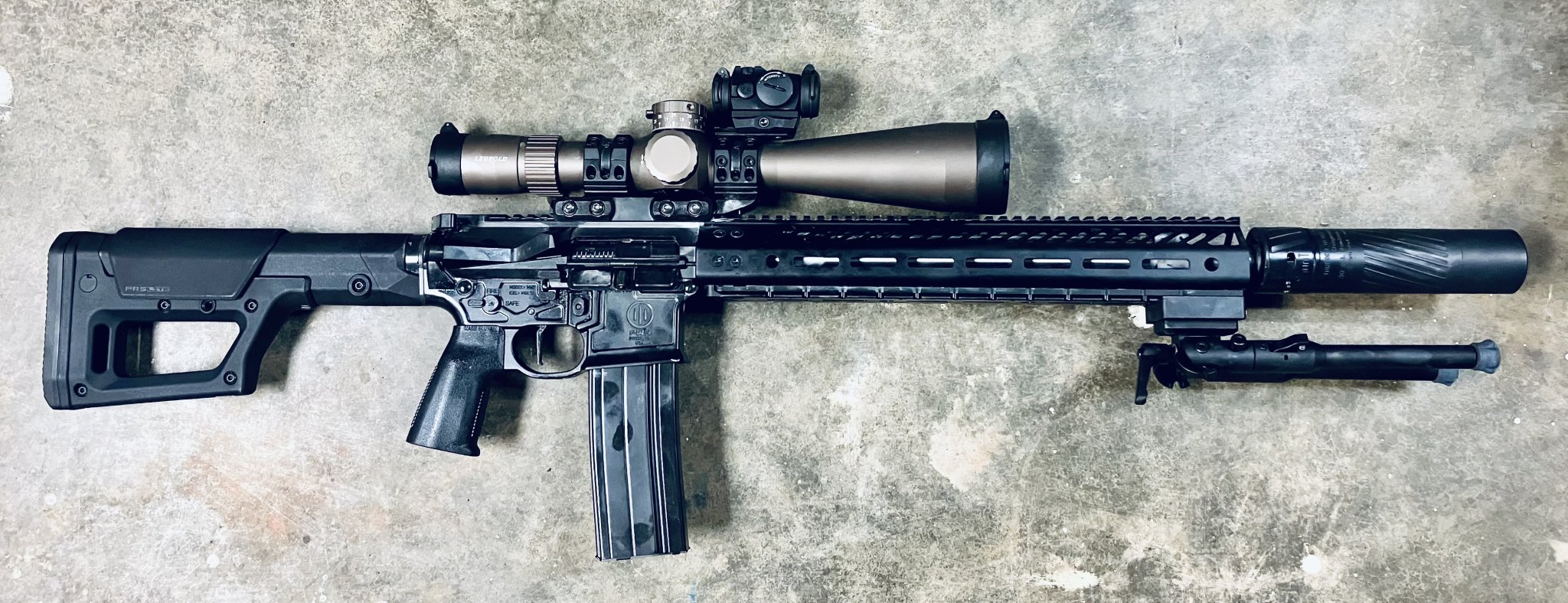

I actually dipped my toes in the water with 6.5 Grendel first using this in 2009, as I could just drop the barrel in and give it whirl.
I modified my MGI Gen I upper by machining off the 3 & 9 o’clock rails, cut vent slots in it, and profiled the locking lever shafts to be flush with the top of the handguard. Cerakoted it all Coyote Tan.
I later just installed my 1st 16" Grendel barrel in a normal upper.
