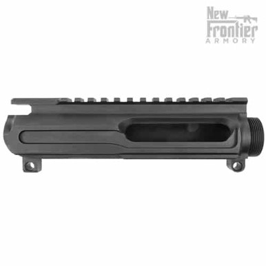

I might be wrong, but I was under the impression that the Six8 lowers will work with standard AR15 uppers.
You need a different upper with wider walls around the feed ramps, since the Six8 PMAGs are significantly wider.
The LWRC and New Frontier Armory uppers and lowers are different than standard AR-15 receiver sets for this reason.
LWRC and NFA do allow standard barrels and BCGs to be used in them.

It isn't sole-source. New Frontier has receivers. With SF and PSA entering the fray you'll probably see more this year.
