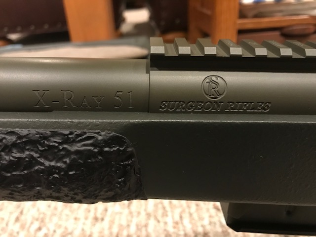

I love my Surgeon 591SA CSR barreled action. Won’t be giving it up. Waiting for new scope to be released then this build will be done.

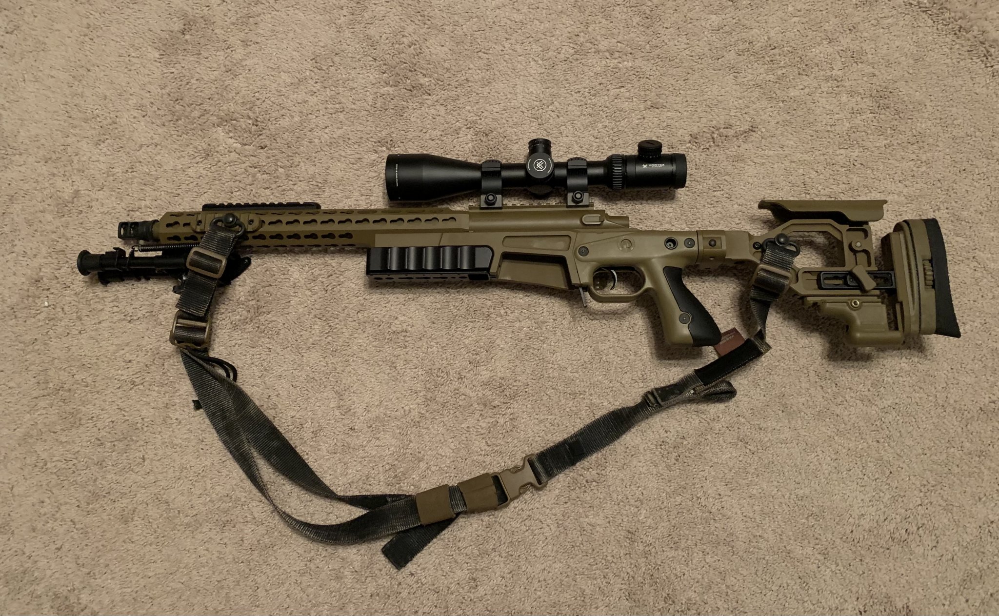

I have a Surgeon 591R that I won off a prize table 2013 in my first precision rifle match. That rifle then took 1st in the U.S. Army International Sniper Comp the following year.
Hands down, that rifle will go to my grave with me, she a mean bitch. I’ve seen a few more Surgeon’s over the years teaching and I’ve never seen one disappoint. I know that their CS sucked for a while and sure there are some pretty neat other actions out there but I’d say you’d be hard pressed to prove that a Surgeon action is “obsolete“.
