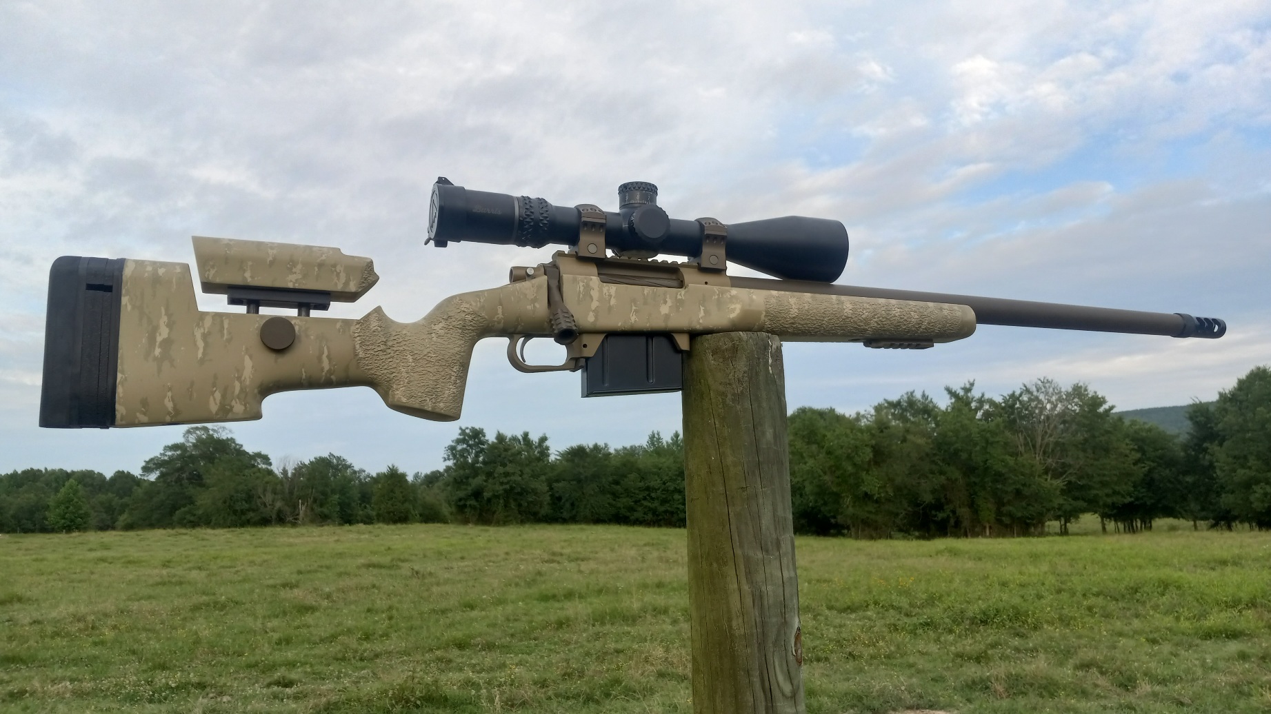

Sorry, but I pick my action, then I find a stock that fits, that I like and I go from there. I like the shrouded Bolt release, so I bought into Impact. This not a race for the lowest common denominator, it is a quest for the best precision rifle. Of course people also have their preferences so we have choices and choices are good.
Proud owner of a Gradous 1086 surgeon switch barrel!🤗
In the process of turning my 1086 into a switch barrel as well.
*edited: my 'pics or it didn't happen'. Currently wearing a 24" 300WM barrel. Just bought my Manson 7/300 PRC reamer for barrel #2.
