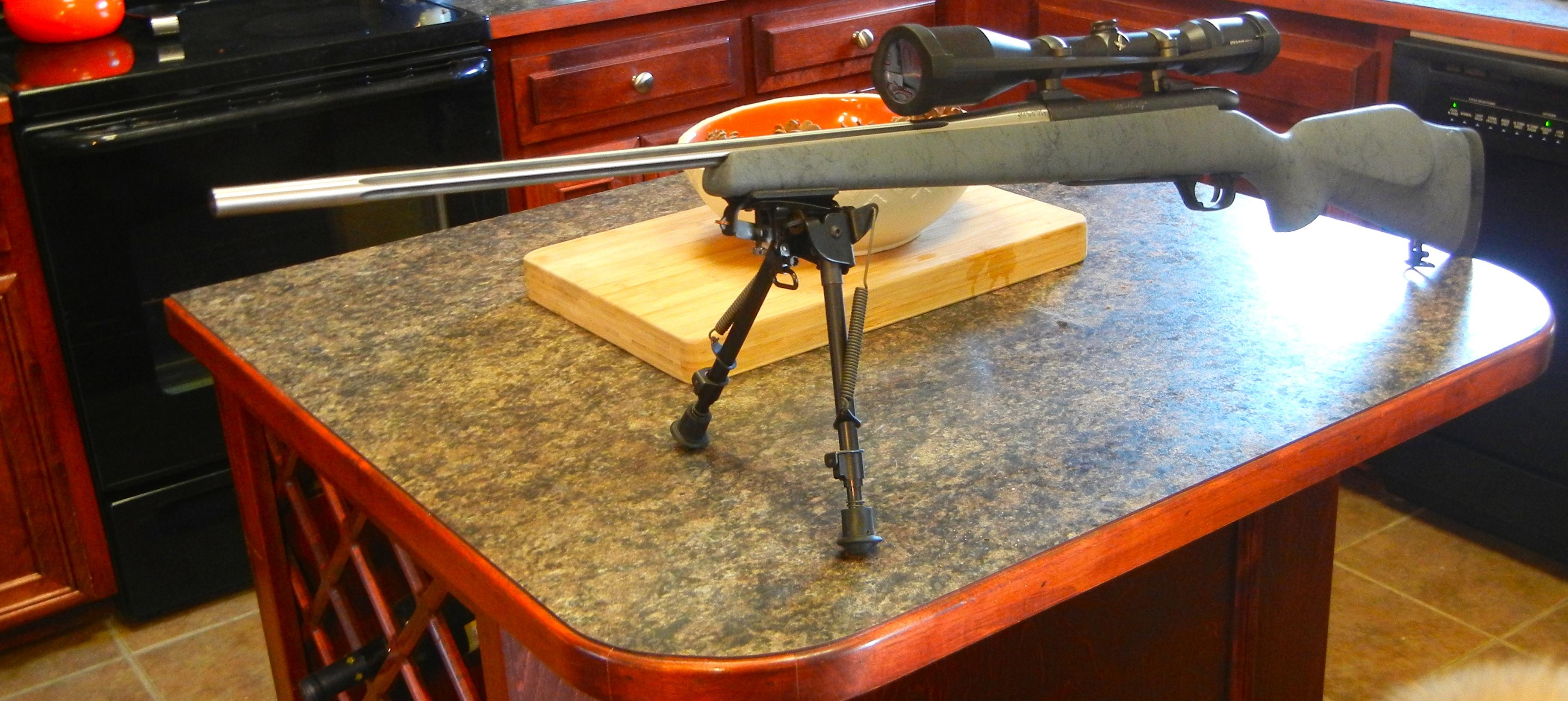

Hello Everybody,
I am brand new to the sport of long-range (mostly a bow hunter kinda guy) and I am overwhelmed with all the information I've Googled, Binged, and Yahoo'd but thank goodness I was recommended to this forum by a friend. First of all, I really appreciate everything I've found here but so far I haven't found anything on my scope (Swarovski Habicht 3-12x50). Long story short, I picked up a Weatherby Accumark V in .300 Win Mag as a little post-deployment gift for myself. I wasn't in the market for something that large of a caliber but a guy at work was selling and I figured it would of been un-American of me to not take her of his hands. Anyways, after some asking around, I was told by a reputable source from the local shop to sight the rifle at 200 yards and leave it. What I didn't understand was why he mentioned that the scope was only good to 300-350 yards max and anything more that that I would have to hold over the target.
As of now I have some Hornady and Winchester 150 grain to help sight her in. So here's where I need help. In the long run, I would like to take full advantage of that rifle and her capabilities but don't know where/how to start. I was planning on keeping that scope on her and shooting the 150's just so I can sight her in 200 yards as suggested. What are other suggestions would you guys suggest? What optics/reticle should I focus my research on if I decide to sell the scope to match the rifle?
Thank you,
Tribalgunner60
The Swaro Habicht series are legendary hunting scopes. For average hunting scenarios it is an absolutely stellar piece of glass, and is now discontinued. I've got a 4-12x50 on a .300 Weatherby and it has performed flawlessly.
If you are wanting to shoot accurately past 350+ yards, you will need to dial your turrets. That scope isn't really designed to be dialed repeatedly up and down; best used to sight in at 200 yards (or your preference) and forget it. That is a fine hunting rifle as well, matched very well to the fine euro glass.
If you are planning on hunting with it, I'd leave it as is, it will be great. If you are wanting to get into long range shooting "much", you'd be better off with a scope designed to be dialed up and down continually, and a mil or moa based reticle with match mil or moa turrets.
Same for the rifle. Hunting profile barrels heat up fast and will usually string subsequent shots as the barrel changes thermally. The .300 is an excellent do everything caliber, but long range bullets in .30 cal ought to be 175 gr and up to maximize the ballistic coefficient. You could try verious weight match bullets and see what the rifle likes.
If you plan to sell the scope, I'd assume it would be worth over $800 (maybe more, I don't know), as the Habicht are somewhat sought after as they aren't made anymore.
There are some great long range variable tactical scopes out there starting at around $700 and up. It all depends on what you will be mainly using the rifle for. If real-world hunting, leave as is, IMO.

I'm assuming he has the plex reticle. you probably have the TDS reticle, which was and still is a great reticle. what the guy you were talking to meant was with that rifle, you can push some distance, so sighting in at 200 yards is more advantageous that 100. because the scope lacks adjustable turrets or a ballistic reticle, you'll have to hold over on longer shots. the good news is if you zero at 200, that caliber has been pretty flat in my experience, so you should be able to shoot 400 yards without much trouble, just holding high on the animal. those scopes are great for hunting, but if you want something for "long distance shooting" I would probably consider something with the features that compliment long range shooting.
Thank you all so much for the replies and to answer the question I have a duplex reticle. Okay, here's an update...in short, I have no idea what I'm doing and I apologize for sounding like a jackhole. So I went to the local gun store and had them boresight my scope (50yrds). I went to the range today and at 50, it shot high and left (150 grain/Winchester). I made some adjustments and it grouped around 3 inches above center. When I stepped it back to 100 yrds, it shot way off target (about 7-8 inches above center). When I tried to dial the turret down, I noticed it stopped after 10 clicks, so I stopped and turned it back up another 5. From there, I shot another 3 shot group and it ended up the same as before (7-8 inches above center). After that, I put the .300 away due to all the cautions I've heard about when it comes to throwing too many rounds through it and the fact that it only had 40 rds shot prior to my purchase. My overall plan is to sight in at 250 yrds and leave it. My next plan is leave the weapon as is, without cleaning the barrel, and trying again next week at 100. So with that, what happened? Why did my group rise that much?
