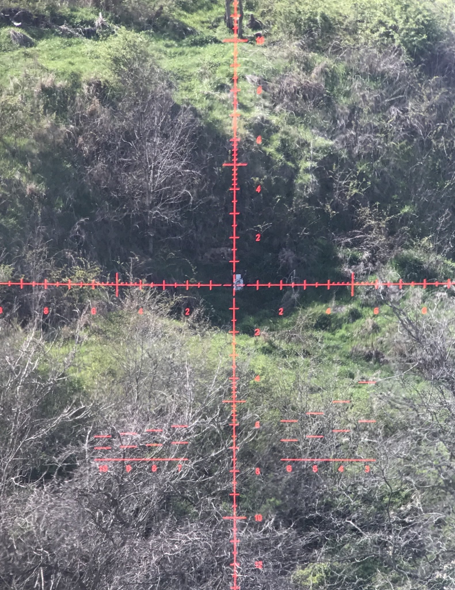

Here is a 2/3 IPSC with flapper at 820 yards, if I remember correctly, taken with an iPhone and a phone skope.

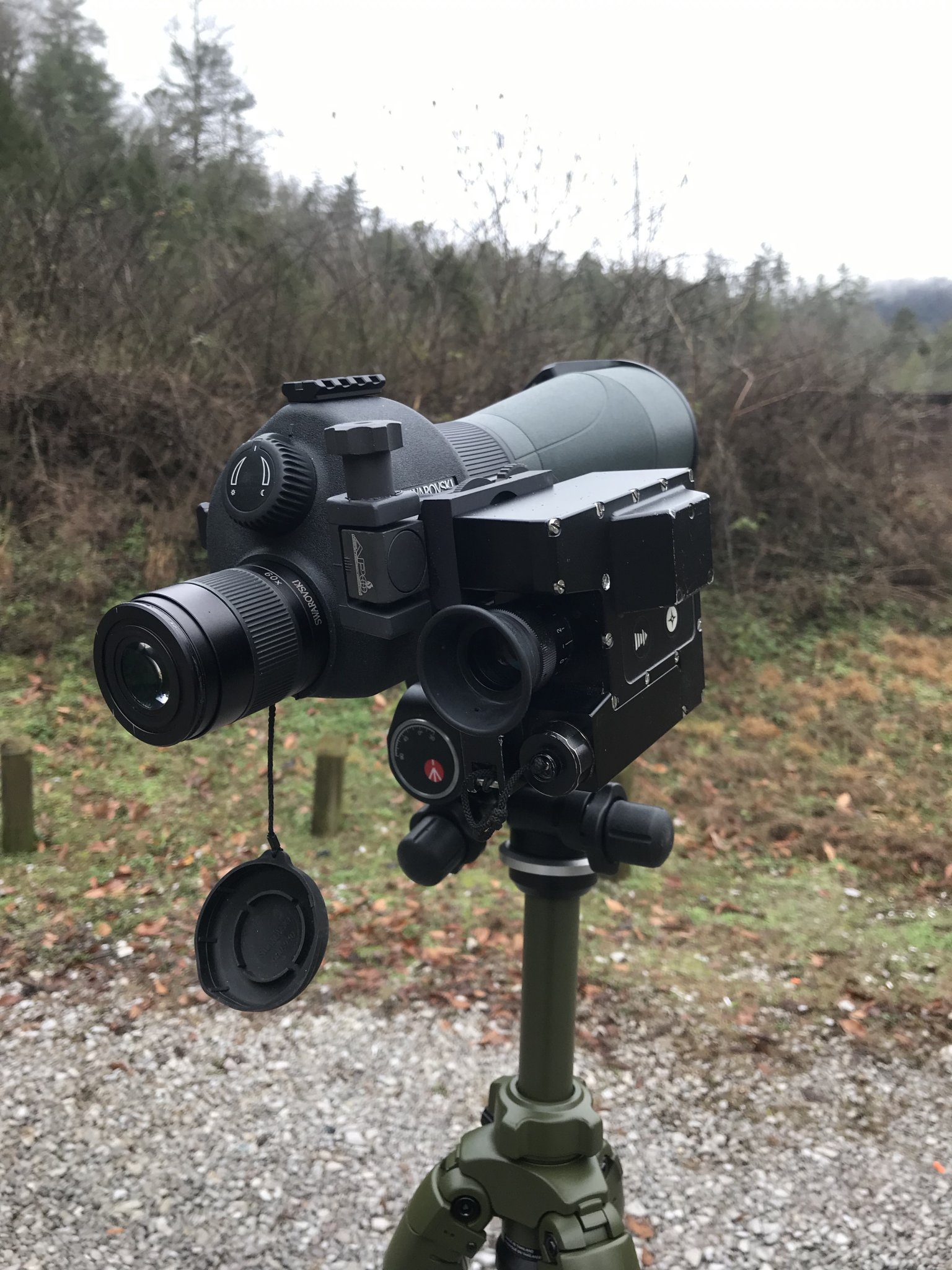

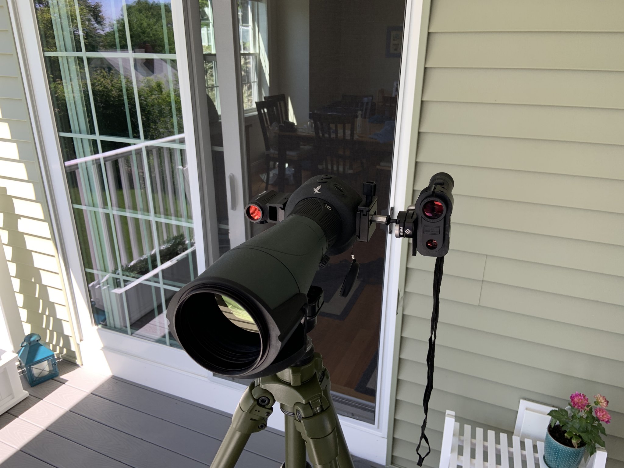

I picked one up a few weeks ago to replace a Bushnell tactical, so far very happy. The clarity is amazing and I actually find myself only using 20-30x on the zoom for steel as you can see impacts, trace etc. Then yesterday I used 60x to see very clearly .22 impacts on a steel coyote at 350 yards, could see the individual marks and count hits, see new ones vs some other scopes that just saw the steel move (not much, it’s a .22 ...).
Some down sides are the reticle does get in the way of spotting splash if I set it up right over the target, I either set it up off center or switch it on and off. Also the 20x minimum zoom can make it hard to find the targets, fixed with a red dot on the side.
Setup is standards rail on one side, I think it’s a 4 slot and M4 screws to attach to the scope vs the $200 Swarovski ones. Sig Romeo 5 cowitnesses to the scope and it’s so easy to look through right eye to align the scope on target via this then switch back to left to look through the scope. Arca plate on other side and MPA rat clamp I had, mounted to a RRS micro ball head and Arca plate on the side of the rangefinder mount to get it cowitnessed as well. Can remove range finder and mounts easily and putting back on it holds zero good enough.
Had do so some drilling etc to get the holes in the plates and put threads into the side of the rangefinder mount.
