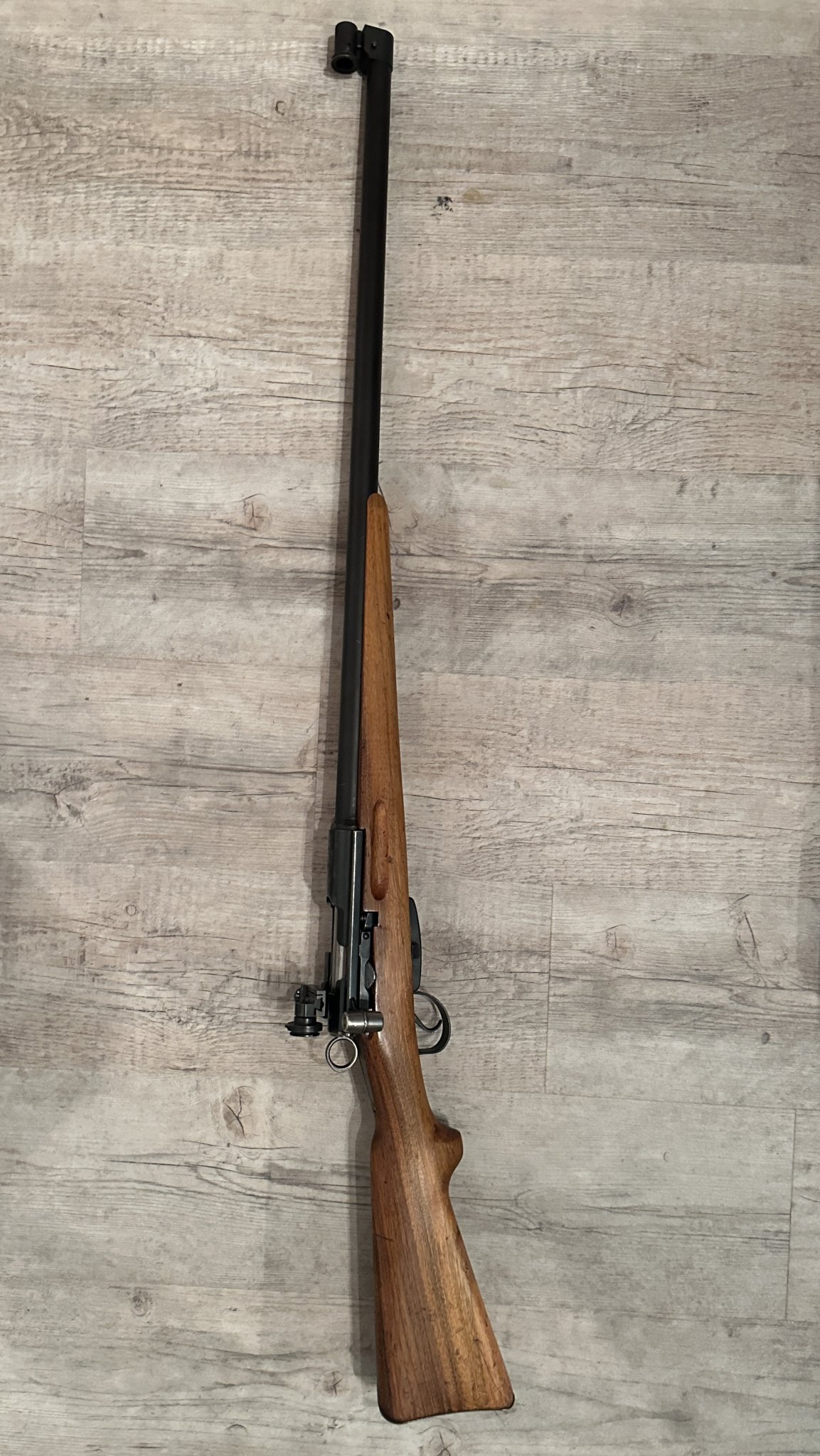

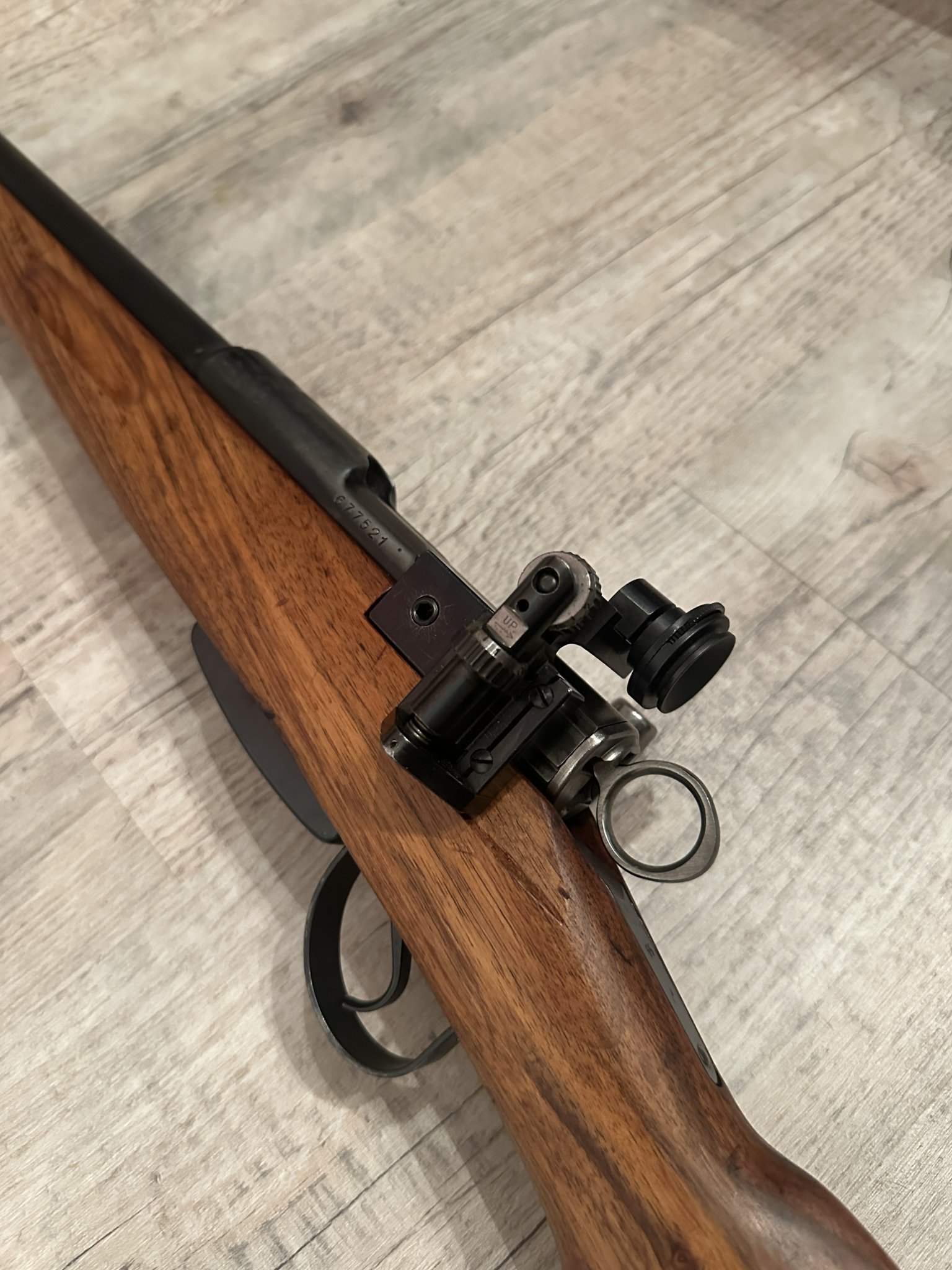

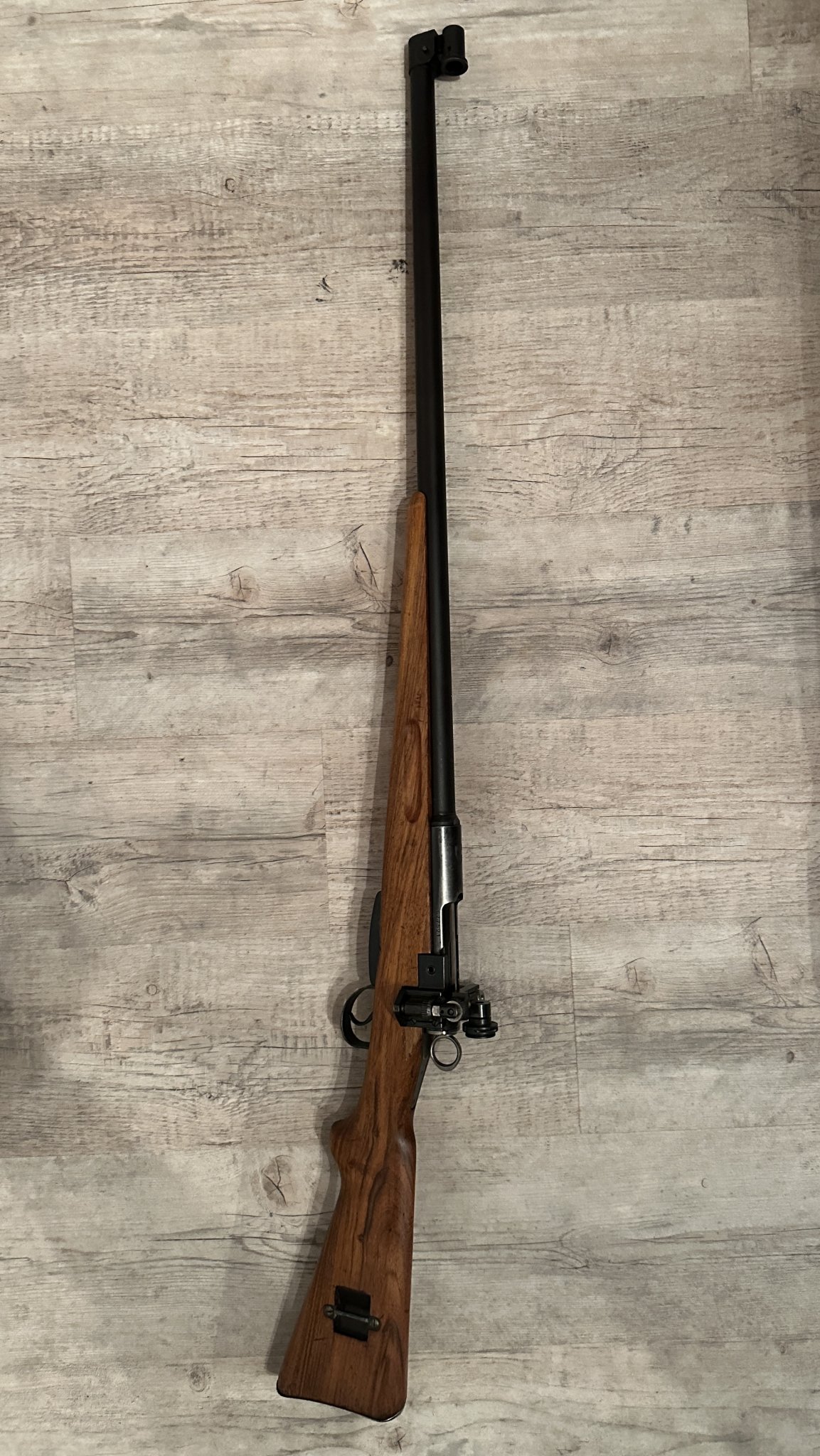

So I recently built a kinda sporterized K31 target rifle (don’t worry, i bought all parts separately, so no K31 where hurt). Last saturday I got to test it and shot a 0.5 MOA group at 300m. Now i kinda want to put a scope on it. The scope should be from the 30s to 60, maximum 1 inch in diameter, shouldn’t have an objective bell and a minimum of 3.5x magnification. I want to mount it with a custom mount to the 11mm rail (where the diopter is mounted now) on the left side of the receiver. Any recommendations?

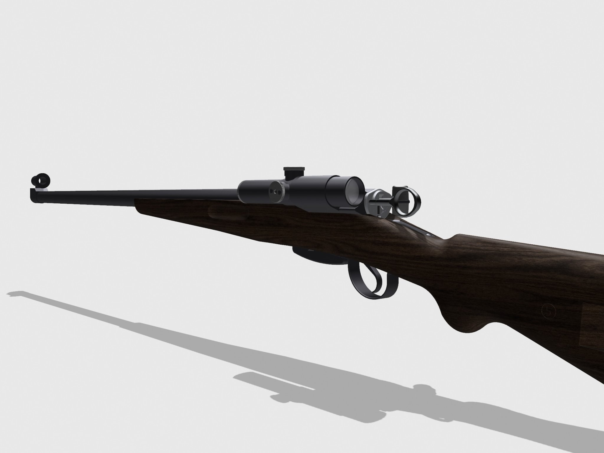

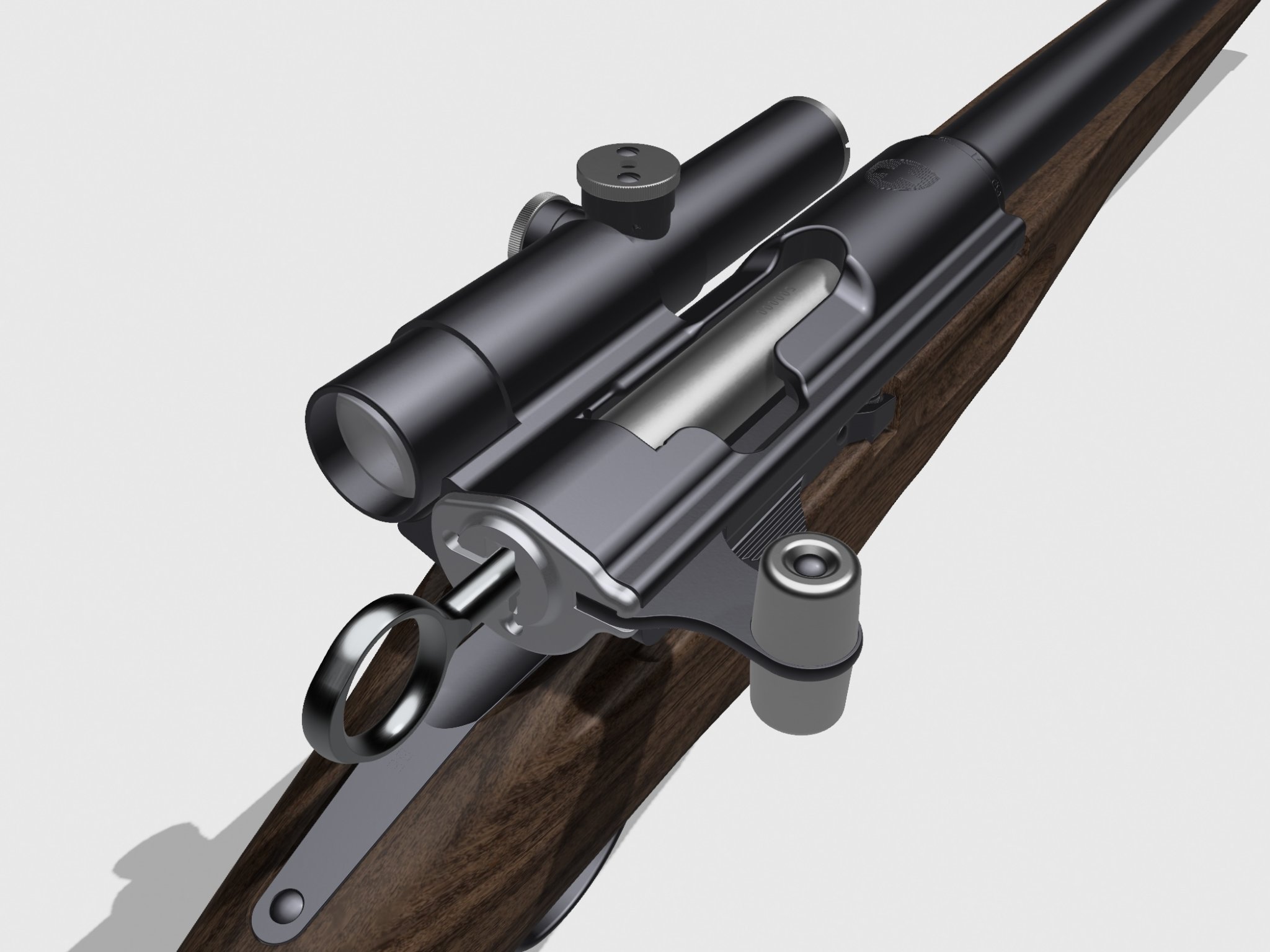

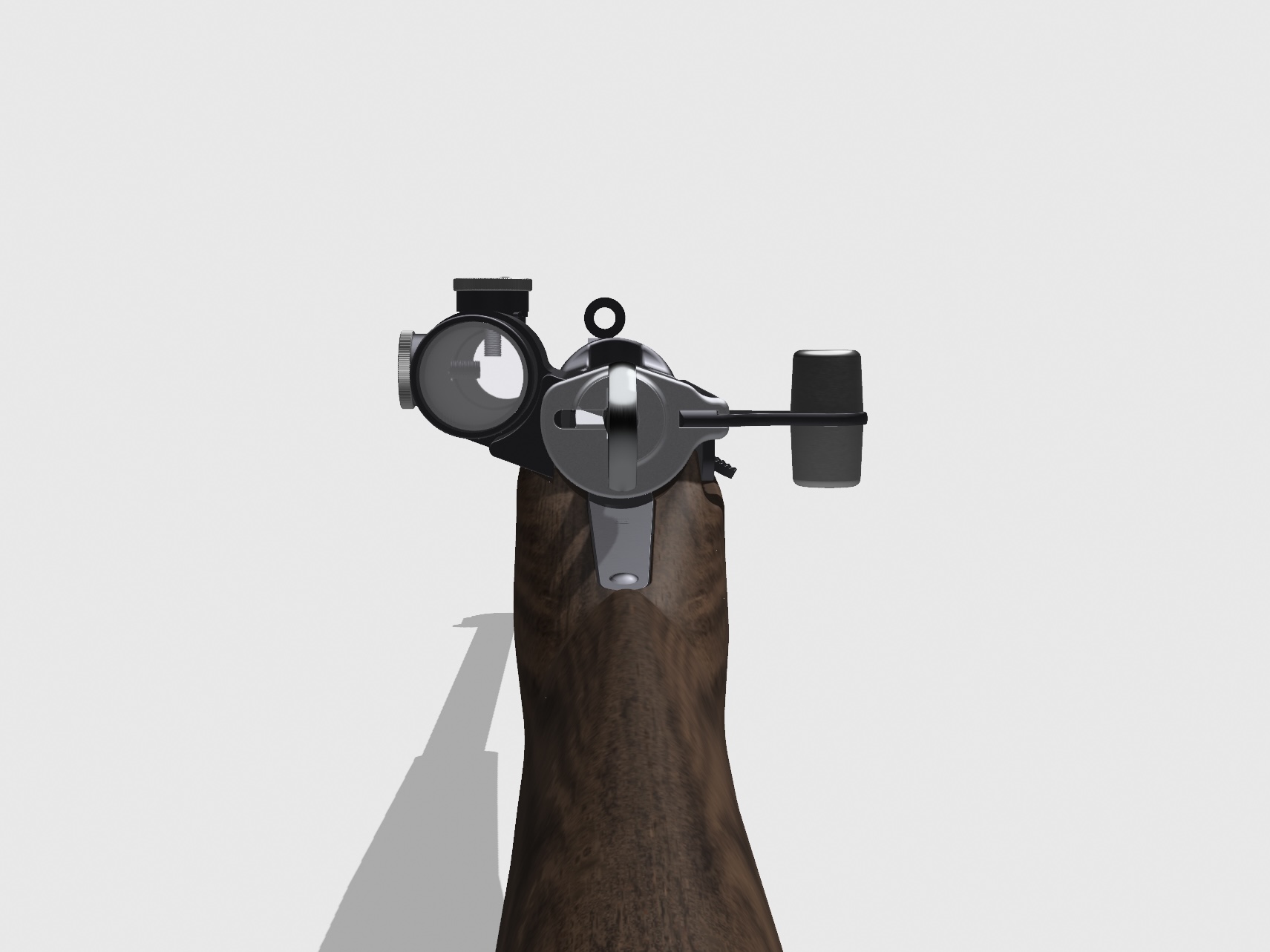

the mount isn’t really the problem, i have a CAD program and a friend with a CNC, so i could fit pretty much every scope. For example here with a soviet PU scope.

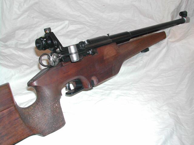

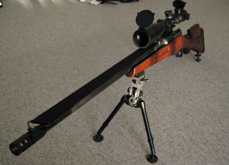

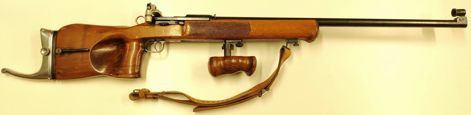

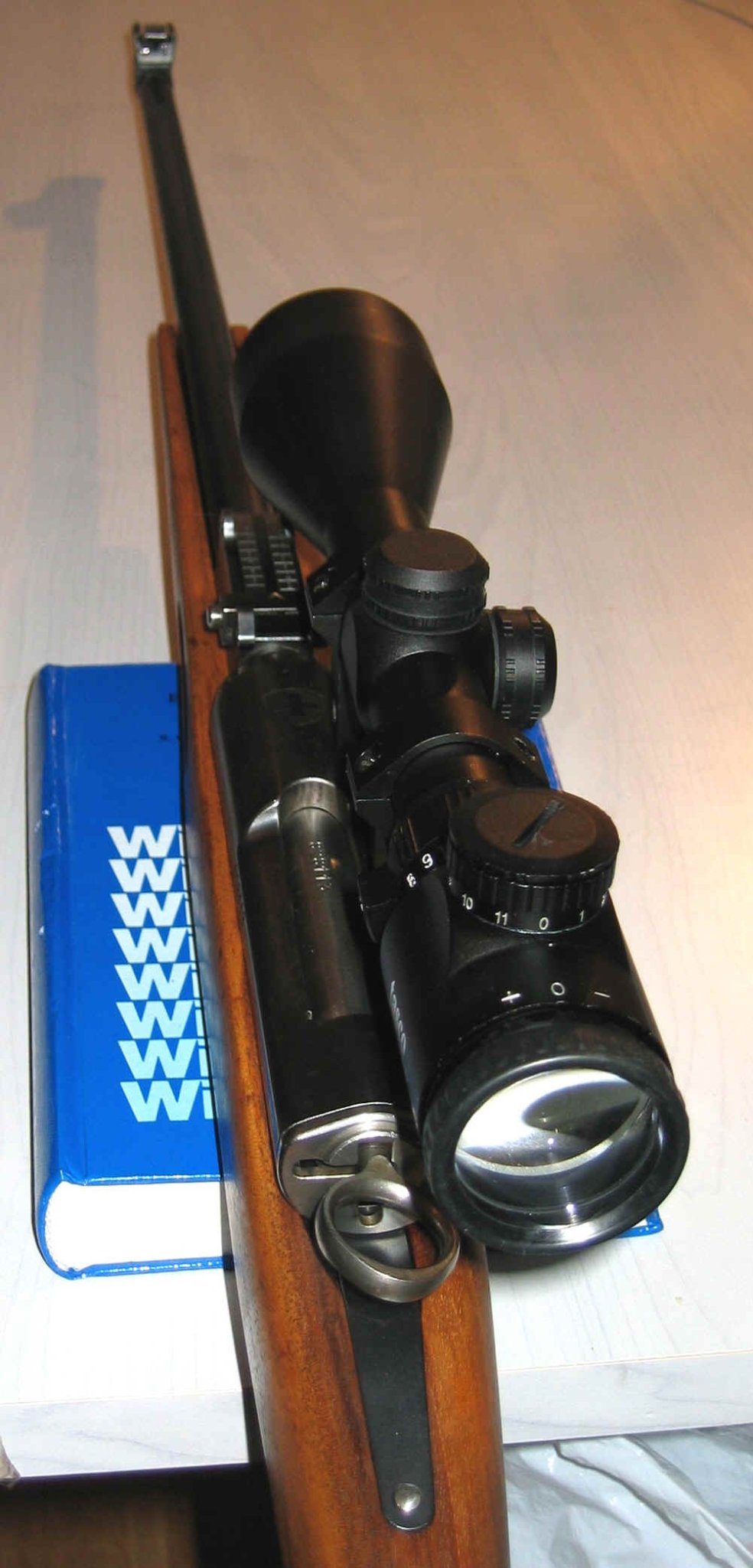

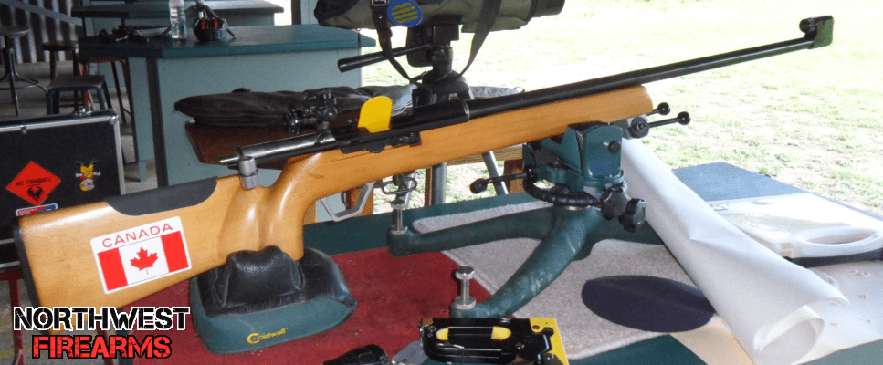

Beside the barrel-maker-question - and also the technical details - for example twist-rate ? :unsure: of this very special long barrel - What exactly are you trying to achieve ? It is always to recommend to know very early concretely what one is "aiming at". Several had already started with an idea for any remodeling/renovation and unfortunately couldn't finish it because they ... . An handful of different K31-conversions exist.
A scope with only 3.5x or 4x magnification, small tube diameter and a contemporary post reticle for example Absehen 1/Reticle 1 too, would allow hardly this unusually - but great looking :) - barrel to fully demonstrate its precision potential.
A scope with 6x magnification and an 42 mm-tube and a fine reticle as Absehen 6/Crosshair or 4 would be clearly better for maximum accuracy. Riflescopes with such a magnification are known from the time-period you mentioned in your first post.
Well the barrel was originally mounted on a newer model of Hämmerli Match-Feldstutzer. I had it remounted on a normal K31 receiver because the Stutzer had some Parts missing that where impossible to get. The barrel should have the standard 1:270mm twist (about 1:10.6 inches) and has a length of 29.5 inches. It is also free floated. With this set up and the diopter sight I get pretty good groups at 330 yards. The only thing missing is the scope to create somewhat of an alternative version of the swiss ZFK 55.

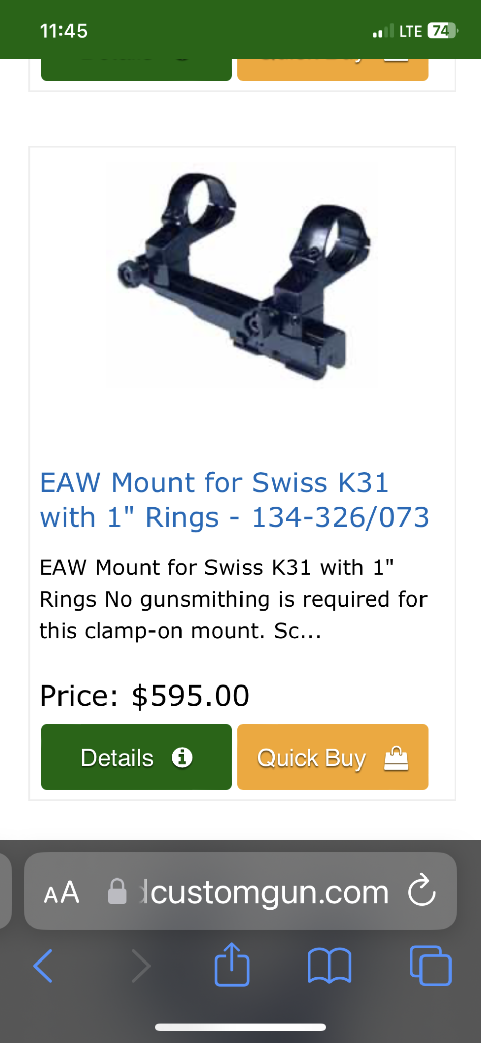

I think there even is a mount that you can screw to the side of the receiver, i was thinkering with this one because mine already has the 11mm rail cut into the receiver.
