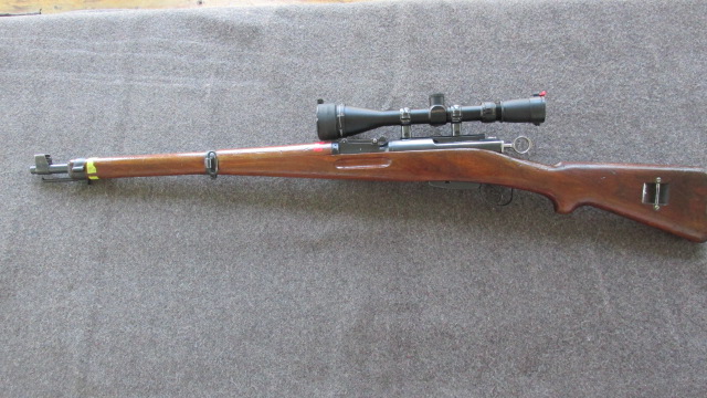

I've shot GP11 out to 1K many times. Being F class person, I would not call it super accurate.
However, it's pretty killer at 600 yards for surplus with irons.
I'm hoping with a good target scope I can get out to 800.
Figure a projectile that stays supersonic to 1k will have an easier time at 600/800 yards.
It's one reason I'm looking at the 169 grain smk, which is intended to increase tran sonic performance of .308 bullets.
Reactions: rhsc and kujuak
Also I have added about 3 lbs of weight to the K31(all reversible) and a compensator.
I'm hoping this cuts down on stresses to the 72 year old stock.
The scope is Frank approved...

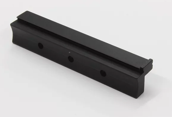

Swiss Products has long made a clamp-on Scope mount for the K31. The problem is that it mounts the scope to the right side of the bore axis. They have now alleviated that problem with an add-on that places the scope over the bore axis.
Looks good, thank you!
This said, judging by the photos, it should be coming with a ~50mm cheek riser in the kit.
Reactions: Calfed
Has anyone tried the Swissproducts sidemount rail for left side of the receiver?
This mount will place the scope in the same position as on a Garand Sniper.
With a Garand sniper cheekrest and this sidemount, and with a scope in low rings, I think this would be a very good compromise. No need to move head away from the stock to avoid the bolt hitting the head during reloading.

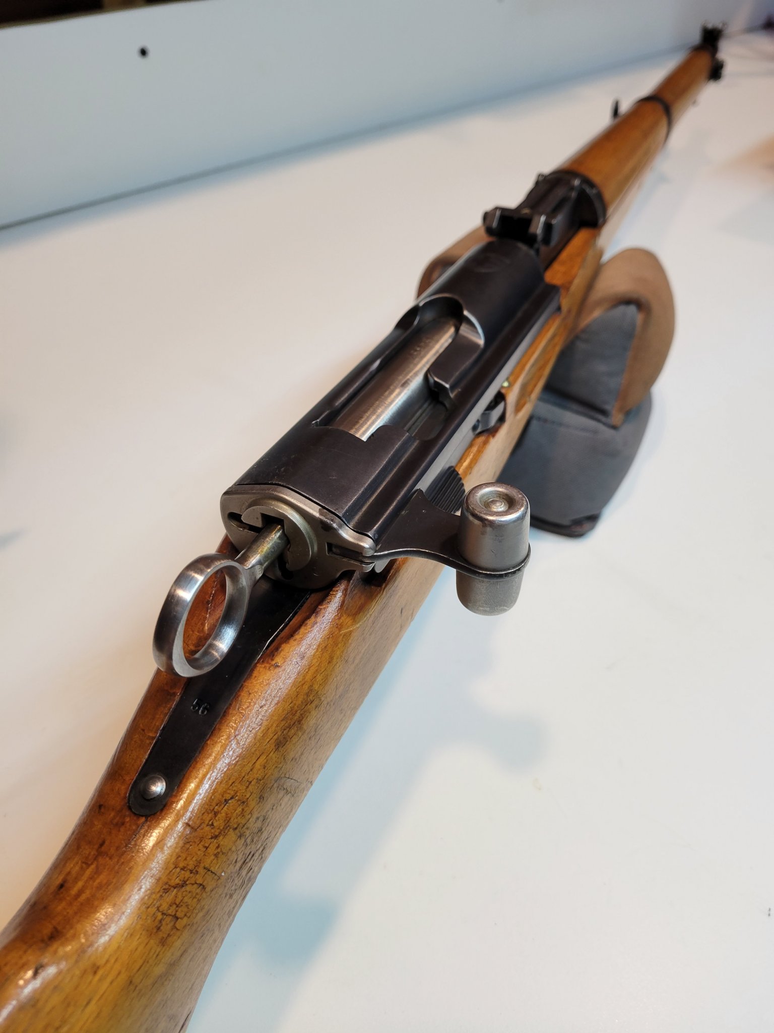

Davo, maybe I can clarify.
Haemmerli made a number of new k31 runs before they closed their doors forever sometime around 1999 to 2001. Can't remember for sure. OGS is with me more often than not these days. The serial number will be preceded by a "P", signifying Private, however........... It's often confused with the "P" stamped on service k31s that were offered to soldiers mustering out after service that opted to keep their rifles.
The easiest way to tell the difference is that the Haemmerli Private rifle "P"s are the same font, thickness and in perfect alignment with the serial number, all in one stamp. The mustering out "P" is almost never the same thickness or perfect alignment with the serial number and is obvious it was stamped after the fact.
I have what you describe as a mustering out P marking on my K31. How do they stamp the receiver if the receivers are so hard. Do they have to support the receiver with something replacing the bolt? Mine appears to have been someone's match rifle with the two tape markings one red the other yellow. I have never shot mine with service ammo. It has been my cast bullet match rifle and it shoots very well.

Good morning. Actually I spent a lot of time this morning reading through all of these posts, and I quite enjoyed it. It's far too much for me to comment on, but as for the left side drill and tap mount, I still have that on my old hunting K31. I developed that mount sometime in the early 80s to replace the cheap bent metal mounts that came on the G11 series imports from Golden State arms and Santa Fe arms. The 5 drilled holes in our mount will accommodate all three of the importers that converted the G11 series to .308 or those left in the original caliber but sporterized.
As for the stamping of the mustering out P, I am clueless, but the strike does seem to be a bit shallower than the serial number. The case hardening on the receiver is what it is, and how that was accomplished considering the hardness, is beyond me. I can tell you that Haemmerli used the same receivers that they obtained from Bern when the factory stopped production.
They put that same "P" in front of their serial numbers on the private, or commercial rifles they made during the 50s, designating them as a private run, and I believe it was right up into the 60s.
As I remember, they closed their doors in 1995.
Once again, great reading on this entire thread and, also once again, far too much for me to comment on, but I did enjoy it.

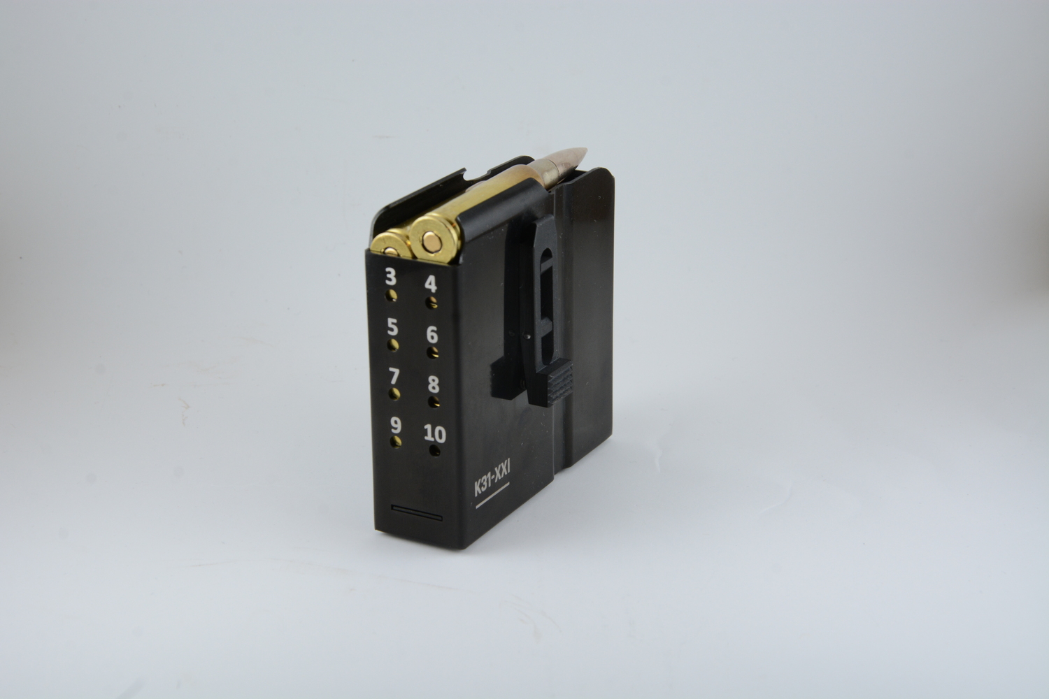

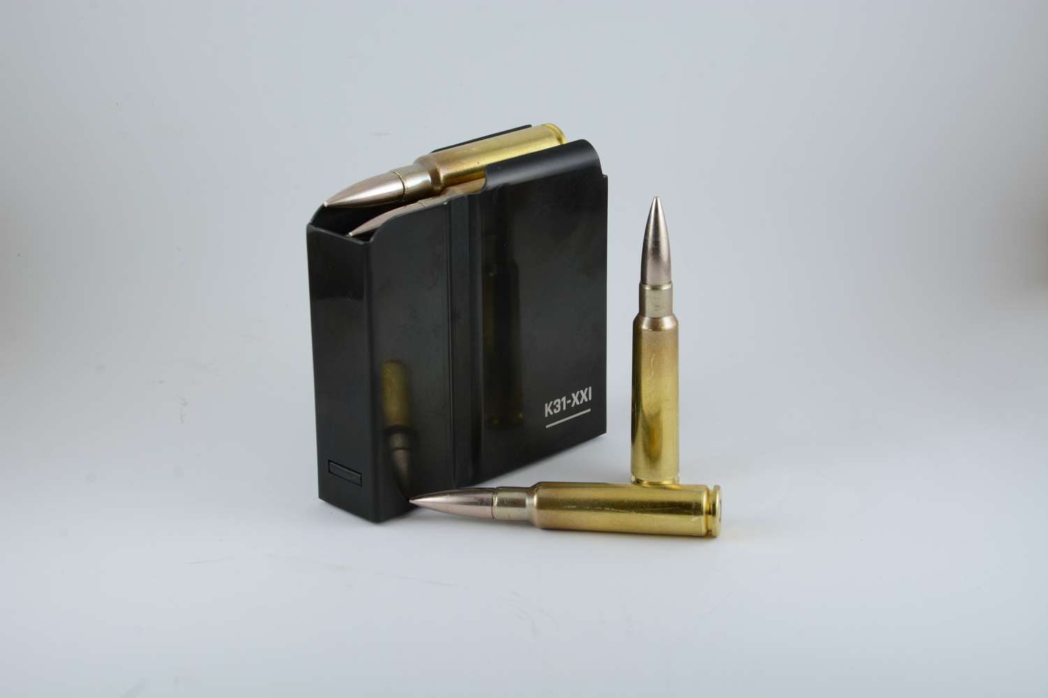

Any update on these magazines?
Coming soon. One of my suppliers has messed up critical dimensions on a part, so the whole batch needs to be redone, and that takes a few weeks.
Release to the Swiss market is scheduled for end-March / beg-April, immediately shippable to EU/Schengen countries.
Then I'll see about exporting to the US, maybe for the end of summer; in an officially neutral country, this might be a bit of an obstacle race, but apparently nothing's unsolvable.
